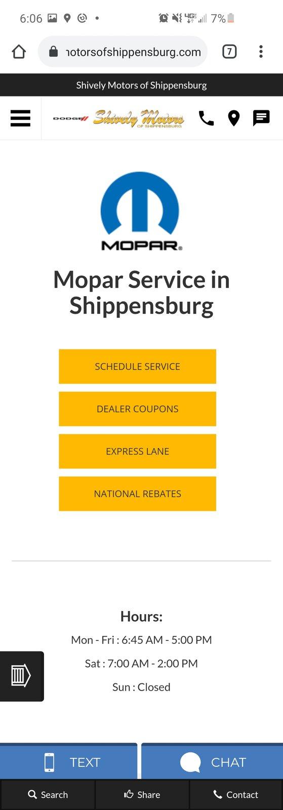

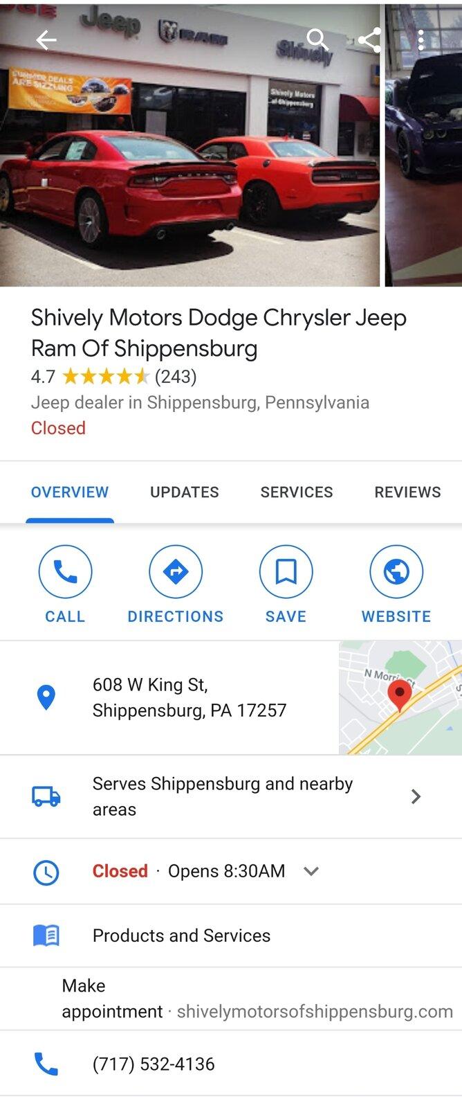

Looks like this local dealer has decent ratings.
Opens at 6:45AM on their service page.
(717) 850-0872
https://www.shivelymotorsofshippensburg.com/service-department/
