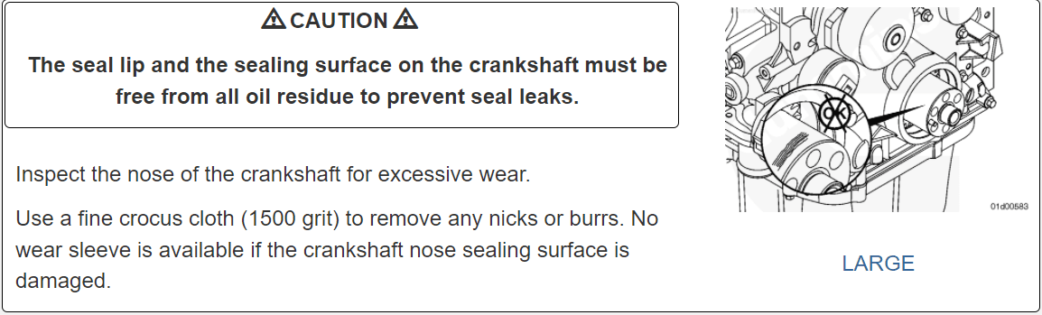

From the current QSB6.7 service manual.
The seal lip and the sealing surface on the crankshaft must be free from all oil residue to prevent seal leaks.
A bead of sealant is applied to the outside surface of the seal, but the sealing surface is still dry.
A beat of sealant is applied to the outside surface of the seal, but the sealing surface is still dry.

As John posted, from the Cummins S/M for one of our '22 buses.
