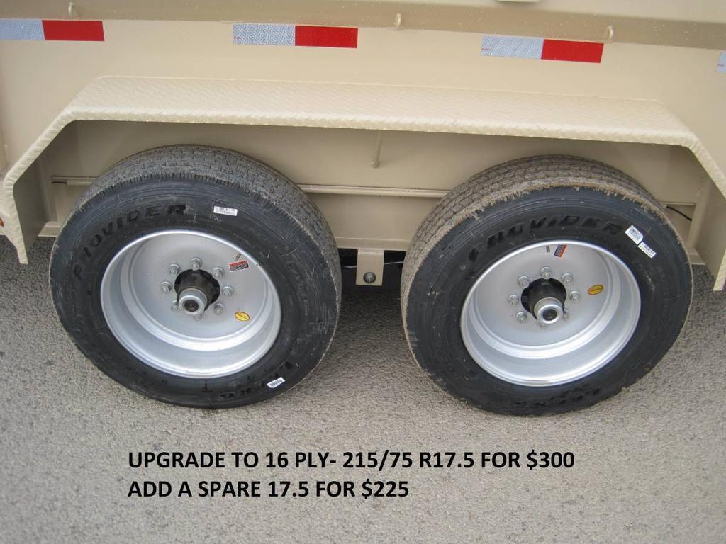

I don't know what you have for axles, but you might consider these. They are cheaper per pair (tire & wheel) than the G-614's will be for just the tire.
