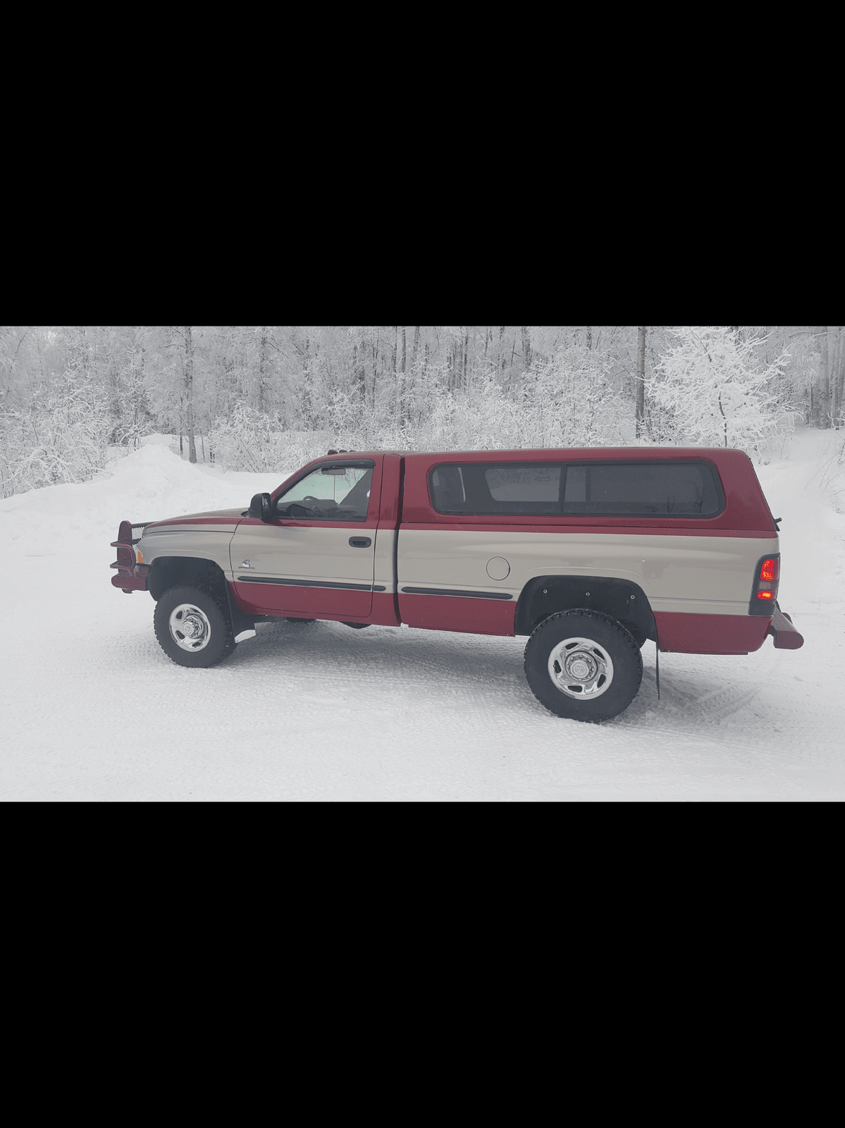

Is there any digital gauge options for 12 valves? I'd like a CTS3 but since my 1995 is obd1 that's not an option. I just don't like analog gauges that's why I'm looking for digital.
