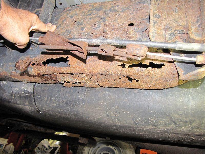

Where the fuel tank is up against the frame is another bad spot back by the rear axle
This is what happened to my 95 and I am fixing right now. I also had rot in the front where the frame dips down before it goes over the axle. My truck is originally from NY

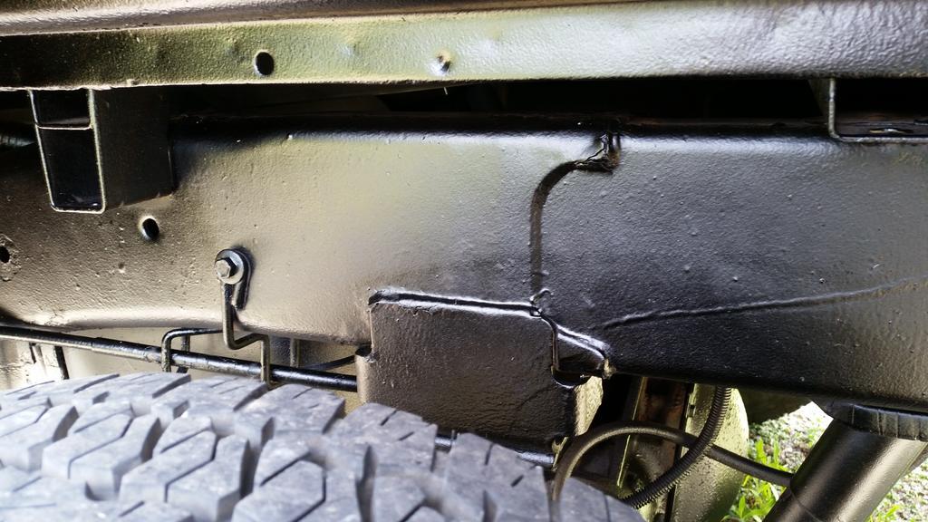

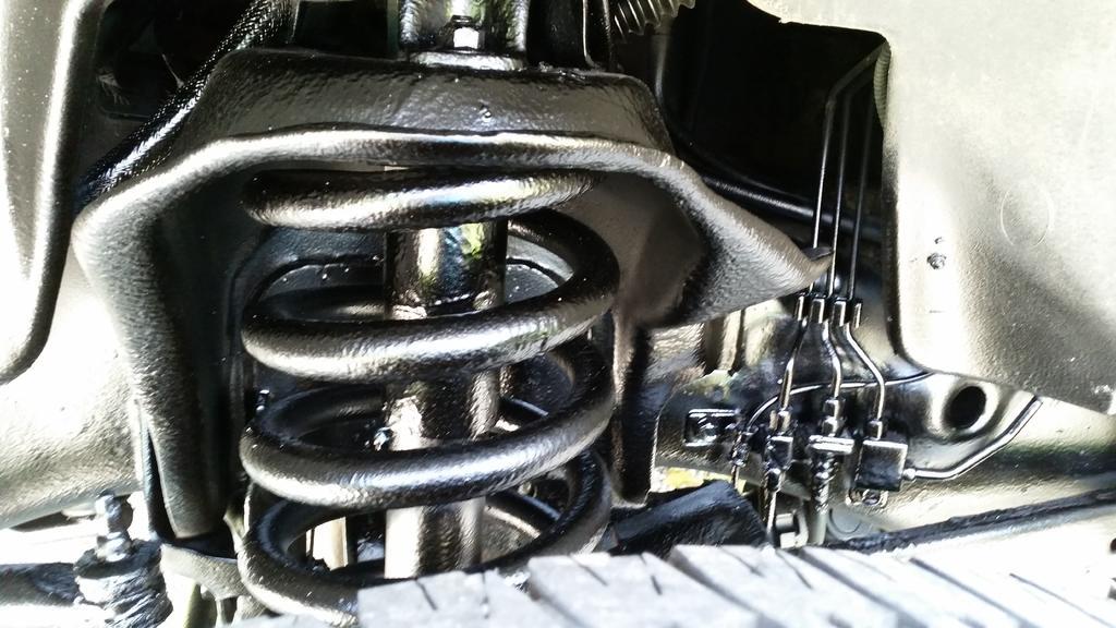

Here is the frame on my 11 year old 2007 that has spent every winter in the PA salt and that sits outside every day in my dirt/gravel driveway. It went to Ziebart the first day I owned it and has been back annually for an inspection and respray.

Where the fuel tank is up against the frame is another bad spot back by the rear axleView attachment 101521 This is what happened to my 95 and I am fixing right now. I also had rot in the front where the frame dips down before it goes over the axle. My truck is originally from NY
Now that's just nasty. I will look at mine. I hopefully will not spend much time in that environment but then I did not plan to be in Minot ND till December. That did not work out so well as the Daughter delivered the Grand Son early November.
Looks great as always especially considering the environment.
