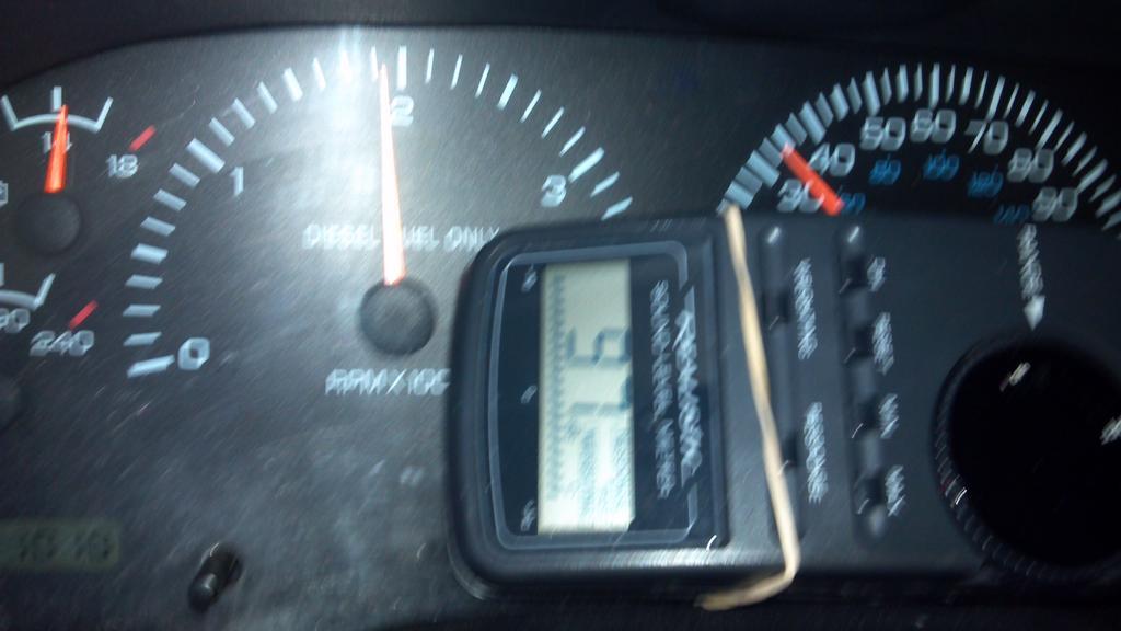

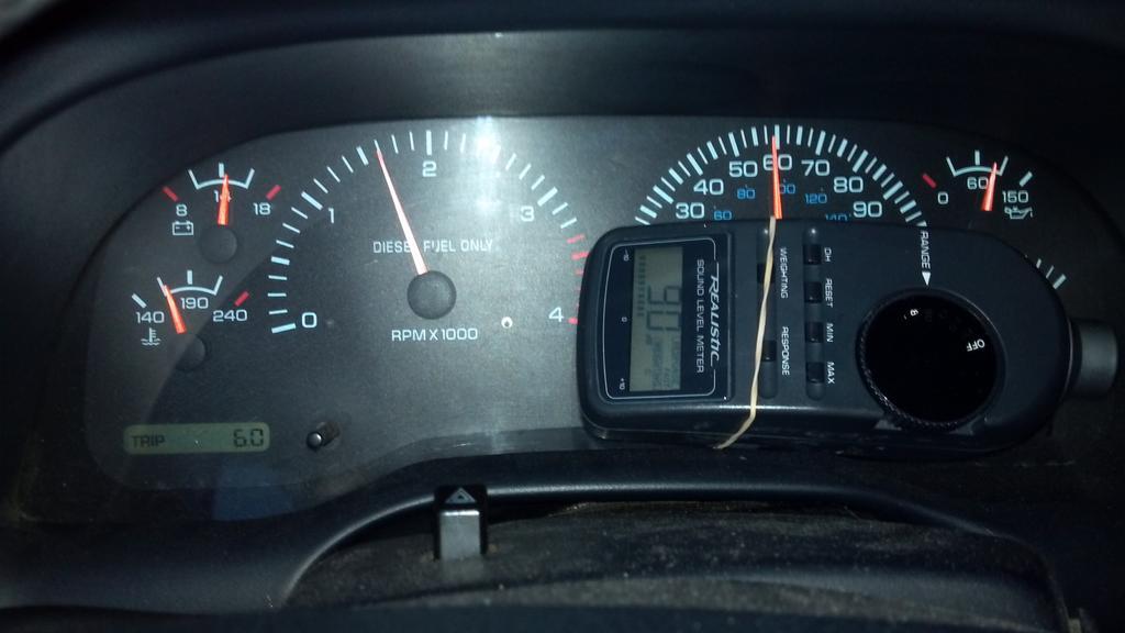

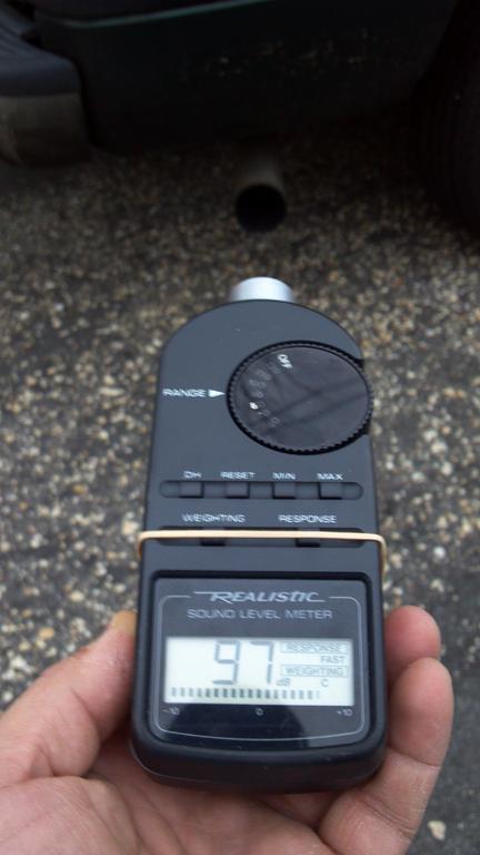

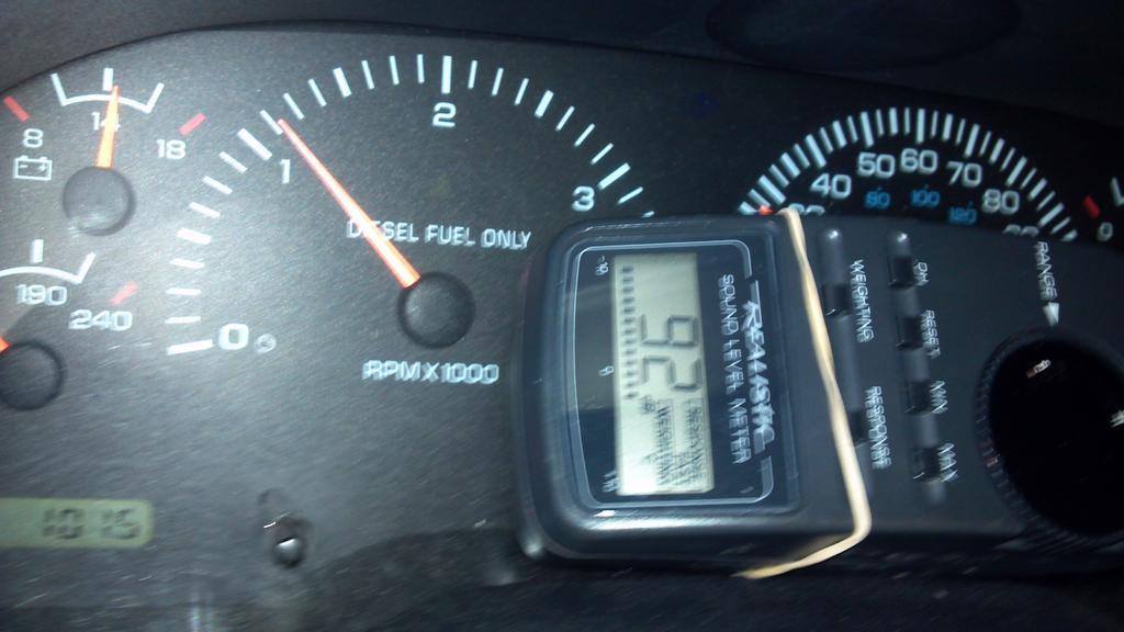

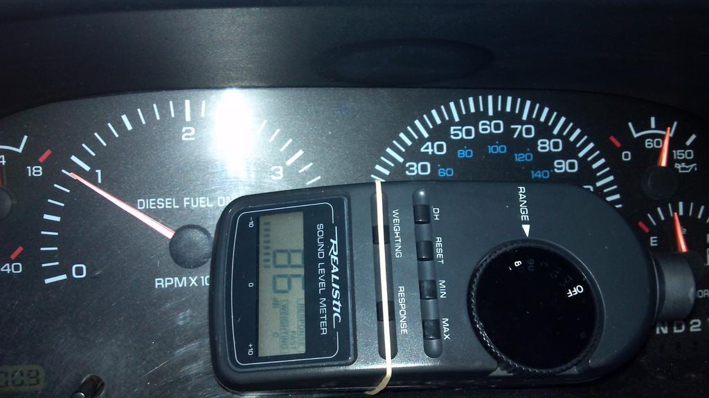

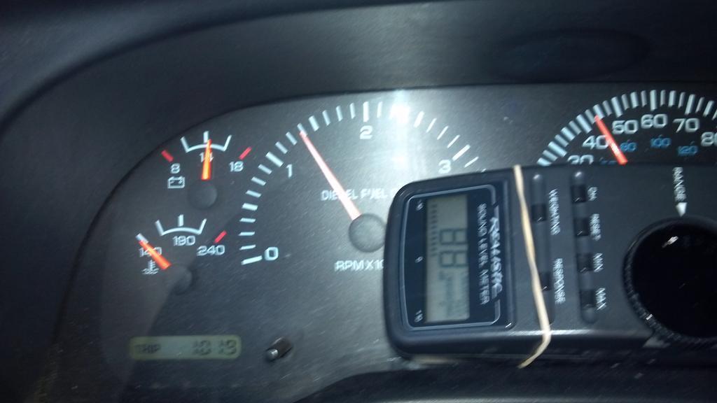

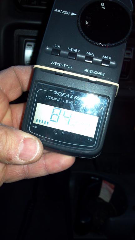

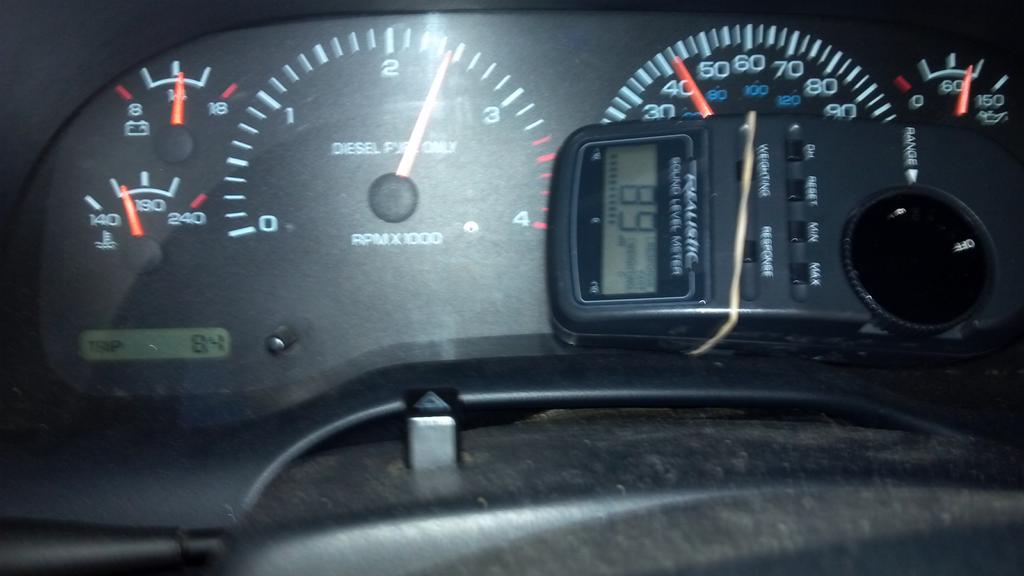

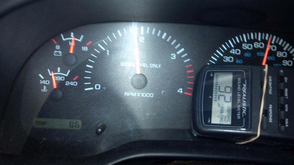

Straight pipe noise
These pictures were taken January 2013, if I remember correctly. The order is: Idle, in front of radiator....Idle, 3' from tailpipe, Idle, in cab, Idle, on gauge cover.
The next pictures are during the drive, as the engine came up to temprature. Truck was empty, not pulling a load and my foot was very lightly pressing on the LOUD pedal.
4" straight pipe, no muffler,no resonator.
This my friends, is loud, and the drone at highway speeds while pulling a trailer is quite loud. Someday, when it is warm, I have the time and I'm not feeling lazy, I will install a muffler.
EDIT-- It looks like the order is a little messed up, but you get the idea.

If there's anything I like to read in these threads.....its testing data. Nice work.
But that said, I have to question your process and your tools used in this test. No disrespect by any means either but Realistic products are adequate at best. Radio Shack isnt known for their top quality brand stuff, so accuracy in product capability will be at question.
But disregarding the quality of the reader and taking those numbers seriously, I cant but wonder if your testing procedure in the cab was correct. I'm understanding that you're not supposed to set a dB reader against anything as it causes excessive feedback noise which skews the readings. Case in point, the picture of you holding the reader is the lowest in the cab.
Also, reassuring as its well known amongst the diesel community, the ISB 2nd gen 24 valve engines are just plain LOUD. Clearly pointed out as your dB readings taken from in front of the radiator with the hood closed, the dB was 92. But.....when checking the levels at the tailpipe (with the tailpipe pointing directly AT the reader, no less) the levels were only 5dB higher. And this is on a straight pipe 4" exhaust truck. That right there is proof beyond all reasonable doubt that the engine rattle is the largest noise producing component on these trucks. I would wager a bet that if you opened the hood and pointed the reader at the engine, the dB readings would dwarf what comes from the tailpipe.
Hey.....in saying all this, I'm not trying to sway anyone to cut off their muffler. Thats not the point I'm trying to make. But for anyone to try and prove that they're somehow going to transform the 2nd gen trucks into these quiet little church mice by adding a muffler is far from reality. They're just obnoxiously loud by design and if I understand your signature.....you seem to like it that way.

I agree that the engine is the real noise maker on these trucks. I'm sure testing could be done in a different mannor, but I used what I had as I could safely use it. The rubberband kept the meter from rattling around, and I had to set it somewhere because it took one hand to steer and one hand to photograph. Putting the meter on the center console would have taken my eyes off the road for too long for my comfort.
Than being said, the pictures make a point. These trucks are loud. Mine is louder than most. The average driver has no idea how "loud" is loud. But they can look up OSHA's allowed dB levels of sonic safety and understand that if 85dB is safe for 8 hours and 95dB is safe for 30 minutes, they might not want to modify their stock exhaust as the drone from removing the muffler, creates excessive noise at a speed that I can't take a tail pipe measurement.
For me, I have spent decades in motorcycling racing, rock and roll bands, running loud equipment and things like that. I understand how "loud" loud is.
In closing, I do like almost all things that make noise and go fast. I just wanted to put some sound measurements into a discussion that didn't have anything more concrete than people saying how loud it seems to them.
PS. I own a KTM too!
