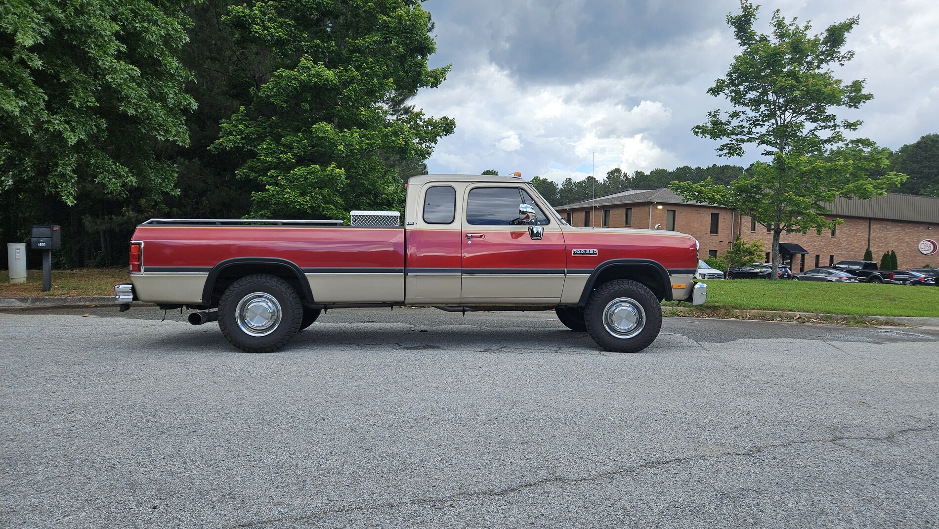

I just got the FarFromStock 2" leveling kit put on, and now my truck sits up really nice, almost like a stock 4x4 truck. Need some bigger tires!
I know the back is sagging, our wonderful postal service lost my blocks. Been missing for 3 weeks, and the shipper can finally file a claim today, but it still looks great. I had the 7226s springs before, and this sits up way higher than those did.
Anyway, now the stock tires look a bit ridiculous, and sit way too far inboard, so I'm gonna get a set of 17" wheels and some 33s. Has anybody had any luck getting the speedometer to read correctly with taller tires on a 2wd? I know that the D series used a different setup than the W, something is missing, a gear ratio reducer or something, so I'm not sure what to get to fix it for the taller tires.
