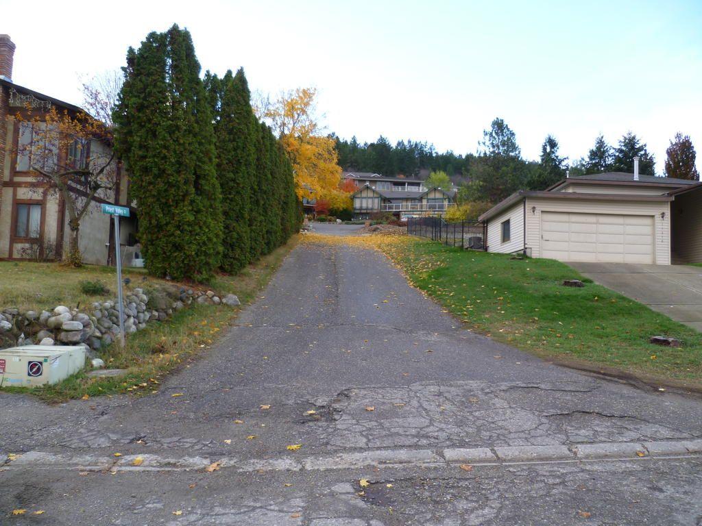

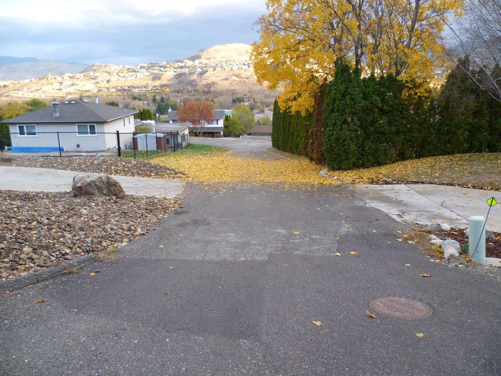

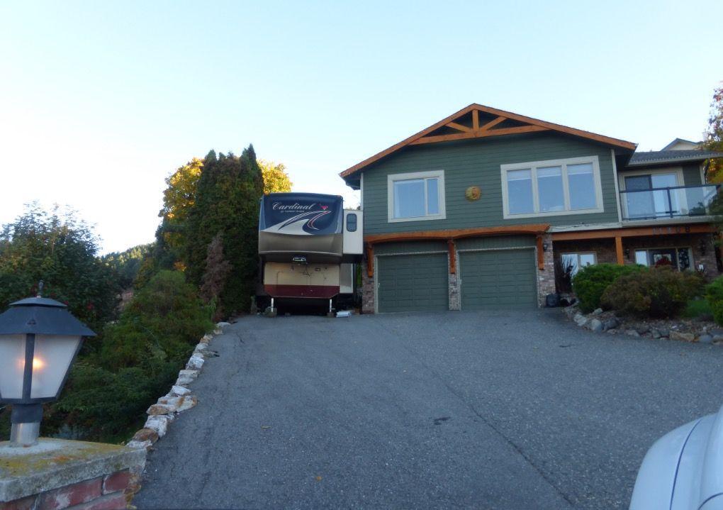

I have to back my 15-1/2K 5th wheel up this road and up into the lot beside my house. I use 4 low but it backs that much weight up effortlessly. If you look the garage on the right in the first photo, you get an idea of the grade. I'm at the top of that road. Once it gets into my property and driveway the grade gets a lot steeper. Pretty impressed with the power and torque these trucks have!
