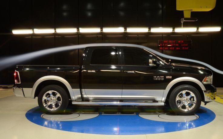

The gearing in transmission negates the difference unless towing, just normal driving even with 3:55 gears my truck never uses 1st gear unless I select the gear. With a lot more torque at 1000 rpm then a big Hemi, moving this 6200lb truck is no strain with 3:55 gears and at 70mph on flat highways rev's are about 1800 IIRC and 30/32mpg is the norm...I also have a bed cover that removes the airbrake effect of tailgate.
The mfgs of modern trucks design the body to be as aerodynamically efficient as possible with the bed uncovered and the tailgate up. If you look at the top sill of the tailgate it looks like a spoiler, which it is. The bed covers don't hurt anything, but they don't really help with the aero effieciency much. Total aero drag is cd x frontal area, so that's where the vast majority of the aero load comes from, and while separating the airflow from the body is important as well, the body is designed to do that with the bed uncovered and the tailgate up.
And you're getting a hand calculated 30-32mpg? Congrats.
I was wondering about that, because I just noticed the lip today and besides with 5'.5" bed the cover wouldn't make much difference anyway even without excellent aerodynamically designed truck.
