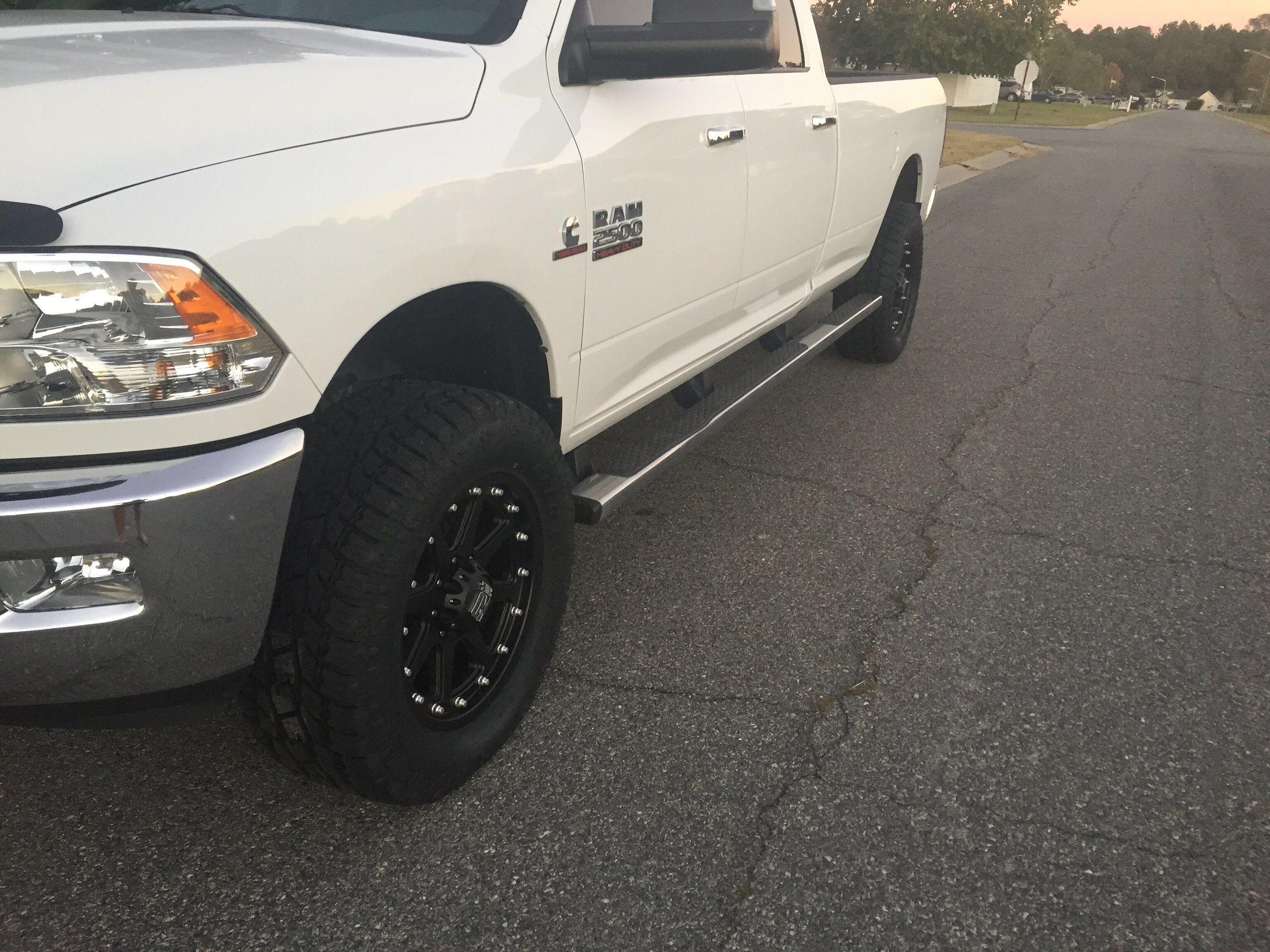

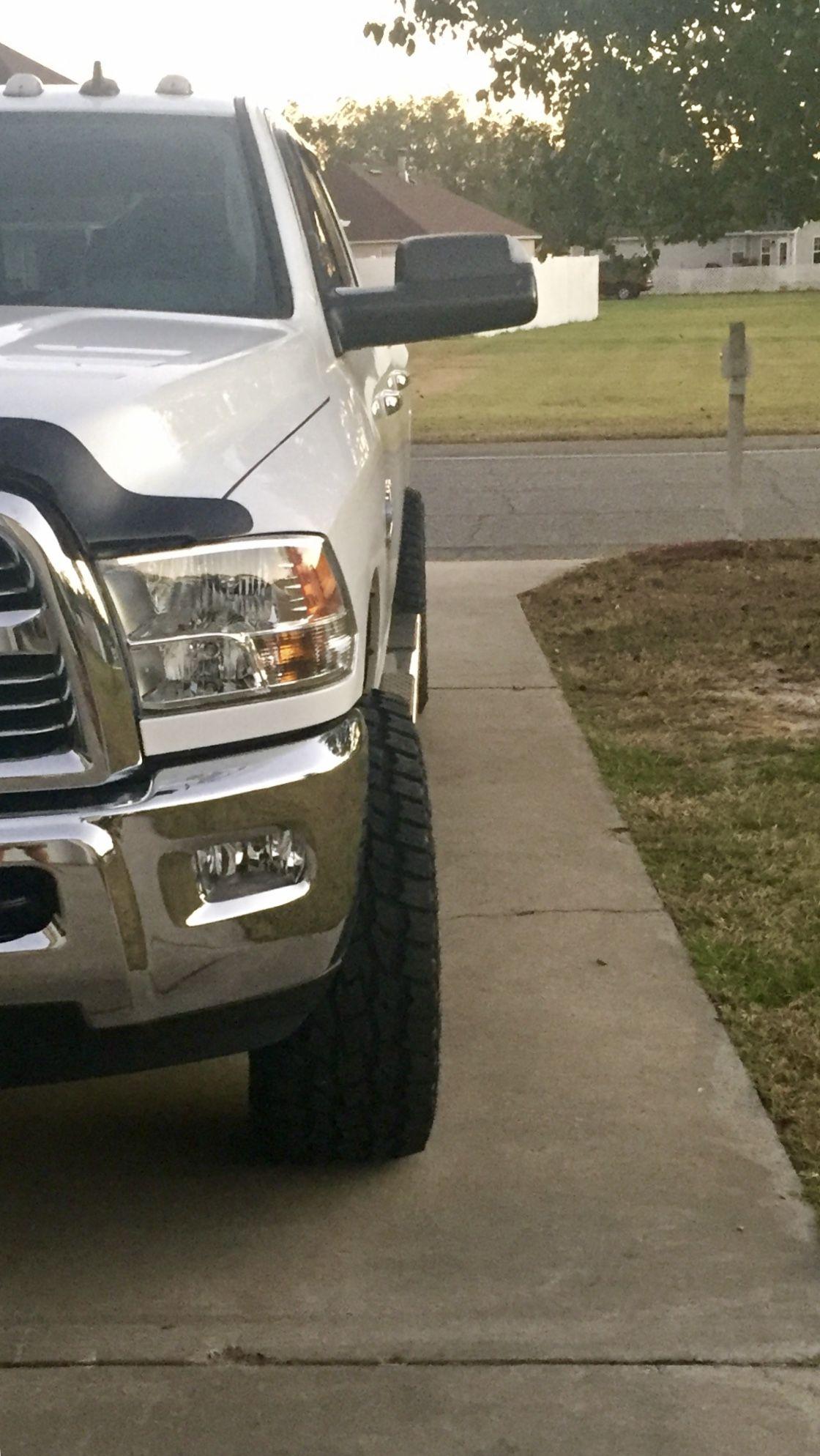

I have 35”s on my 2013 Ram 2500. I HAD to put a leveling kit on my truck and I still have some slight rubbing after a while some of the plastic inner fender well rubbed away and it stopped. I have XD Addicts 20x10 with 12x35x20 Toyo AT2’s.

Here’s a pic of my truck.
