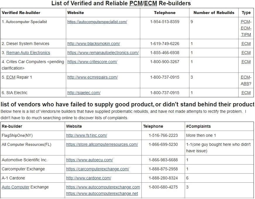

Here's the only list I know of. I ALMOST got screwed by FlagShip1, then got excellent service from Auto Computer Specialists.

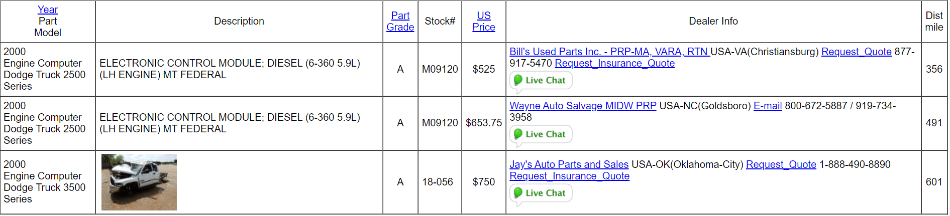

A search at car-part.com yielded three in the US. I searched 2000 model to avoid the mid-year change in '01 you mentioned.
