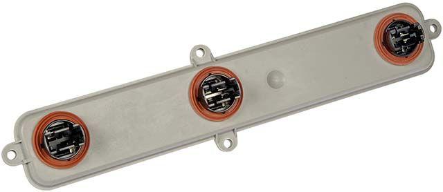

Just something that I found odd. Had a Brake light go out replaced it with another 3057 Bulb and it worked for sometime. Then I would go over a rough patch of road and the LAMP OUT indicator on the dash would come on NO TAILLIGHT then it went to on and off mostly OFF.
Everything looked normal when I took it apart. I ordered a New 3 bulb socket (Dorman) from some Amazon Place. Its been installed now for a couple of weeks with no reoccurrence of the problem.
