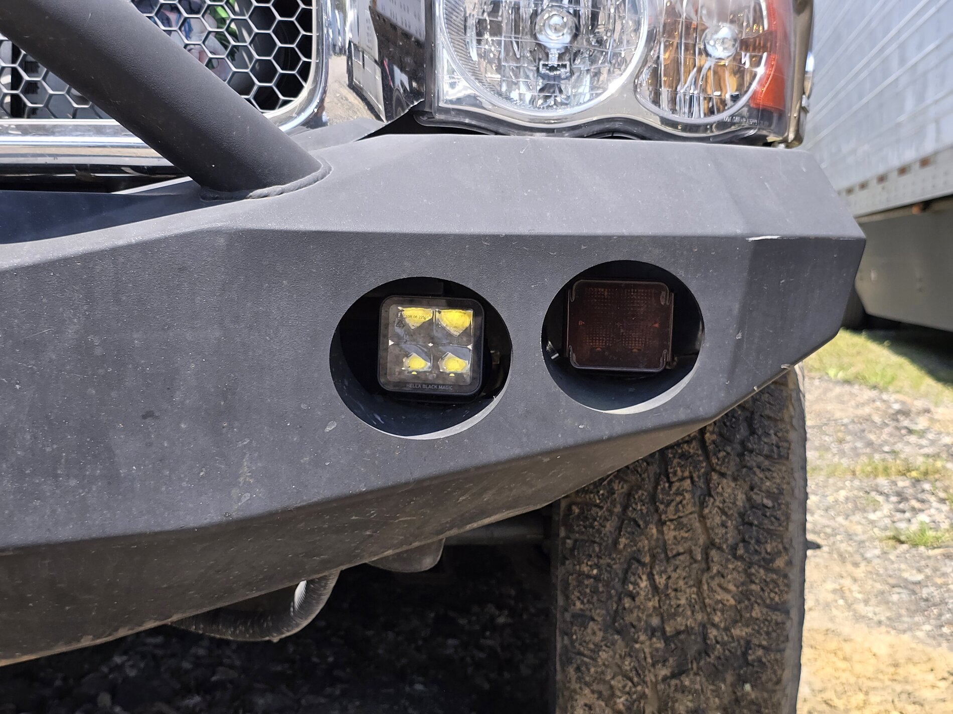

Plenty of better options out there, im using a Hella black magic set that I wired up to the OEM switch. Great light output. I'll post a picture of my setup later.

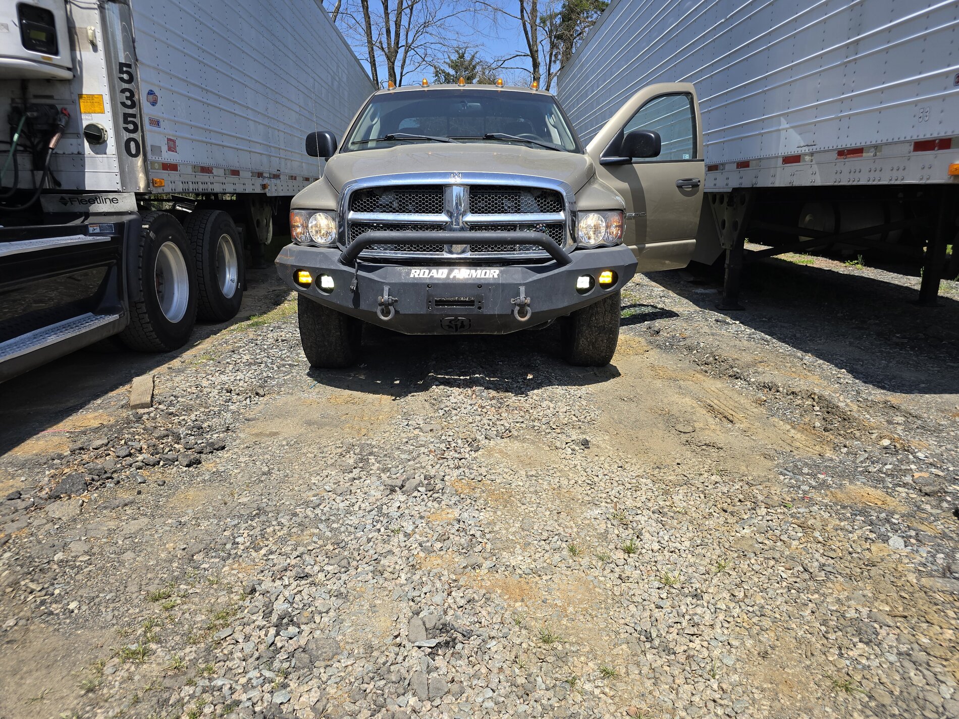

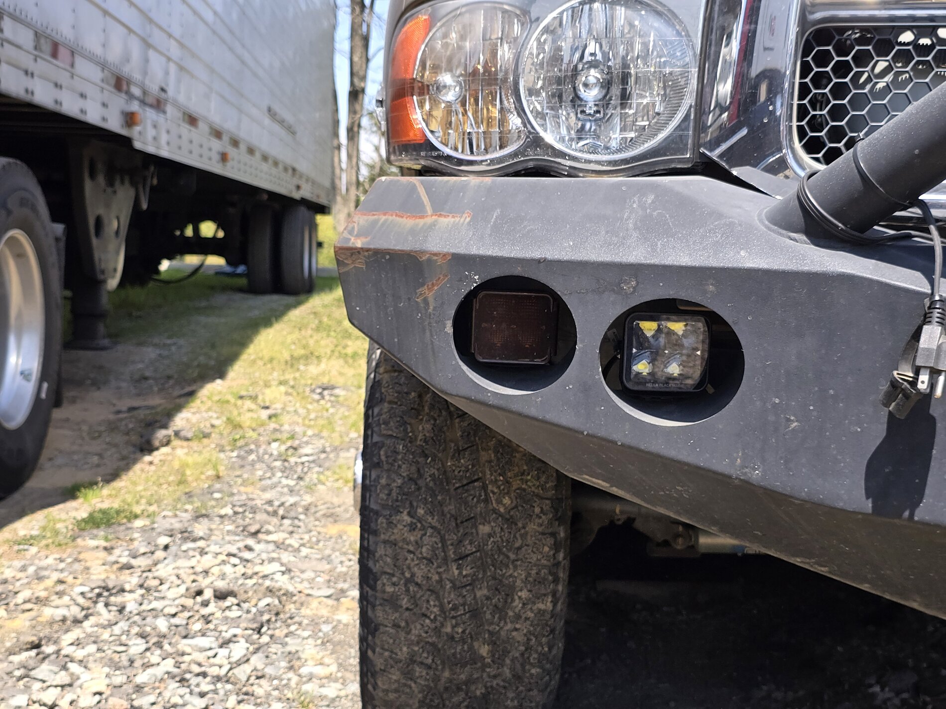

Pics of my setup below, and here is a link to a write up post I did asking for some help about the wiring and Install. Everything still works as it should. If need be I can walk you through wiring to the OE harness since its still fresh on my mind and I can get pictures of how I did it.
