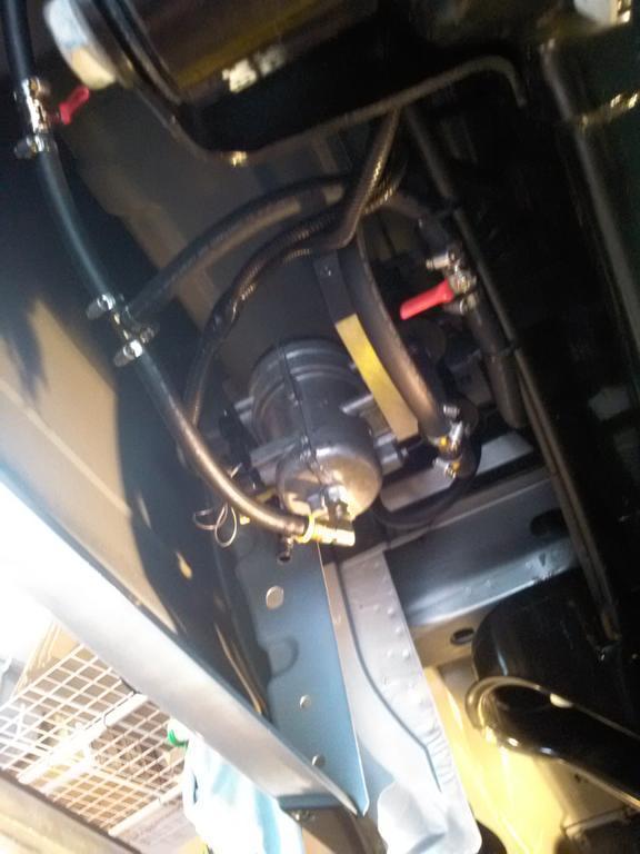

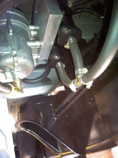

Here some pictures... This 2013 has 3 lift pumps ,and 2 auxiliary bypass filtering systems, I take My lift and filtering extremely serious.
