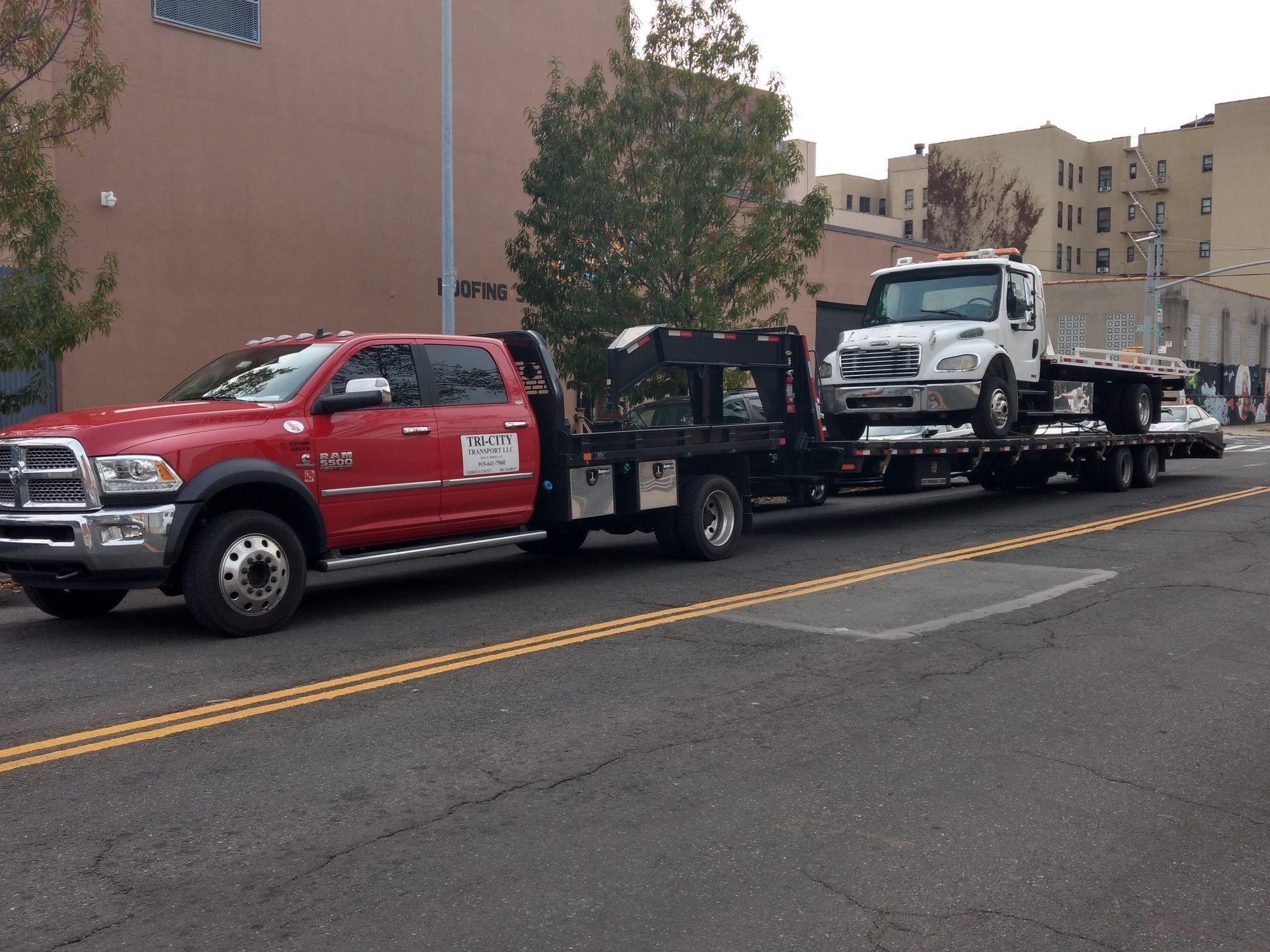

It's been a while since I checked in here on this forum, but I wanted to see if anyone else is having this issue..I have a 2018 5500 Larimie that I pull my flat bed trailer and car hauler with. I special ordered this truck with the 4:44 rear ratio (hoping it would improve with pulling power)..Foot note: my 2016 Ram 3500 runs circles around this truck..anyway, when I'm loaded and go around corners the rear end sounds like it's coming all apart...Ram continues to say this is normal however my 2016 4:10 ratio did the same thing until I upgraded it to the Eaton True Track rear assy and that all but eliminated any noise on launch..why hasn't Ram solved this issue yet???
