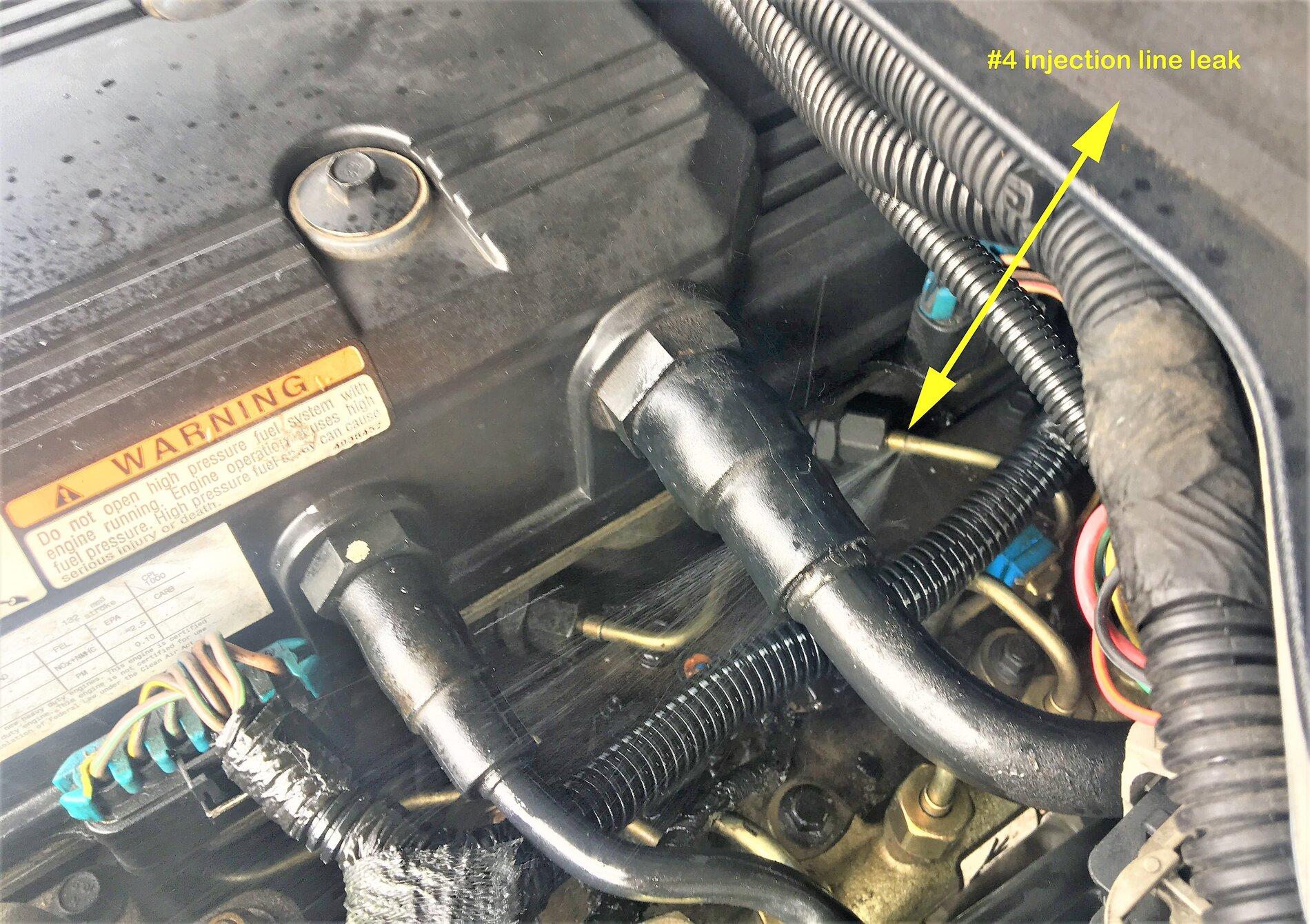

Is #4 the fuel line that has a habit of splitting? I see there is an all-new and improved much much better than new line available but what about the rest of them? I've never had an issue with any others so if it's not broke don't fix it?

The leak...

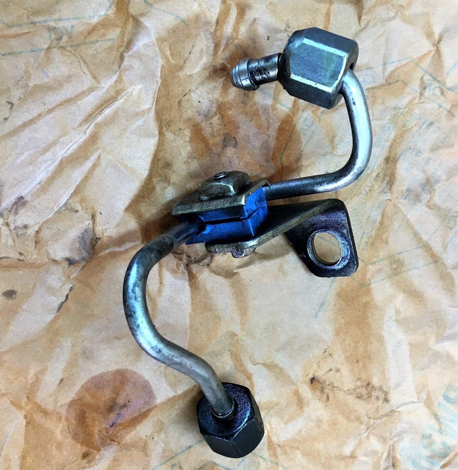

Old line...

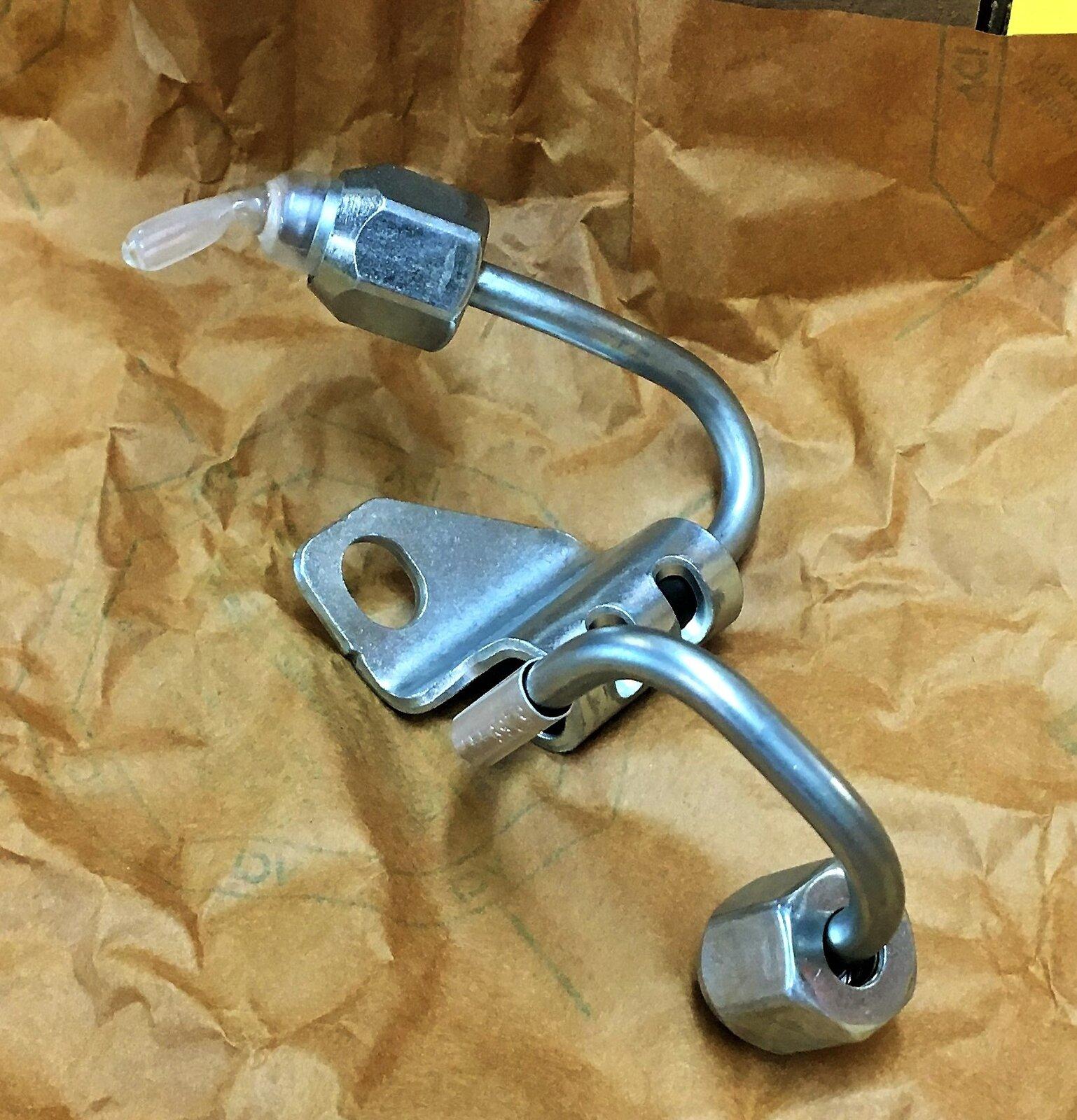

New line...
