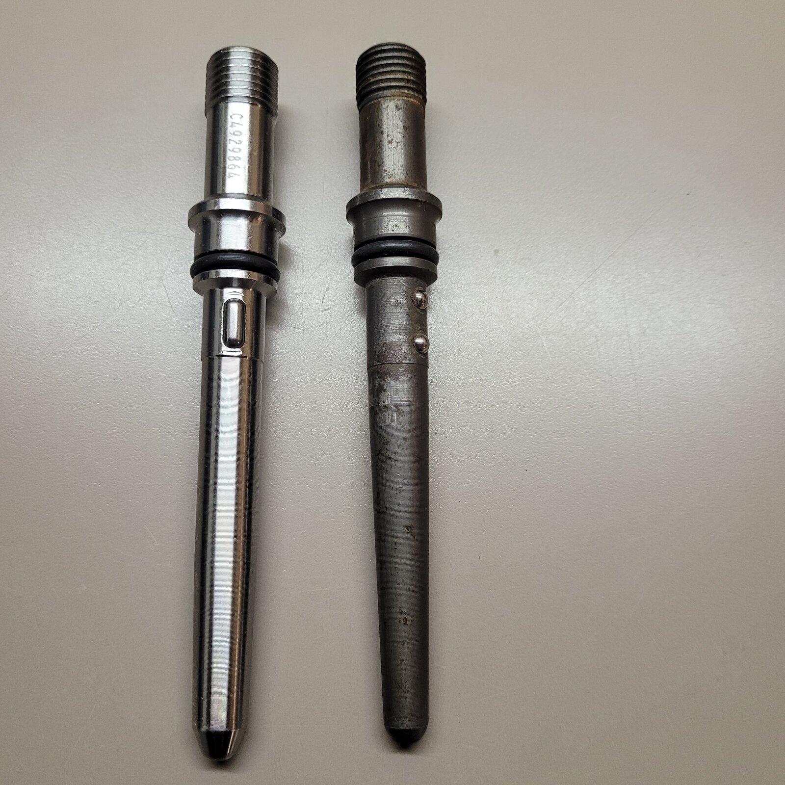

Ordered a new injector tube. It wasn't even close to being the same as my old ones. Went through my stock of old parts and found my original tubes I'd pulled when I installed the new injectors. I took an o-ring off one and replaced the leaking one. No more leak.
The new one is on the left, the one on the right is one I replaced when I put in new injectors about 5 years ago. The new one is. 040 longer
If you look at the distance from the seat to the tip they appear the same, and the extra length is on the connection side.
They are the same from the seat to the tip.

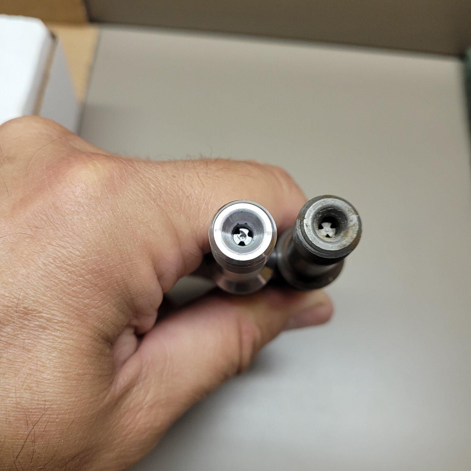

The opening at the tip is. 075 on the old one, and .115 on the new one. I wasn't sure if that would cause a problem.
They are universal 6.7/5.9 now. The 6.7 got higher flow tubes which are backwards compatible.
The larger tubes are 6.7 designed components for the higher pressures and flows in the 6.7 system. The 5.9 tubes are still manufactured and can be easily obtained if needed.
Pressure may be the same but the flow thru to the injector is going to be higher. The ECM tracks fuel usage basically by flow so there is a possibly a mismatched tube could introduce an imbalance. All things being equal, the ECM should be able to adjust for differences. If it doesn't you could end up with some imbalance. If the imbalance is off far enough it could surface as vibration. Considering the crappy OE balance job on the rotating assembly and the less than adequate injector balance on OE injectors anything is possible.

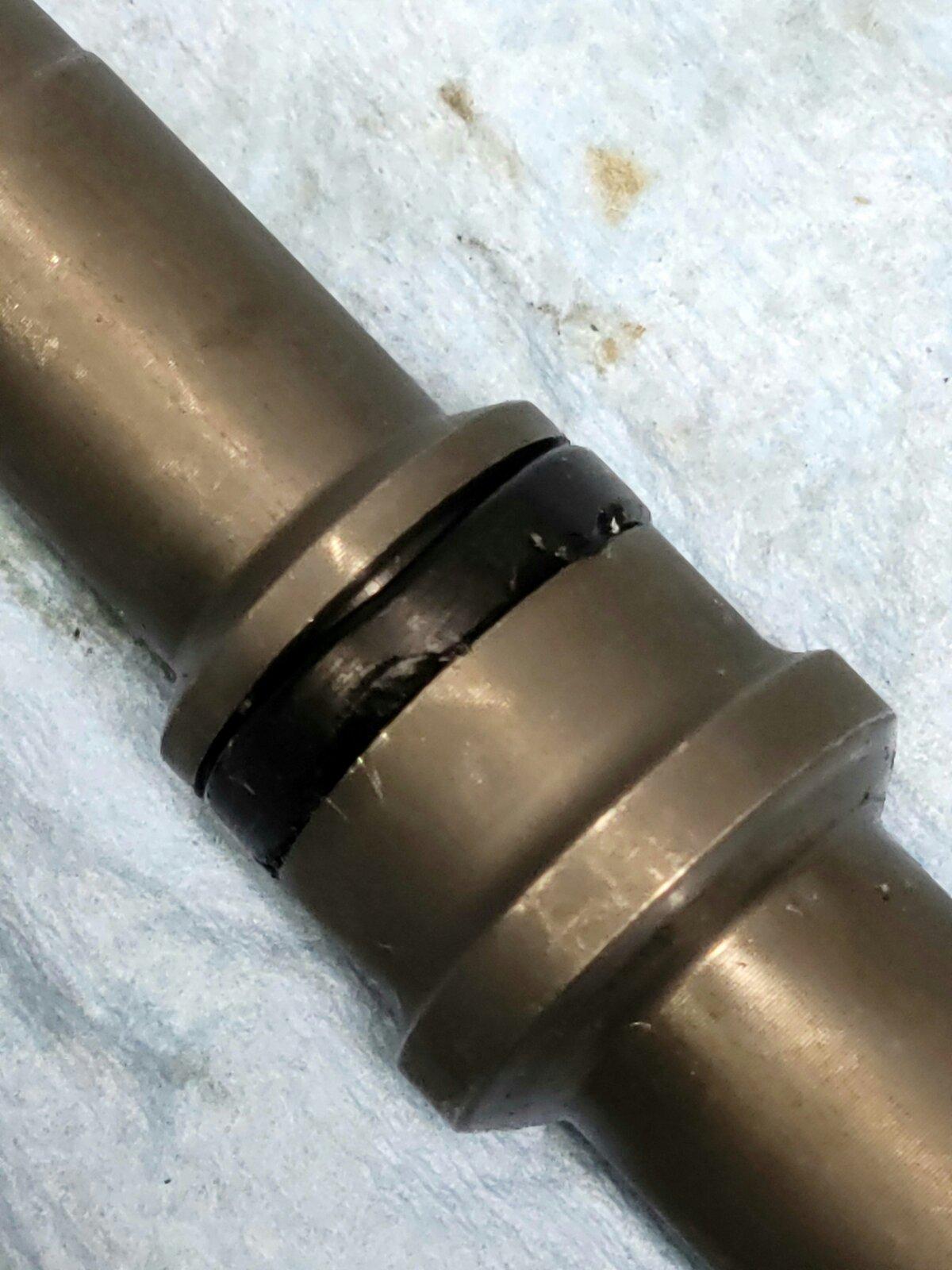

Resurrecting an old thread. Recently I started seeing more fuel leaking again. This time from #2 and #5. Decided to replace the o-rings on the connector tubes, don't recall which brand these are, but this is a problem. Looks like the old o-ring is falling apart, kind of brittle. I'll post a picture later, need to resize them. I'm installing new Cummins o-rings now, part #4062328
This is the o-ring on the 5 year old connector tubes, the originals that came out when I installed the new injectors looked nearly new. I was sure to use lube when I installed them.
