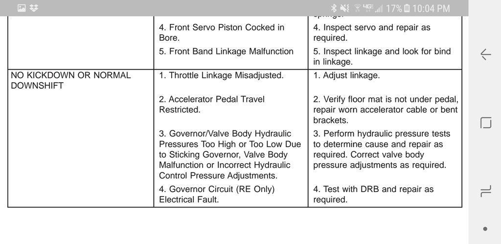

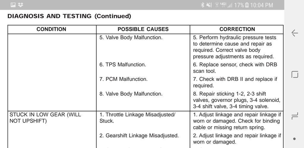

I have hade the truck for 2 months now. It has never shifted into od. If i turn tow haul off then it will lock up in 3rd but only if it is off. When comming to a stop it has never down shifted unless i do it manually. Well tonight i installed a BD Valve Body thinking that may have been my problem. On the first start up put it in drive and the converter locked up and stalled the truck. It done this in D and 2nd. I took it up the road (started in first and manually shifted ) and it done great but still no od. Stopped at stop light and had no 1st even when shifted manually. And still will only lockup in 3rd with tow haul off... Im about at my witts end anyone have any ideas ?
