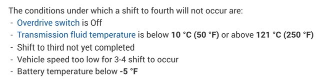

Below a certain temperature the transmission does not shift into OD nor does it use the TC clutch until the Trans is warmed up somewhat.
With the transmission up to operating temperature the problem is still there. The temperature sensor is working normally according to the readout on the scan tool.
