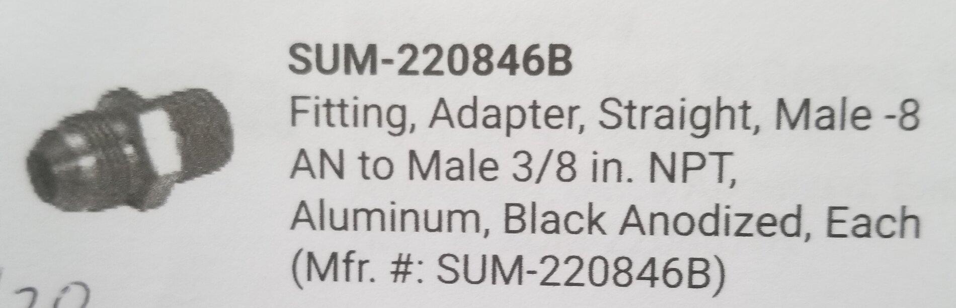

I seem to recall the Bill(AKA DTT) removed the check valve as part of his builds. He used the 96 output line that a port in it for the temp sender and a custom extension braided hose to reach from the 96 line to the exchanger.

I am going to replace that check in the heat exchanger with a straight through fitting. Is that fitting #8 JIC x 3/8"MNPT?
