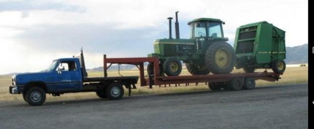

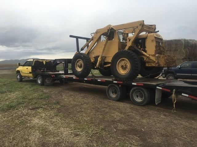

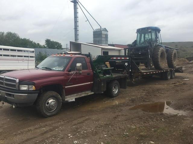

The nv4500 is a good transmission if you are over 18,000 pounds do not use fifth gear and you won’t have issues with it . Quad 4x4 has high quality parts to rebuild with . I wouldn’t own another automatic the longest day I lived in a dodge cummins .
