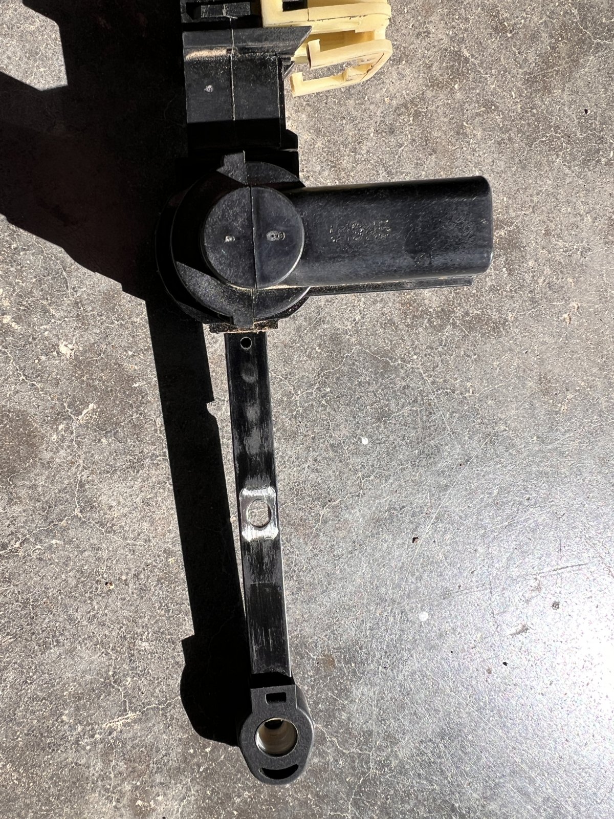

ok, cleaned the battery terminals, cleaned all the connectors with contact cleaner, ground strap is there and snug, checked the grounds in the engine bay to chassis - all good. The batter terminals were loose and 1 did need a cleaning. I agree that the P/N switch is just a pot. I don't think the gear indicator is jumping around anymore but it still doesn't illuminate in N, D, or 2 unless I wiggle the gear shifter just right. There is another sensor, I think, at the top end of the transmission cable eyelet that connects to the gear lever and is adjustable with a 2 wire electrical connector. Does anyone know what it is?
