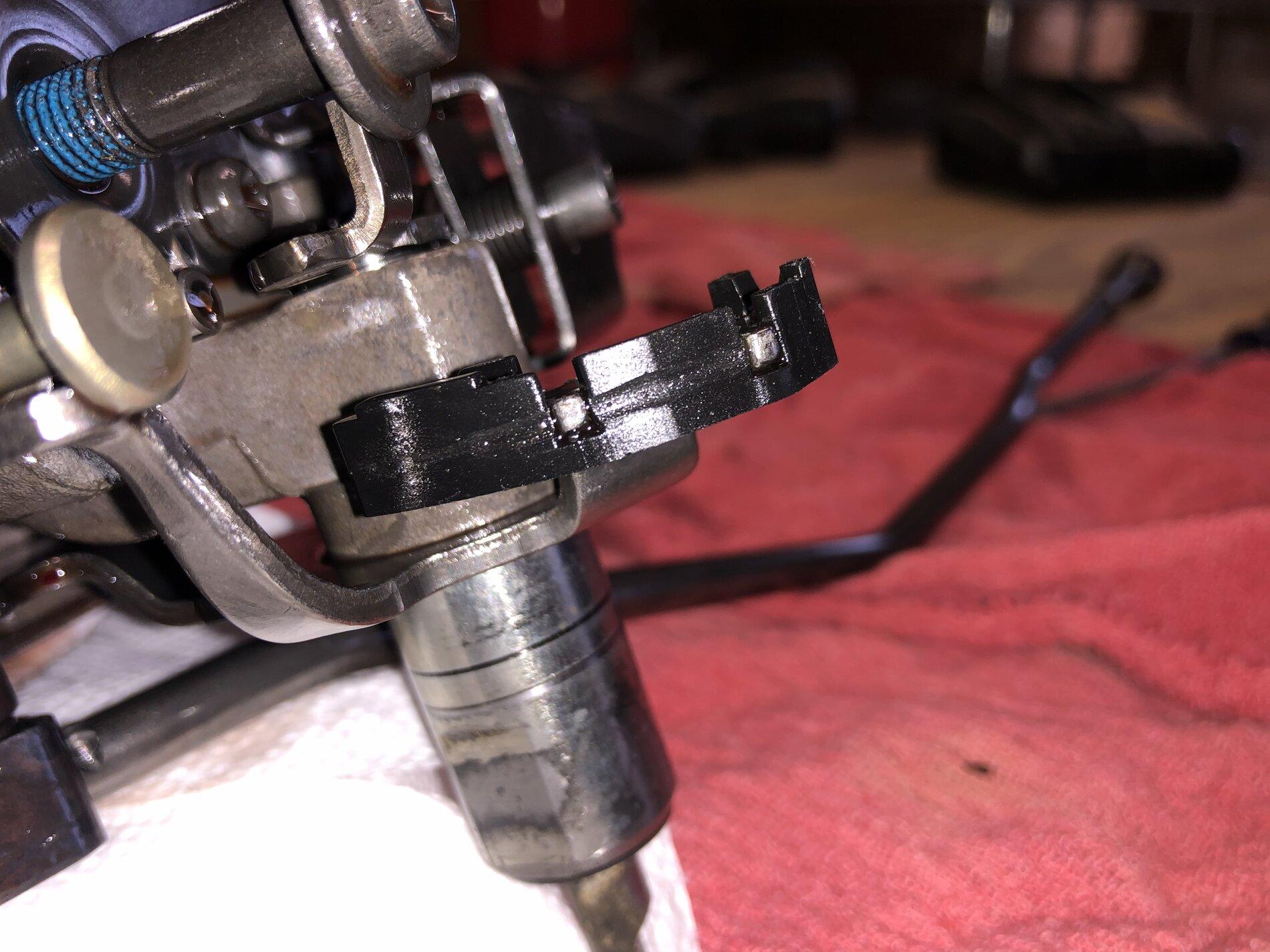

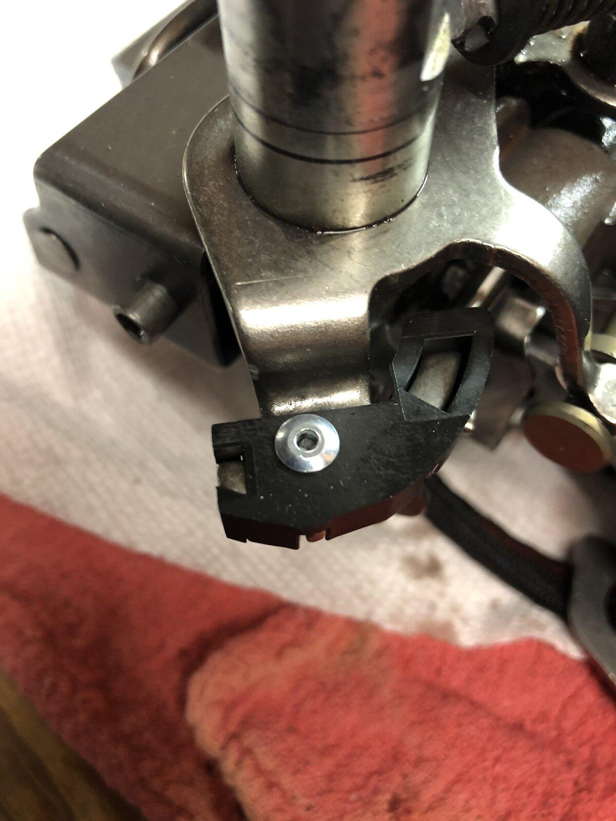

Worn insulator followed by replacement, followed by instructions and part number. do cover your valve body when grinding the steel rivot off.
