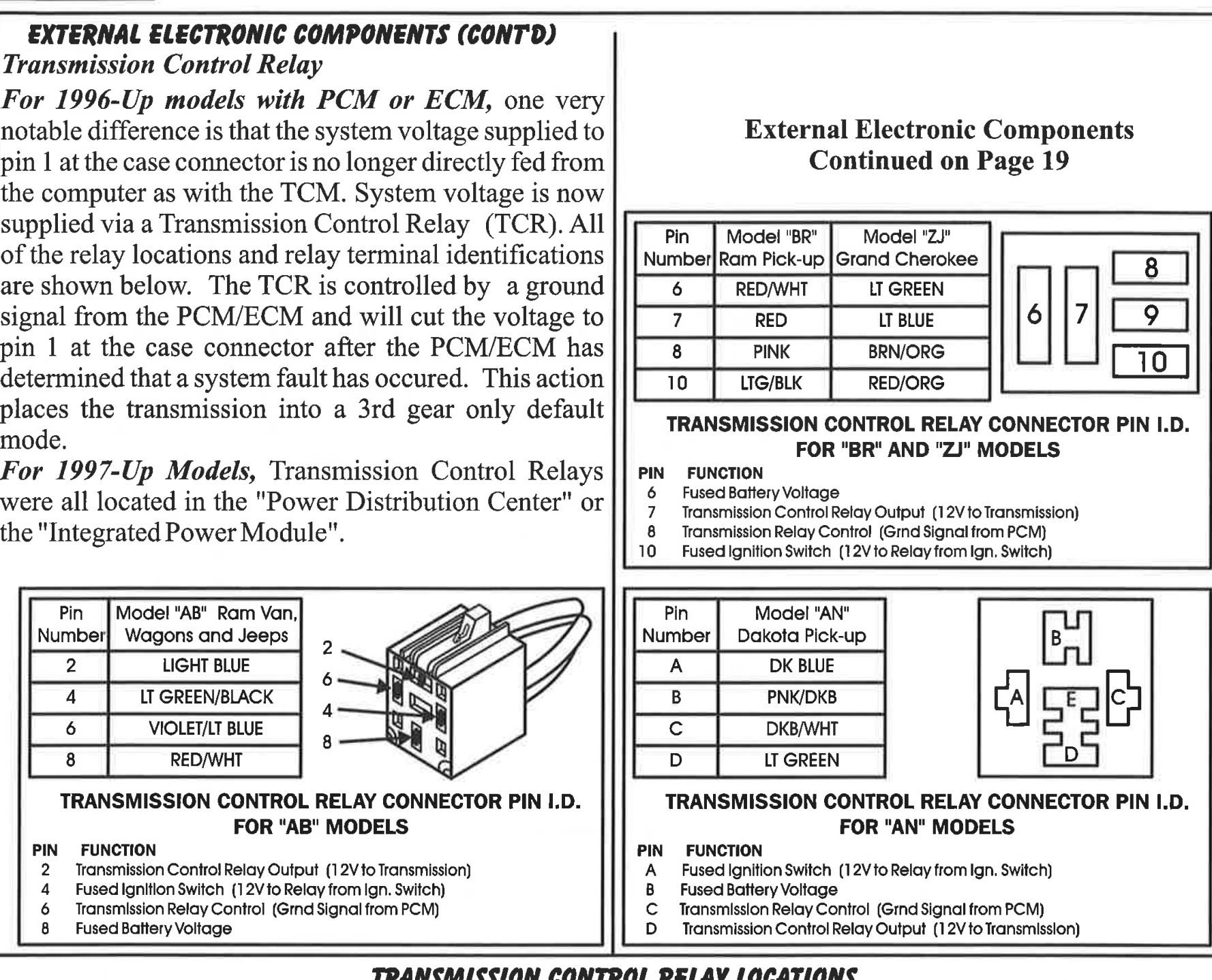

Have you checked for any codes, that 3rd gear start sounds like the TCR has removed power to pin 1 of the Trans.
Do you have the ATSG book it has some info on page 18, and then codes listed on Page 25.
Could swap the relay with a spare possibly.
Odd how Manual 1st does not work, is that rooster comb deal that works with your Manual valve not back in properly. Goerend has a video on that on youtube.
I know I've read the trans temp sensor will put it into that 3rd start only, but the Manual 1, 2 , 3 is separate from the electronics. That part should work.

I was thinking the same thing. Just finished pulling the codes, there's plenty of them. P0973, P0868, P2769, and P0713.
I'm going to read a little more, but it's looking like it's time to swap out the overdrive & lockup solenoid, governor pressure sensor, and governor pressure solenoid.
I did clear the codes, I'll start it back up in a bit and see what happens.
The whole thing with not having manual first is what's throwing me off. Hopefully it's nothing major.

I cleared the codes and took it out, it starts in 2nd and shifts to 3rd. No first in manual or drive, tow/haul makes no difference, no overdrive either.
I'm going to check the wiring harness and the 8 pin plug next. If I find nothing, I'll drop the pan and take the valve body out to give it a thorough cleaning.
Sometimes it's the simple fix. I checked the 8 pin plug for power and had none. The female end of the plug had been replaced years ago. Took all the tape off of it and found the power wire disconnected and several loose. Fixed them all, and no more problems.
