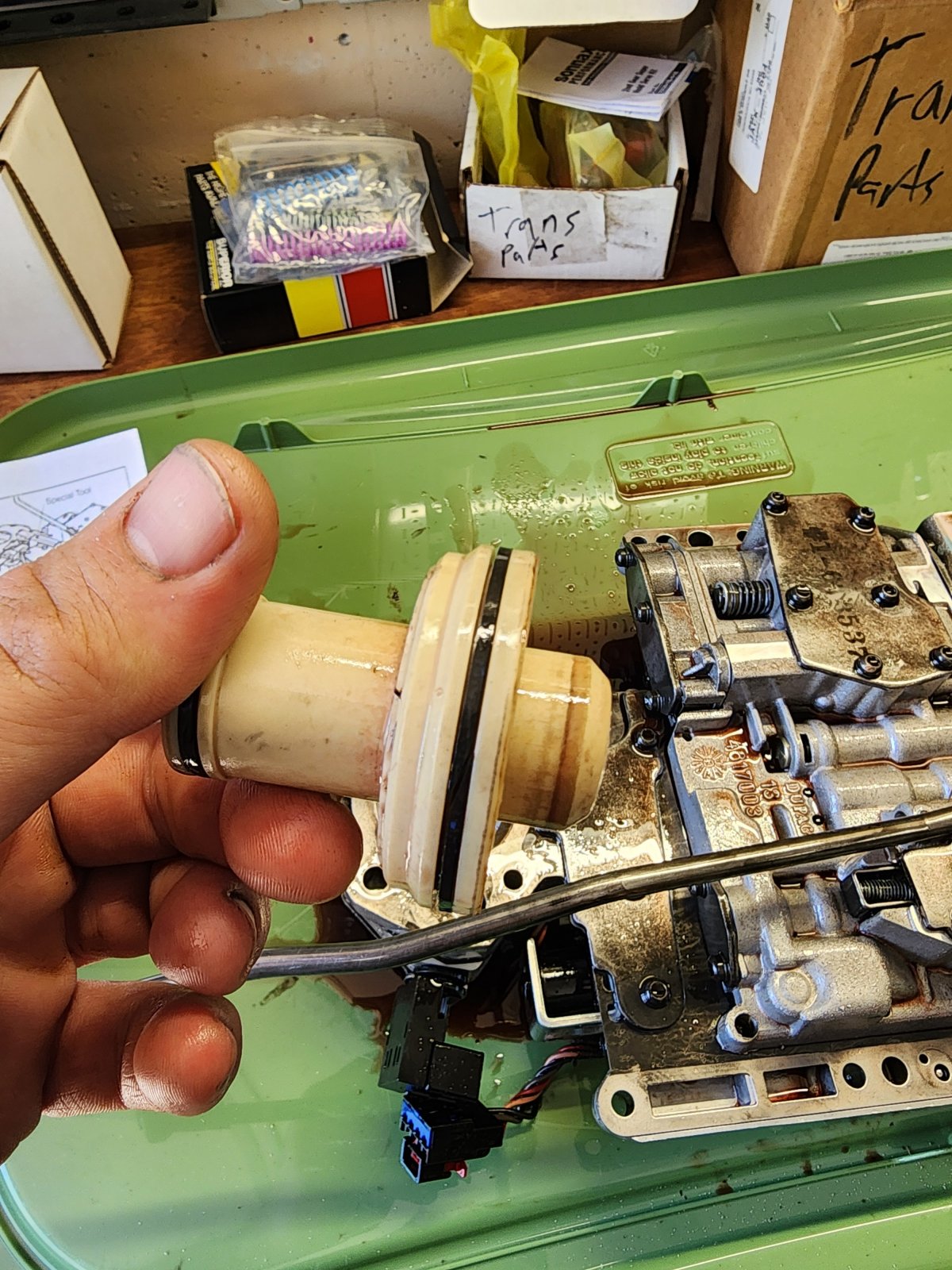

2. The stock accumulator fell freely to the ground upon removal of the valve body and seems to have no resistance when reinserted, leading me to think it wasn't sealing to the bore much at all. Is this normal for the stock accumulator?
