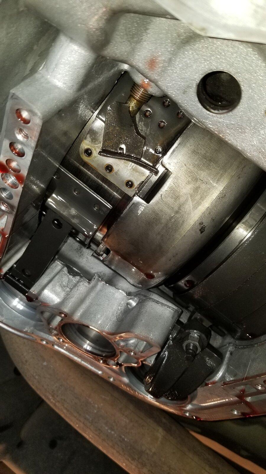

I had the adjusting anchor break causing the 2 year old slip in band bucket to break. (best guess chain of events)
Pulled the pan and replaced
The band
The strut
The adjuster bucket
The front accumulator piston (11% increase billet but not Sonnax)
Filter
Put it back together with proper band adj

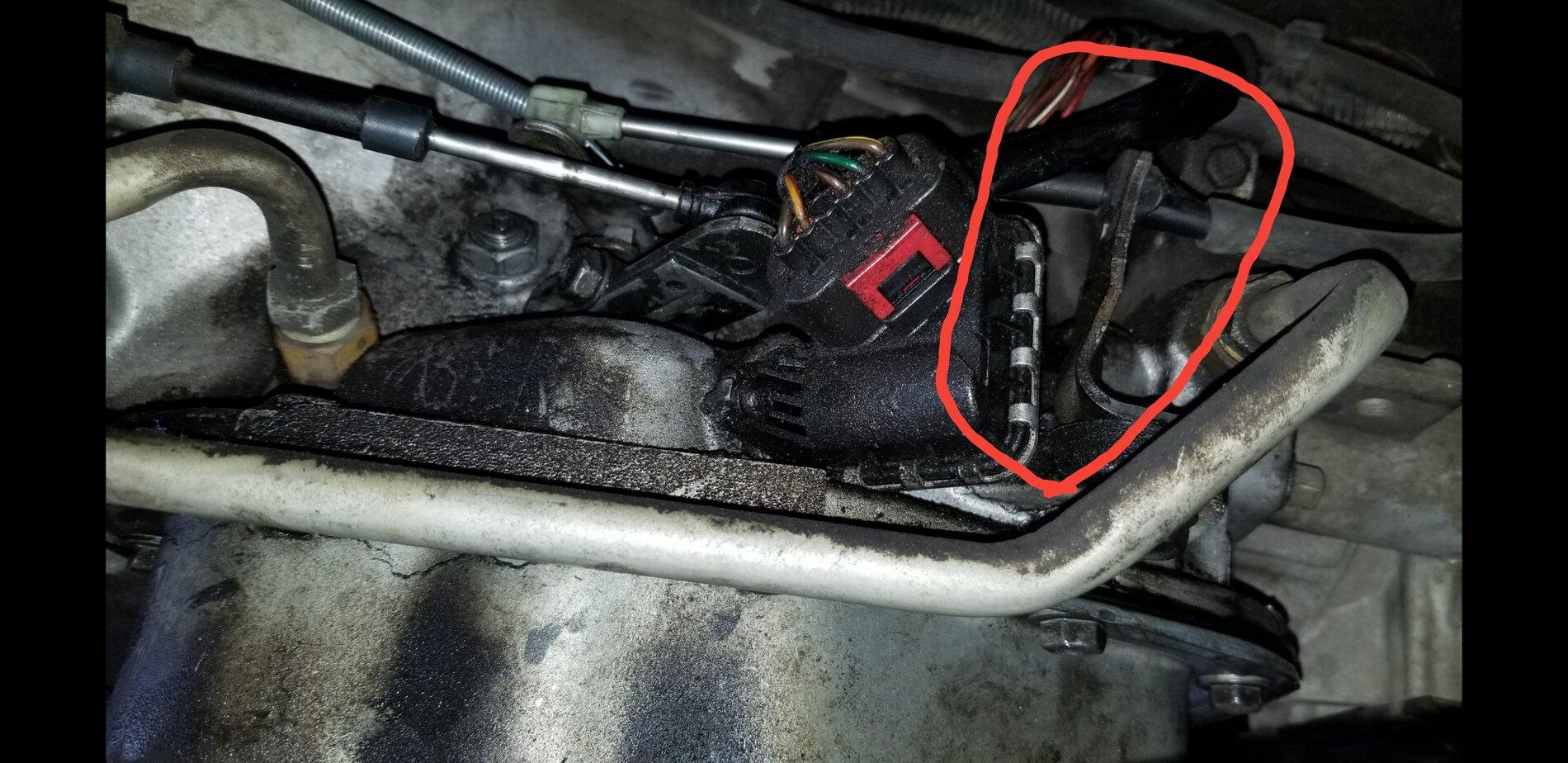

I found this thread http://www.competitiondiesel.com/forums/showthread.php?t=197701
I decided to look at mine and of coarse mine was different. I was however determined and didn't want to drop the pan yet.
I followed the cable up to the motor and found there seemed to be excessive slack in the cable. My story is that over the 17 years I've owned the truck as a 1 owner, the cable has stretched slightly.
So since I didn't have the threads on a shaft I just bent the bracket to the rear of the truck thus pulling the leaver back some. See Picture.
I was looking for a way to increase the line pressure slightly without having to drop the pan. I believe this just told the trans that there was slightly more throttle but not sure, the result was perfect.

It is adjustable up at the Engine.
No need to bend a bracket.
Good to see that problem solved, TV cable tension is crucial for how the transmission shifts and works, even premature fails are very known from this!!
