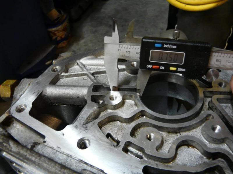

This to me sounds like a classic case of the one way bearing, sprag clutch, or “over running clutch” in the back of the main transmission case spinning. in performance transmissions, they need to be drilled and tapped so that they can’t spin in the case. The picture below shows where to put the screws. The overrunning clutch is what holds the reverse drum, in the back of trans case. once the overdrive is removed, then the overdrive piston & housing taken off (there’s 6 bolts behind the overdrive piston) then you will find great back of the case. this is where you need to measure out the distance in the picture and drill and tap 4-6 screws (I prefer the 3/8 allen headed ones). unfortunately, this does mean the removal of the transmission is recommended, and possibly the transmission case be replaced, depending on the severity. I’m 16 years old and have built four 48re transmssion top to bottom with well over 25,000 miles on all of them currently and at over 500 horsepower each. While you have the transmssion out I would also look into getting a different torque converter or at least having a trans shop cut it open and freshen it up. Goerend, suncoast, DPC, and even Monster transmissions can all help you with that. If you have any other questions, just ask! PM me if you would like a phone number for any shops listed or myself. I can help you out with your transmssion issue one way or another.

Your experience is much appreciated, this little adventure has however sparked more questions. Such as why there isn't a fix for the lip thing similar to a bolt in sprag (I don't even know what to call the lip in the case that broke off, where the race presses in). The case I have is already tapped for a bolt in sprag, but from what's left of the one in there it doesn't look like one was installed. I have a pic but it's file size is to big.
Usually the splines on the case are stripped out by the pressed in sprag clutch housing thingy. Not sure what it is called either, but in most cases the splines are just stripped out, but in your case the whole thing actually broke off? or did I read that wrong.... Anyway, thanks for the update, pm me if you have any questions upon reassembly and/or need parts or literally anything. Thanks again!
There ar ebolt in sprags for the 47\48RE that fix the stripped spline problem and keep it form happening. Doesen't make the sprag part any string as they still use the plastic retainer but it addresses spinning it.
