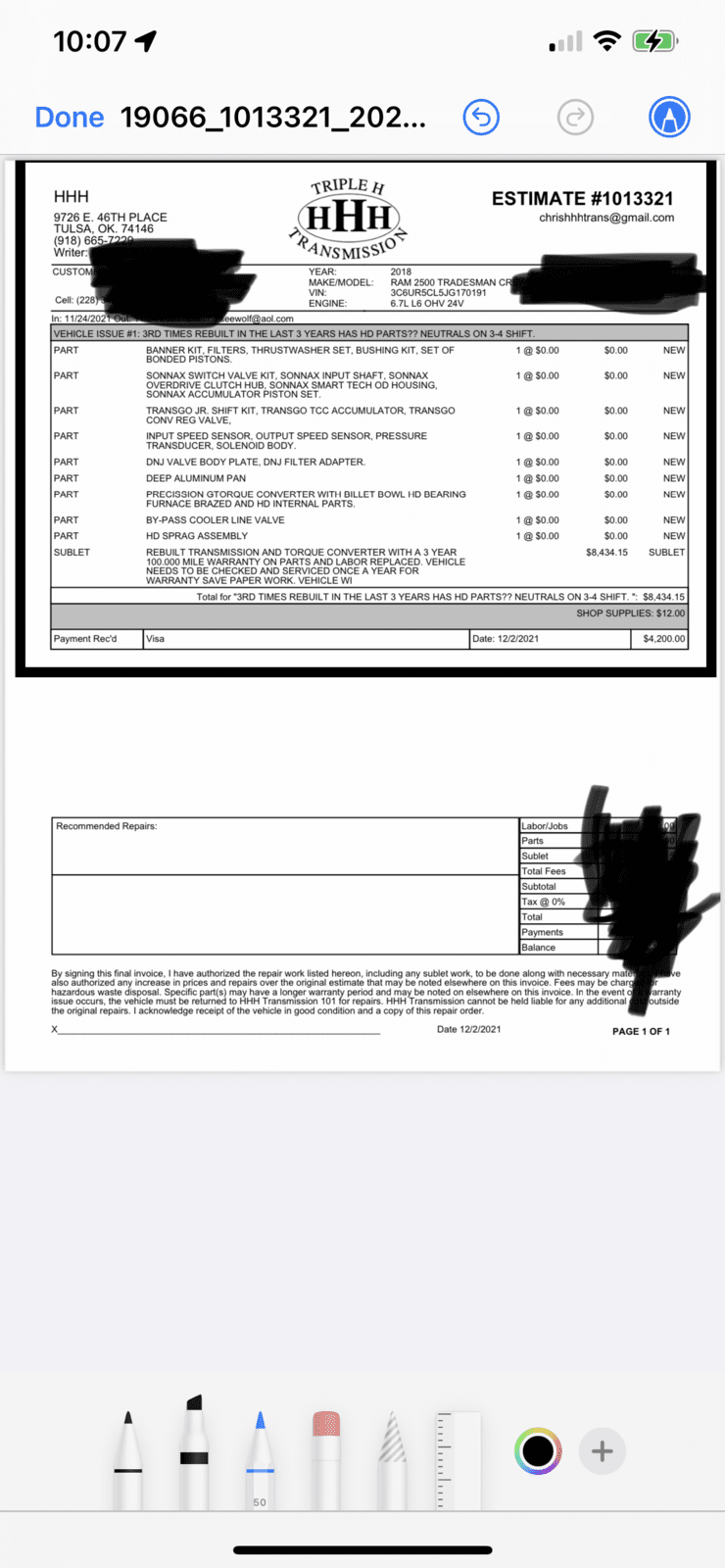

So I got my transmission rebuilt about 3 months ago. Ever since I got it back it does some weird stuff going from 4th to 5th. If I’m very light on the throttle or wot it doesn’t do it. But if I go medium throttle when it shifts from 4th to 5th it’s almost like it’s shifting then about a second or two after the tc is locking and almost like it’s a shift flare but only does it in those gears. Added a file of what was done.

How many miles on the truck and what’s it used for? I have to ask, four year old truck and the transmission’s been rebuilt three times? They’re charging you $8,400 for a rebuild?
Truck has 117,000. And it’s used for a rig welding truck and I also pull an Rv with it a good bit. And yes that was for the last rebuild. And the first time was just clutch’s and the second time another guy screwed me over. Said he was putting in all hd parts and put it all back to stock.
