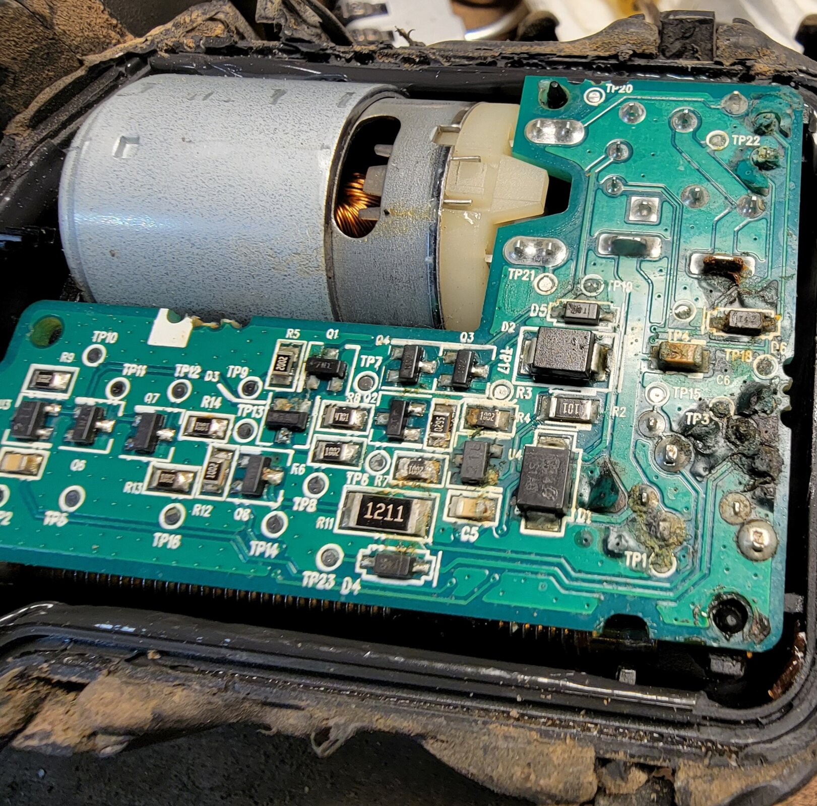

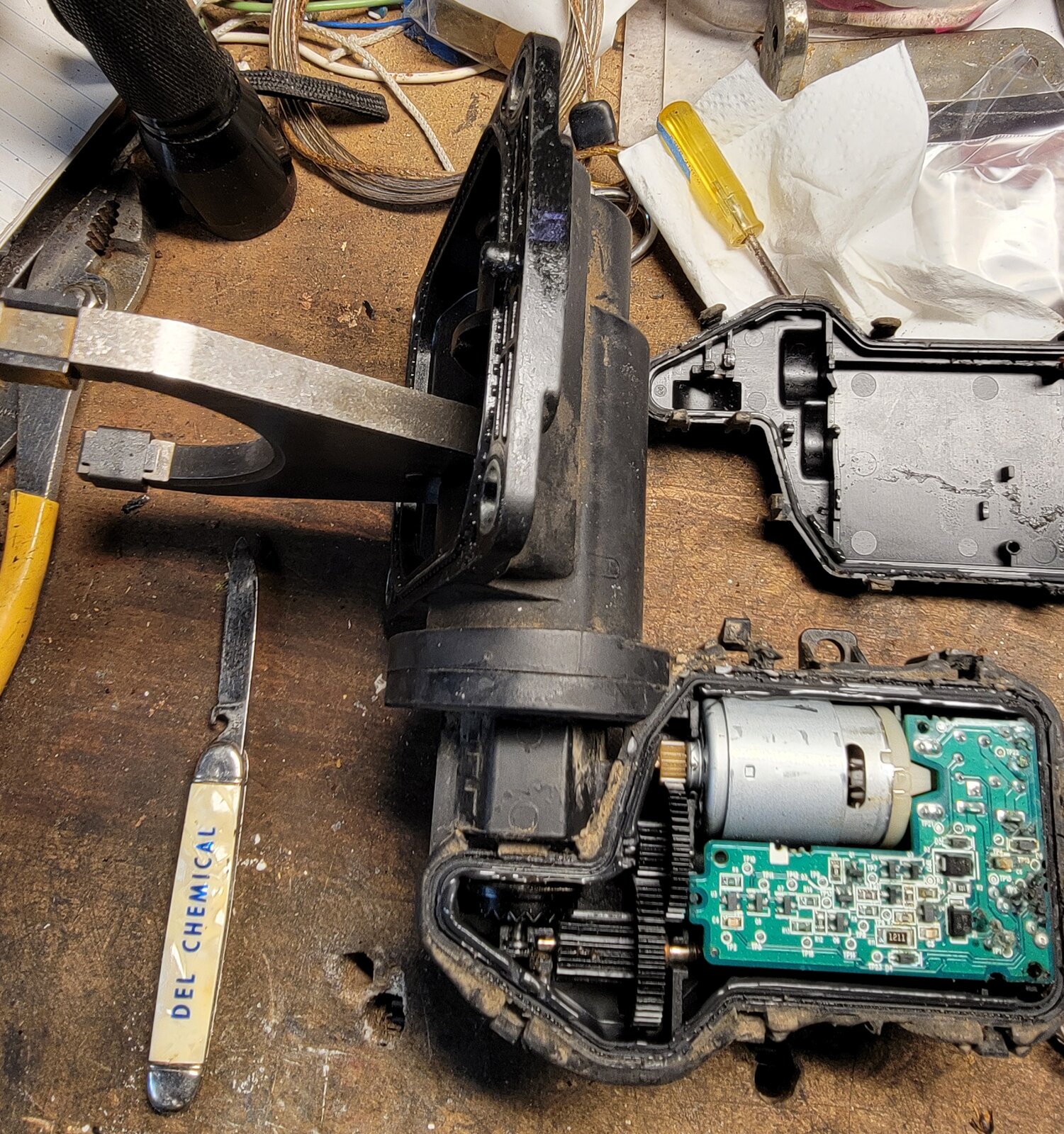

Attached is a photo of the OEM part that shows a burned circuit board. Not any water in it that I coud see. I didn't open the SECO or Dorman parts because I returned them under warranty (Amazon and O'Reillys). The case seal is just a little sloppy silicone!
Actuator takes 5 minutes to swap out. 4 10mm bolts and a plug. Point the truck down hill and elevate the right side about a foot and you will only lose about a spoon of gear oil.
Can you photo the other side of the board? Curious as to what component or wiring is in the burnt area. I see traces lifted off the board in two other areas that didn't look as hot.
