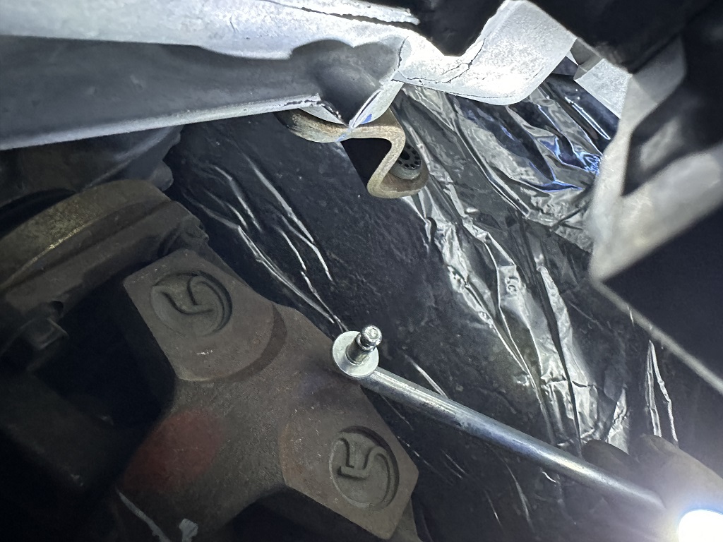

Ok, what parts am I missing? Went to shift into 4X4, funny bang, and 4X4 shifter now loose... Well hard stop into crossmember. No longer connected!
What retains the rod into the shift selector on the transfer case?
o_O Must be for assembly line speed as the bushing is the only thing holding the rod in place. I read where the entire shift rod will fall off the truck! Some aftermarket have a E Clip with the kit. I got a replacement bushing from the dealer and changed it out.
Just pop it back in hard and try to pull it out after.
If you can pull it you need a new bushing.
Probably wasn't fully seated from the factory as these hold on like crazy.
