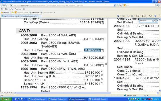

That would be a Timken HA590032 for an 03.

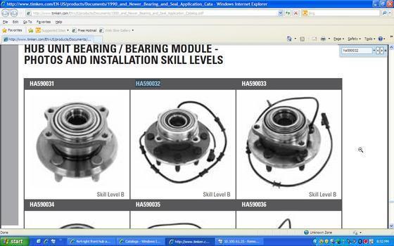

Here is the page from the Timken Catalog
Here is the illustration... ...
Let me know if you want cross references, but you really should put a Timken in there... . ;)
Mike. :)

Thanks mwilson. That is one of the parts in the rockauto catalog, $163. 00. Mopar4less site was down, probably not timken anyway. I get it about timken. Considered just breaking the hub down and replacing the bearings but getting lazy. Your parts prowess has beeninvaluableto me on more than one occasion and I have seen you doing it for many others. You deserve a few steak dinners. Cyber steaks just do not seem appropriate.
The hub can be broke down, but doing it to replace the bearings is not likely to work, even if the bearings can be located. The two pieces that make up the hub are also the races. I pulled a hub apart and there was chunks and scouring on the races. For Timkens, the $163 is a good price.
