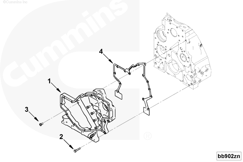

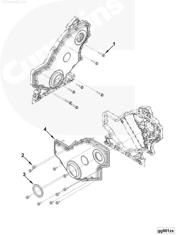

Anyone recall seeing a pic of one on here ? Thought I did way back when , but can't find it ... looking to see what exactly is up in the front gear case area and the right side up front . Have an oil leak that appears to be coming from behind the A/C bracket, not convinced its from the gear case cover itself. TIA !
Here is the front cover and front gear case housing, if you want more specific areas let me know..

Thanks Mike, what I am curious about is the area in the block behind the A/C bracket... Are those holes going through into an oil filled area or not? I've put some dye in the oil and it seems to be coming from behind that bracket. Guess I could pull that darn case cover and seal it real good with some silicone, factory use a gasket or not, been a while since I had it off .
