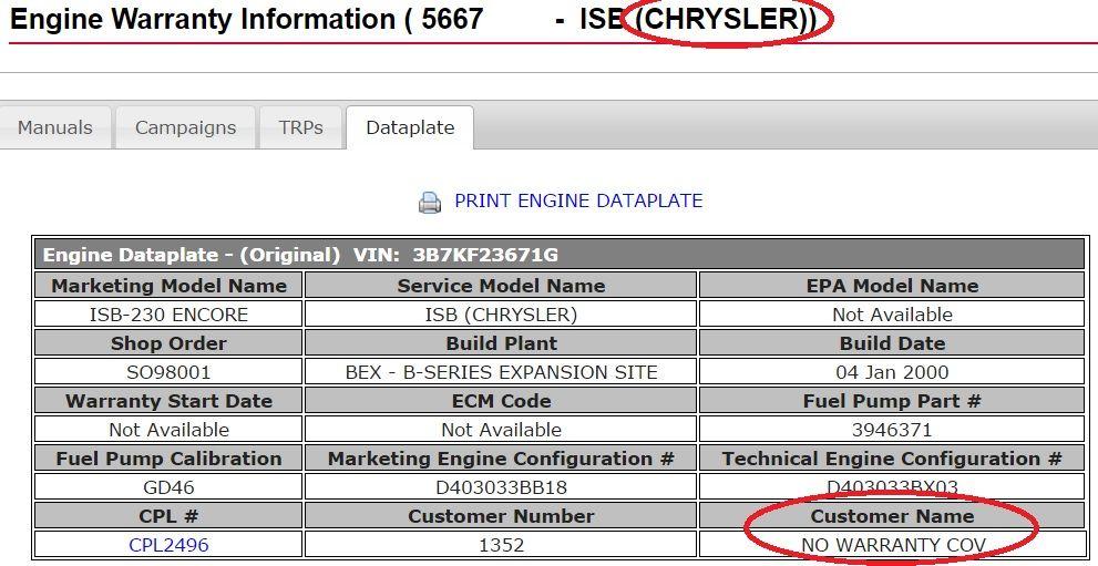

You were under warranty then?

The Cummins engine in the Dodge pickup had no warranty from Cummins. This was how Chrysler bought them from Cummins. Here is the warranty info for a friend of mine's '01 shown on Cummins QuickServe:
