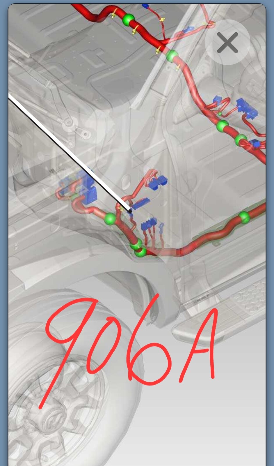

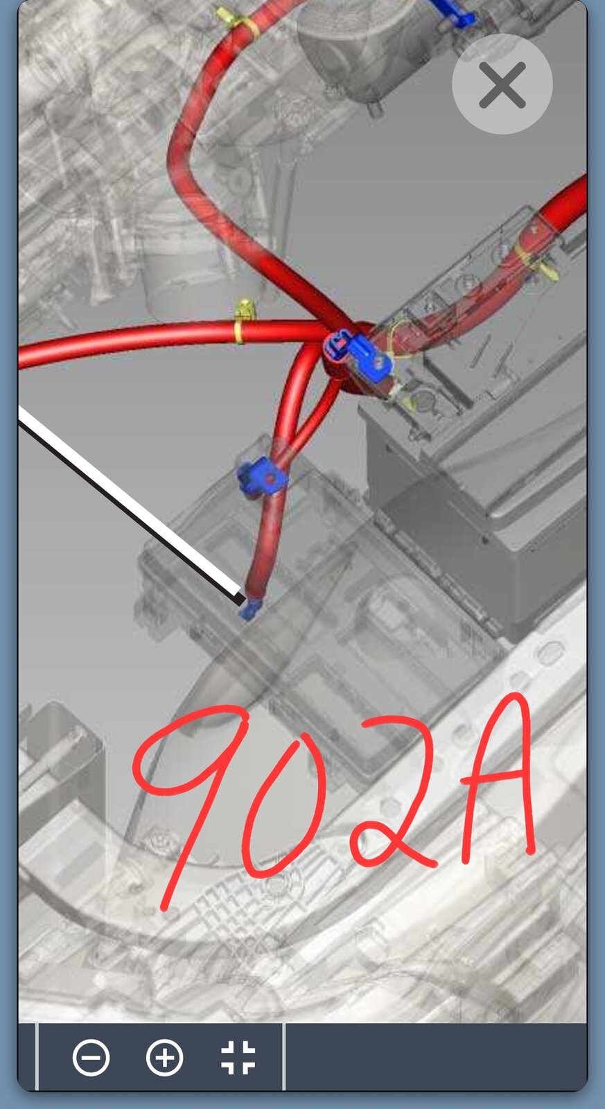

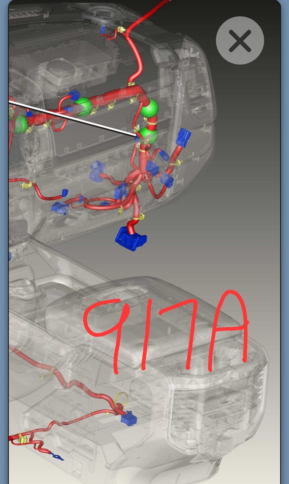

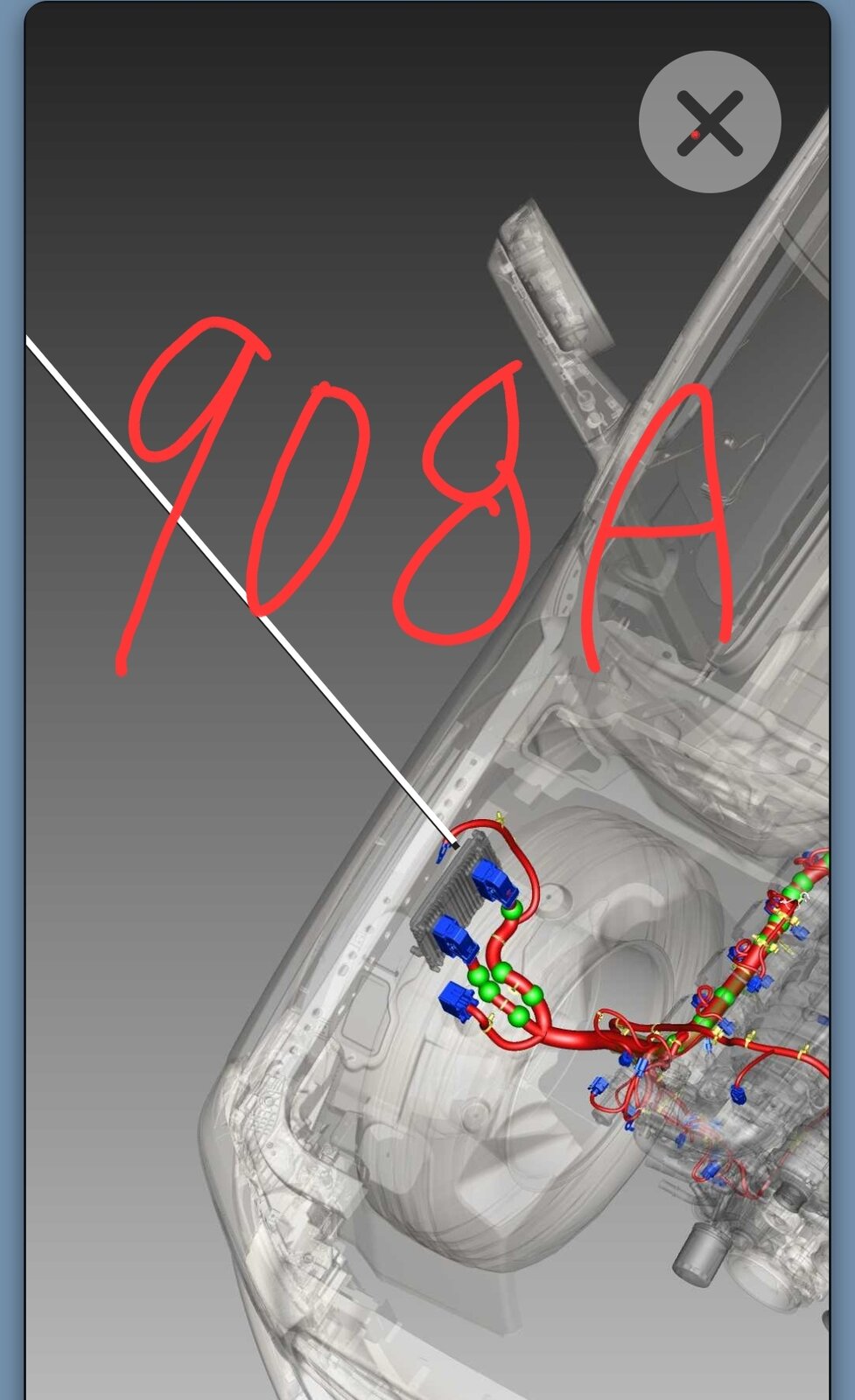

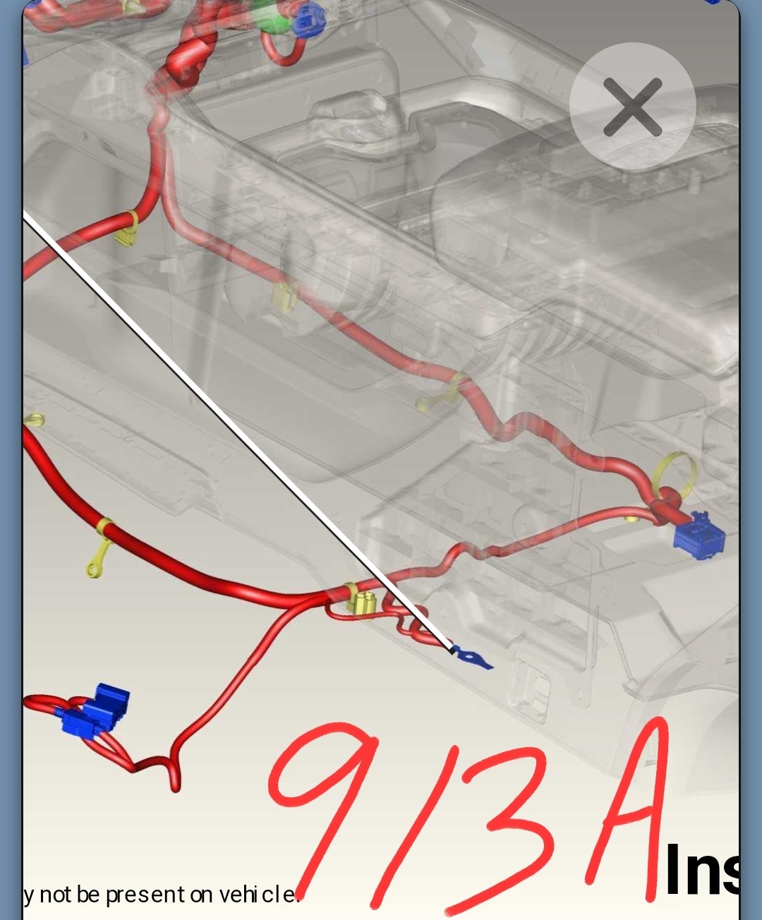

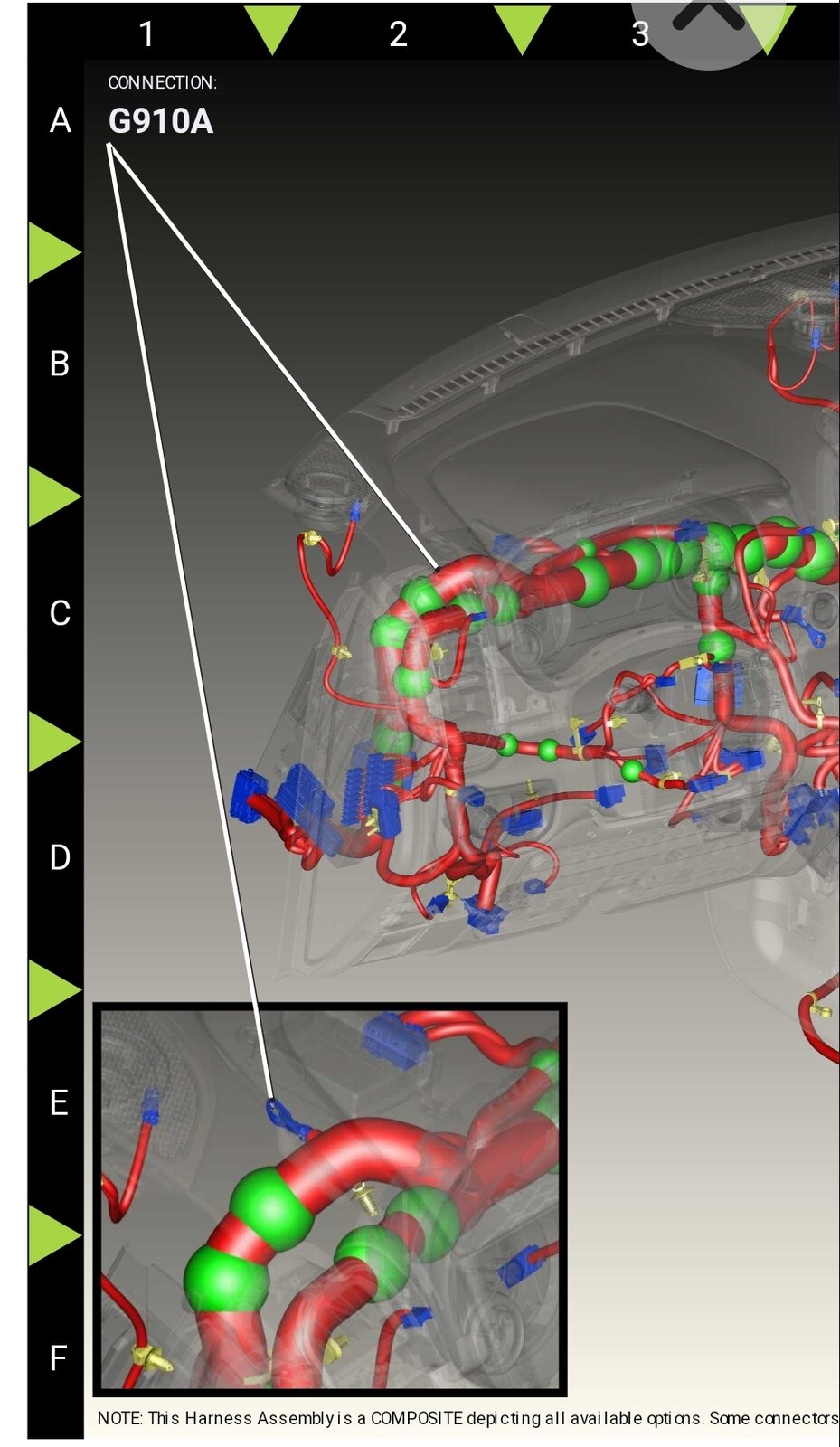

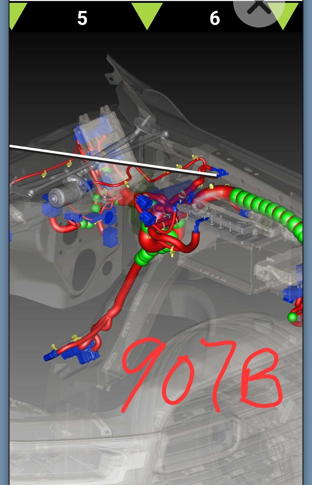

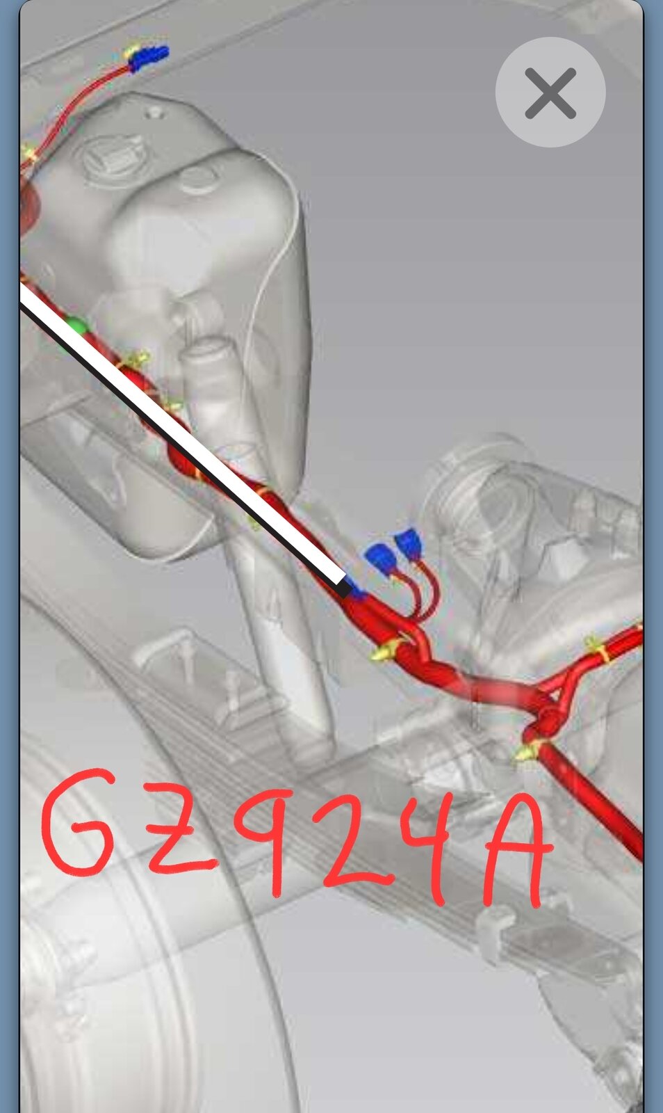

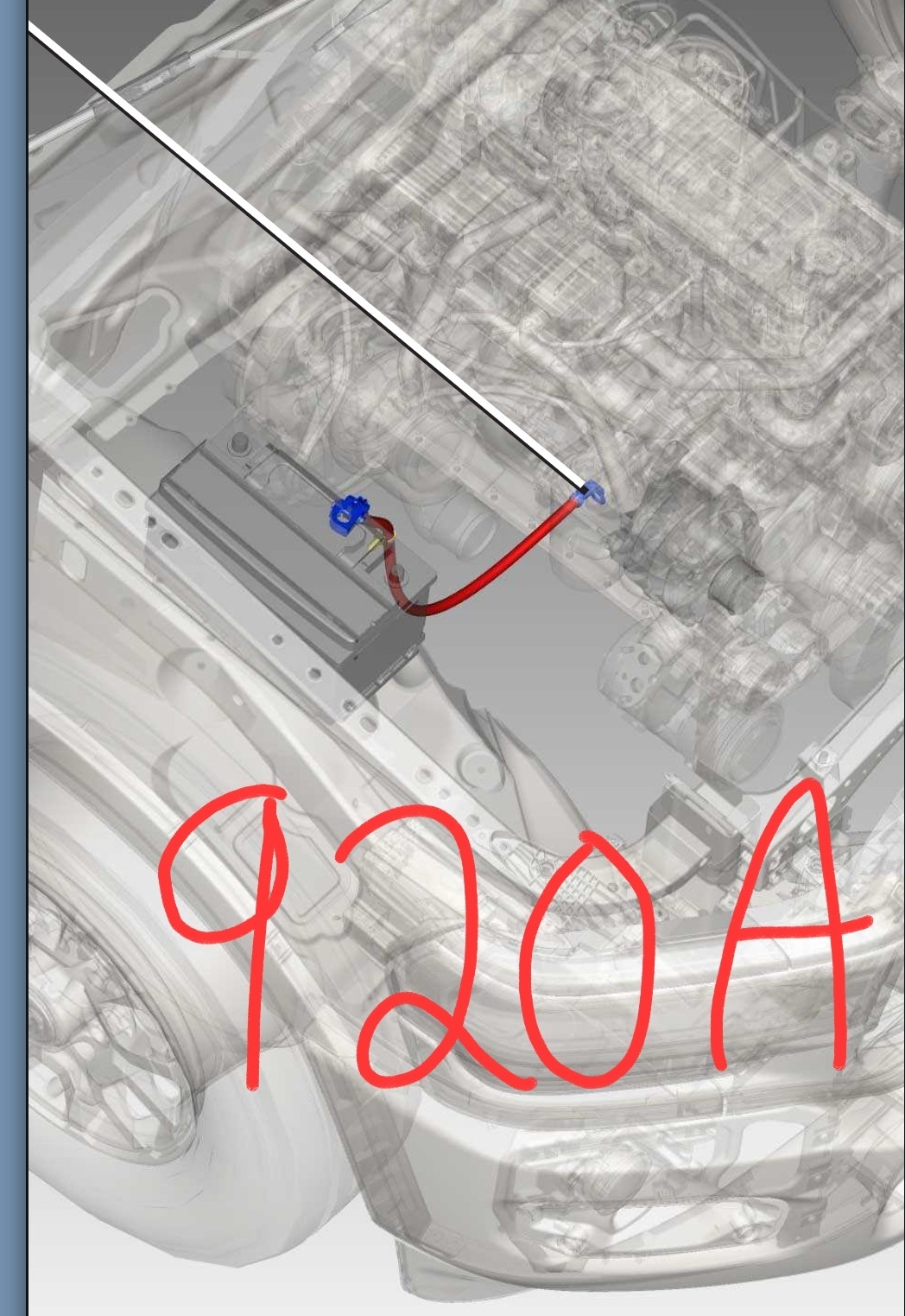

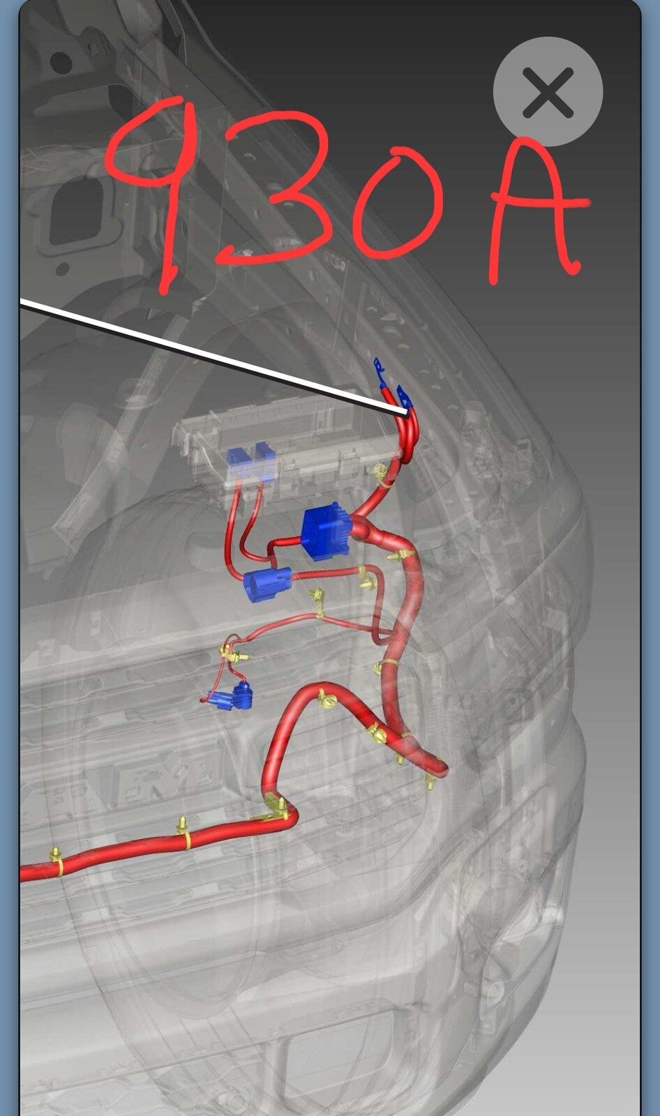

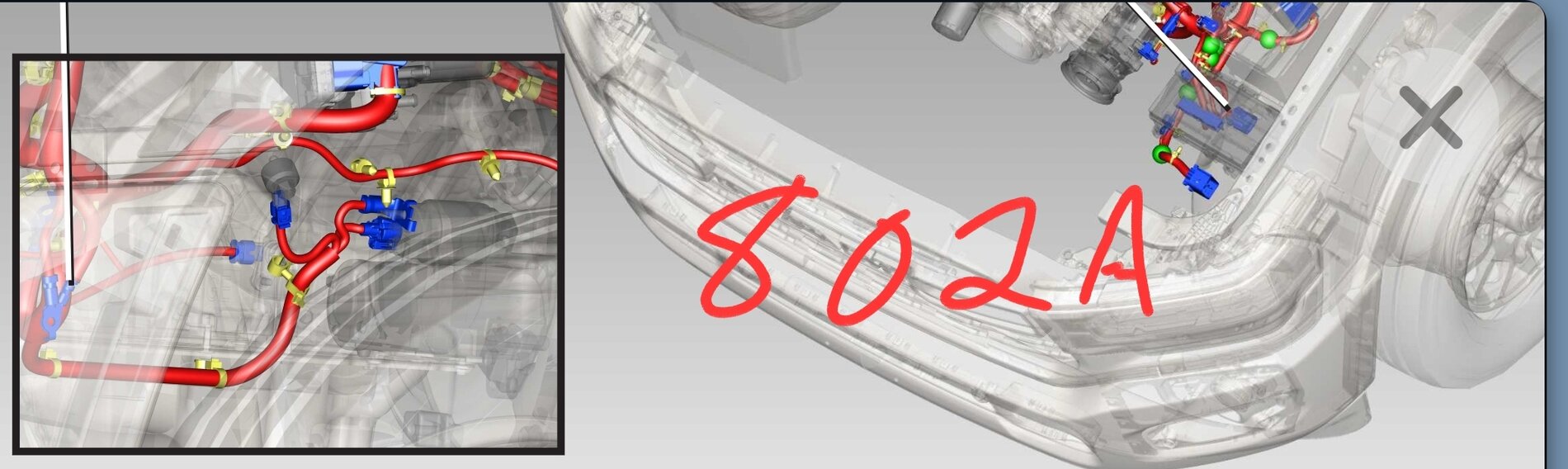

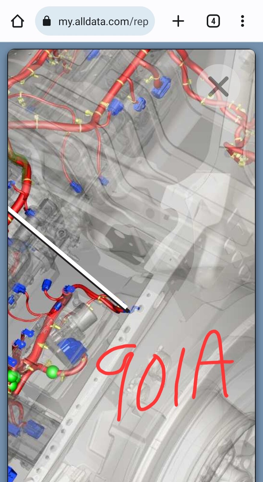

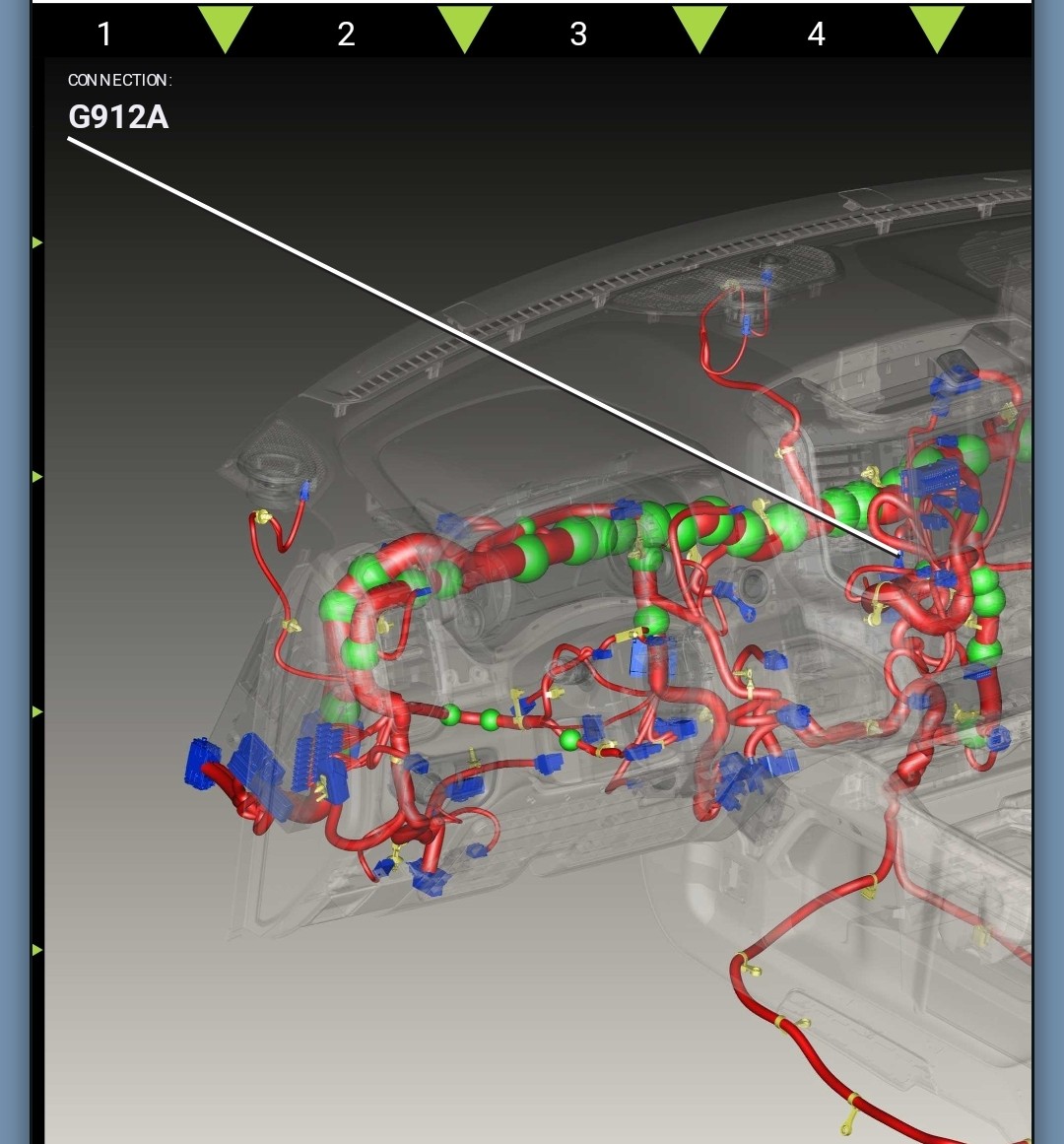

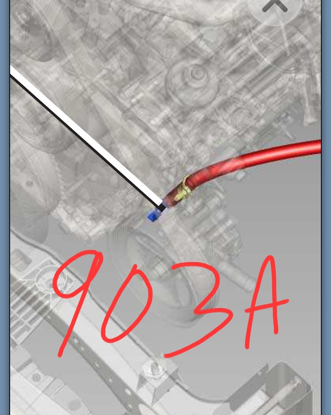

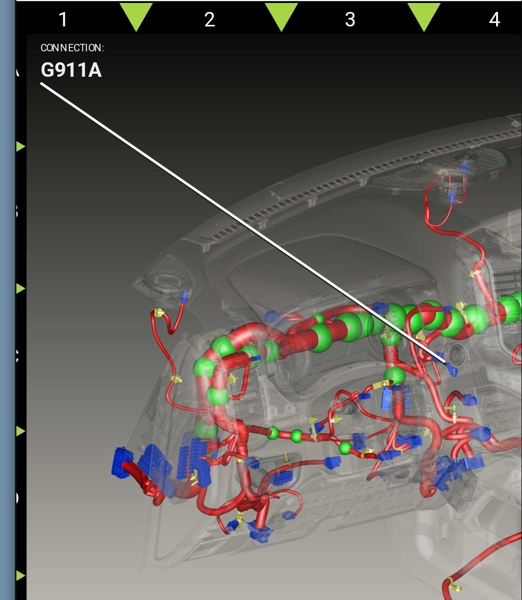

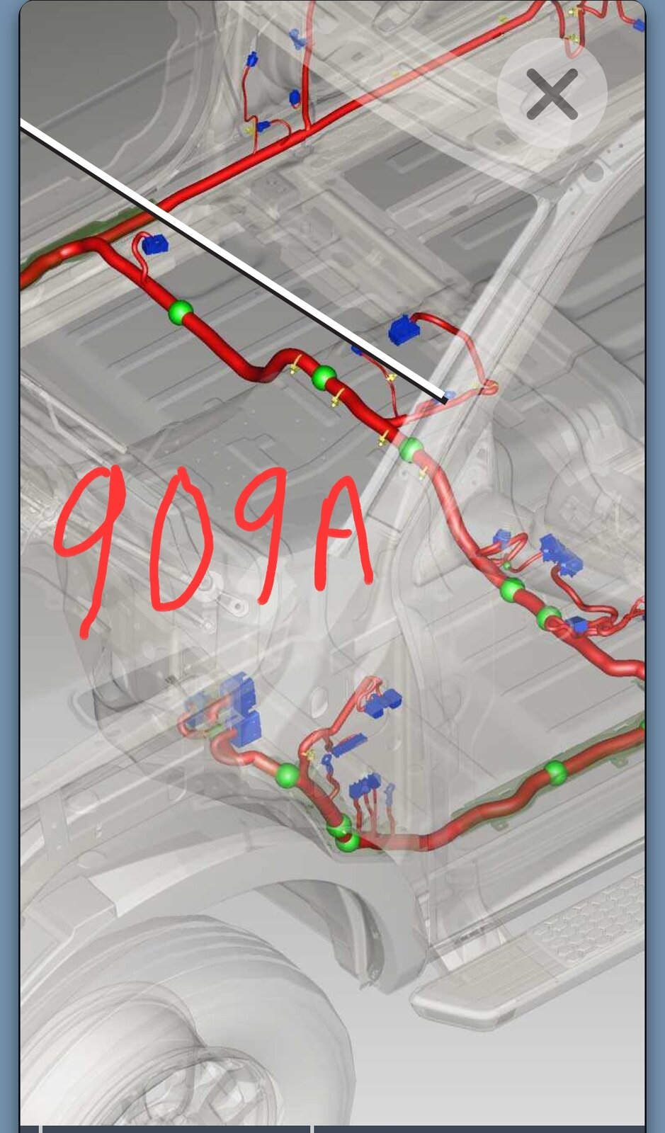

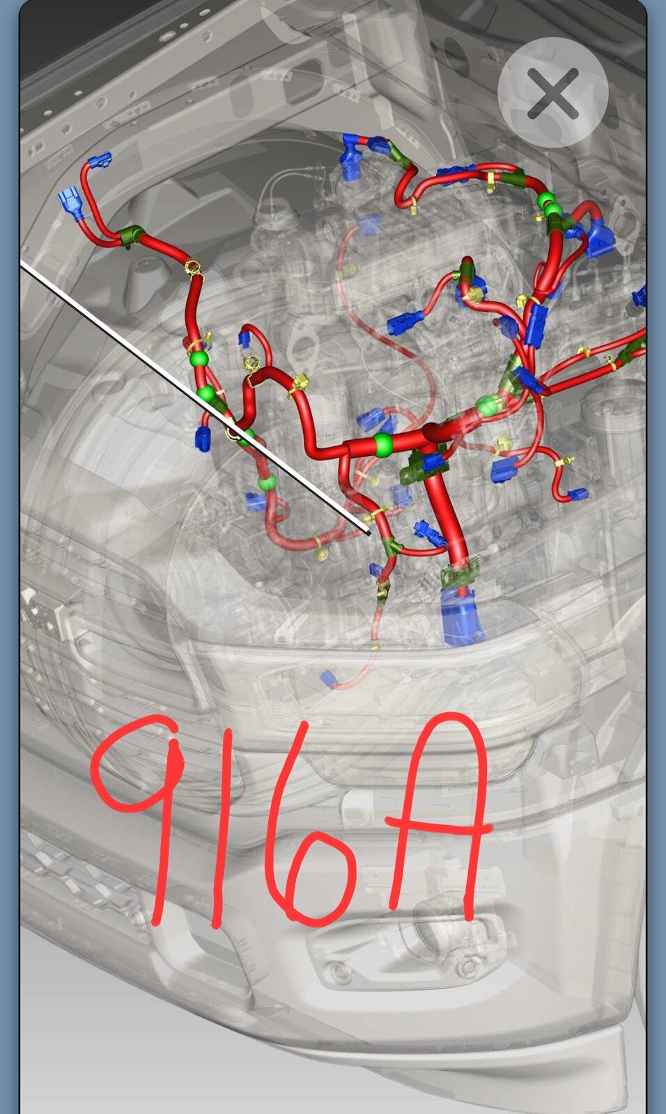

Is anyone happen to have a full list of engine grounds and under the hood? I've got no start and service throttle control module on the dash. Someone else just replace the camshaft and I'm putting it all back together now..... Yeah I know... Yay me!!!
I don't have your answers but I would also post in 4th generation forum, CGI engines to improve chances.

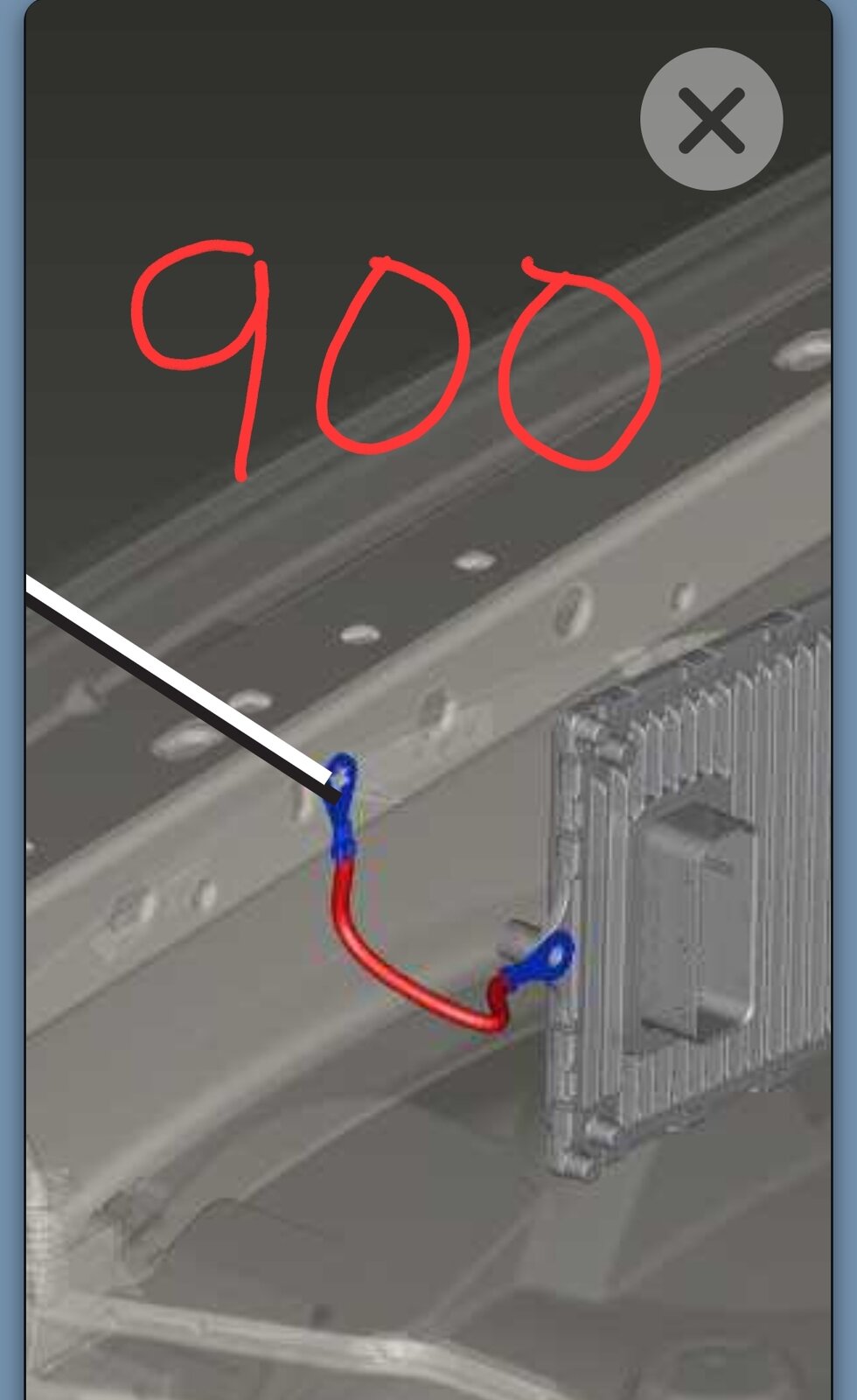

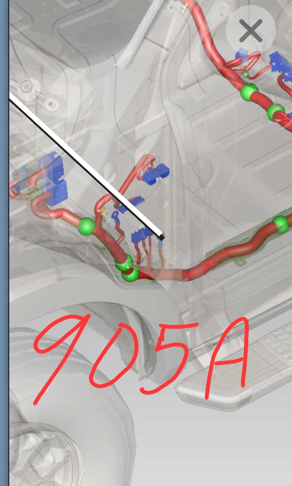

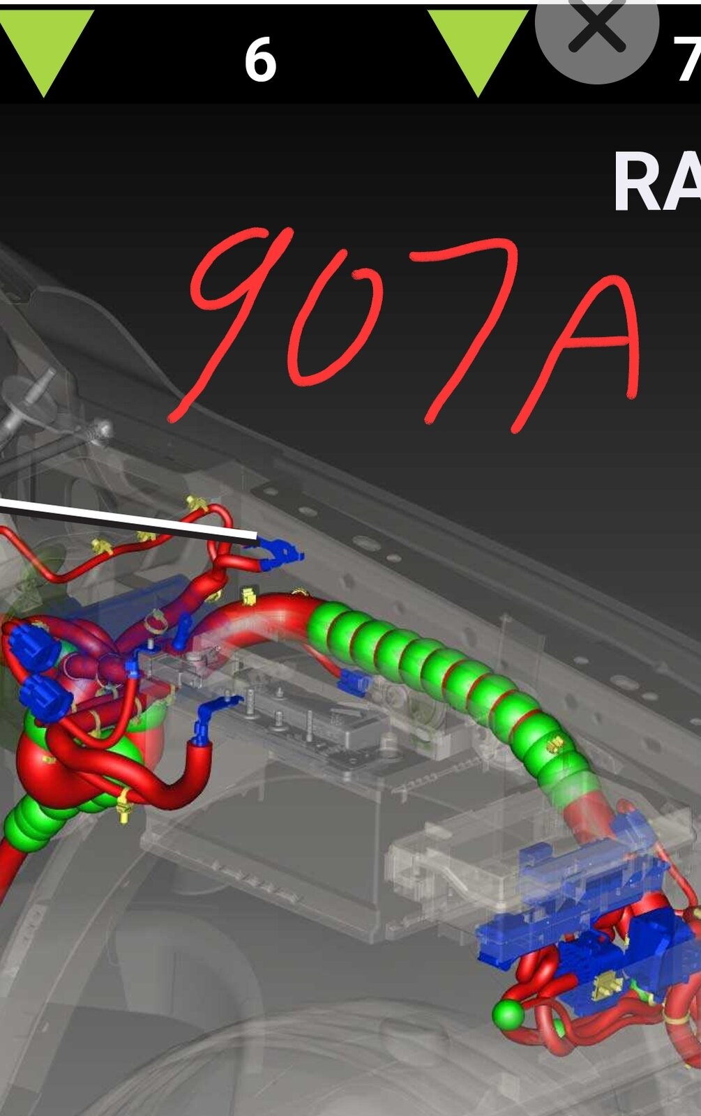

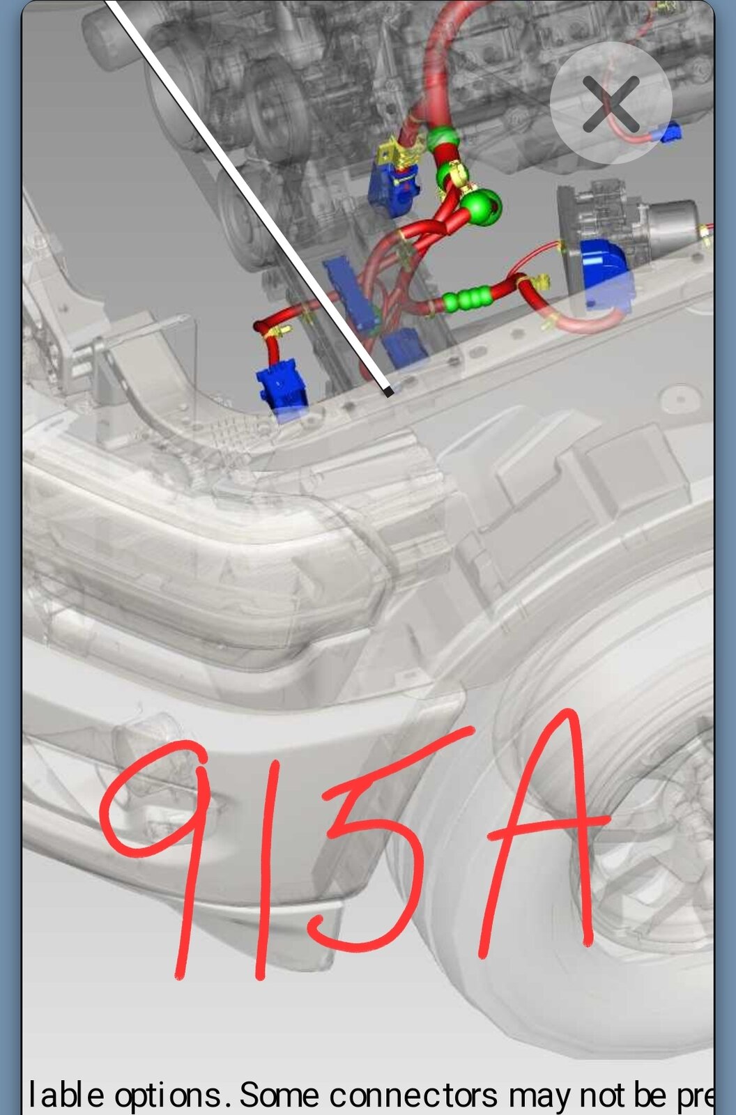

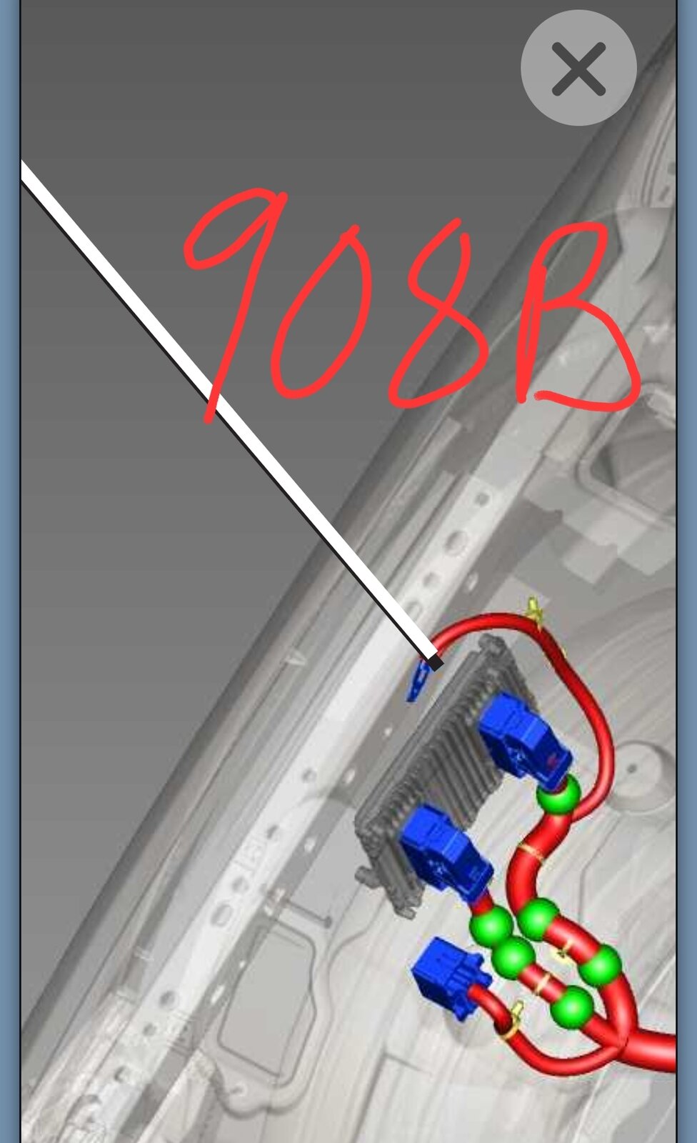

Not all options apply to all models, and they have some images that are gassers, it shows 28 grounds listed when I searched Ground Locations.
The white line is the ground.
