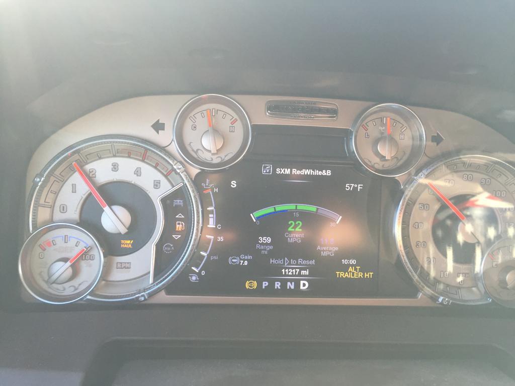

Here is my 15 with 4.10's Aisin and stock size MS2's.
