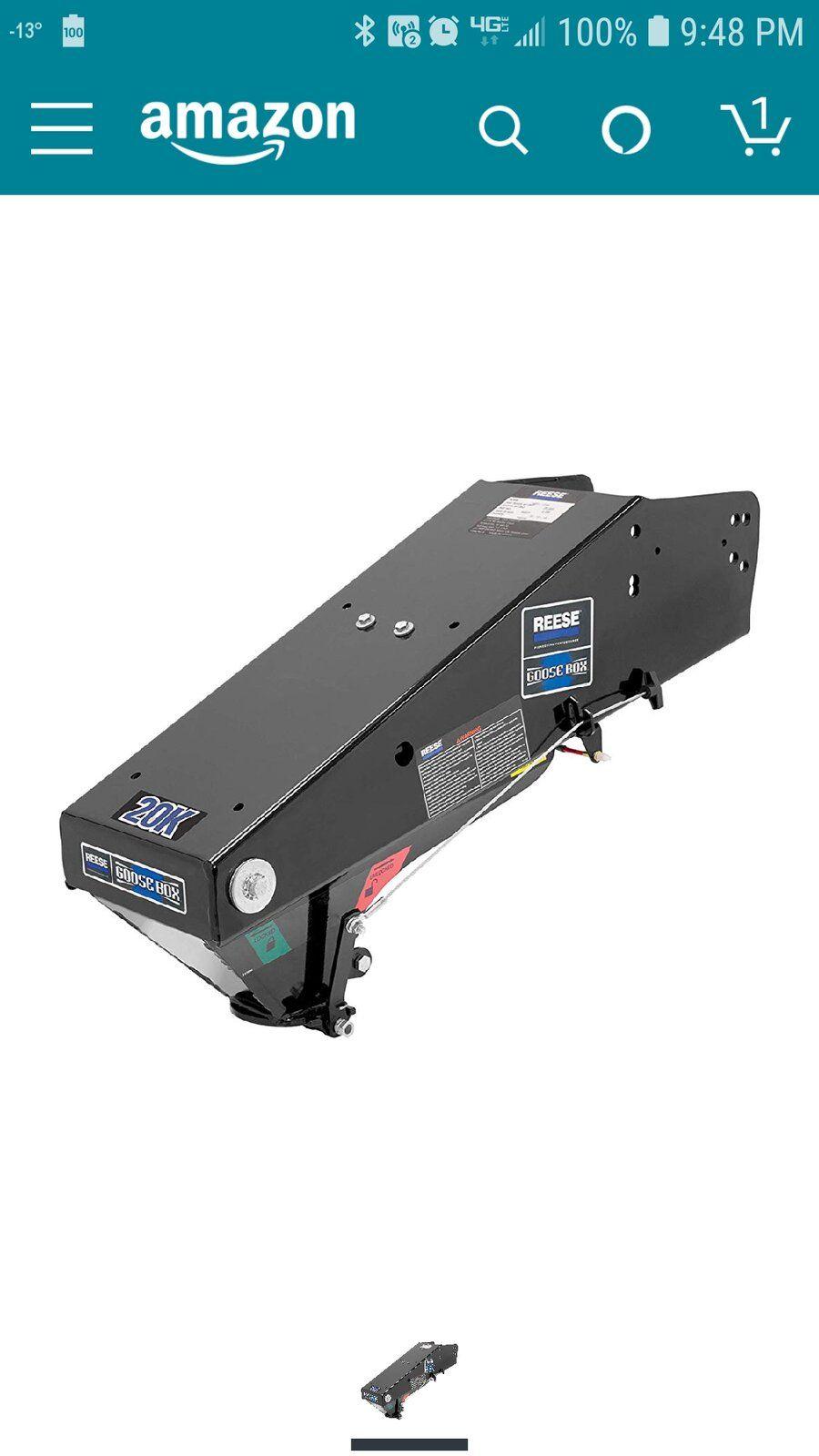

I use the Reese goosebox. I have a degenerative back, shoulders, and bad hips. The only thing I have to lift in and out of the box of my truck is a 3lb gooseneck ball. Don't have to change hitches when towing gooseneck trailers.
The only downside is you have to be a little more precise getting over the ball. Third brake light bed camera works great for this.

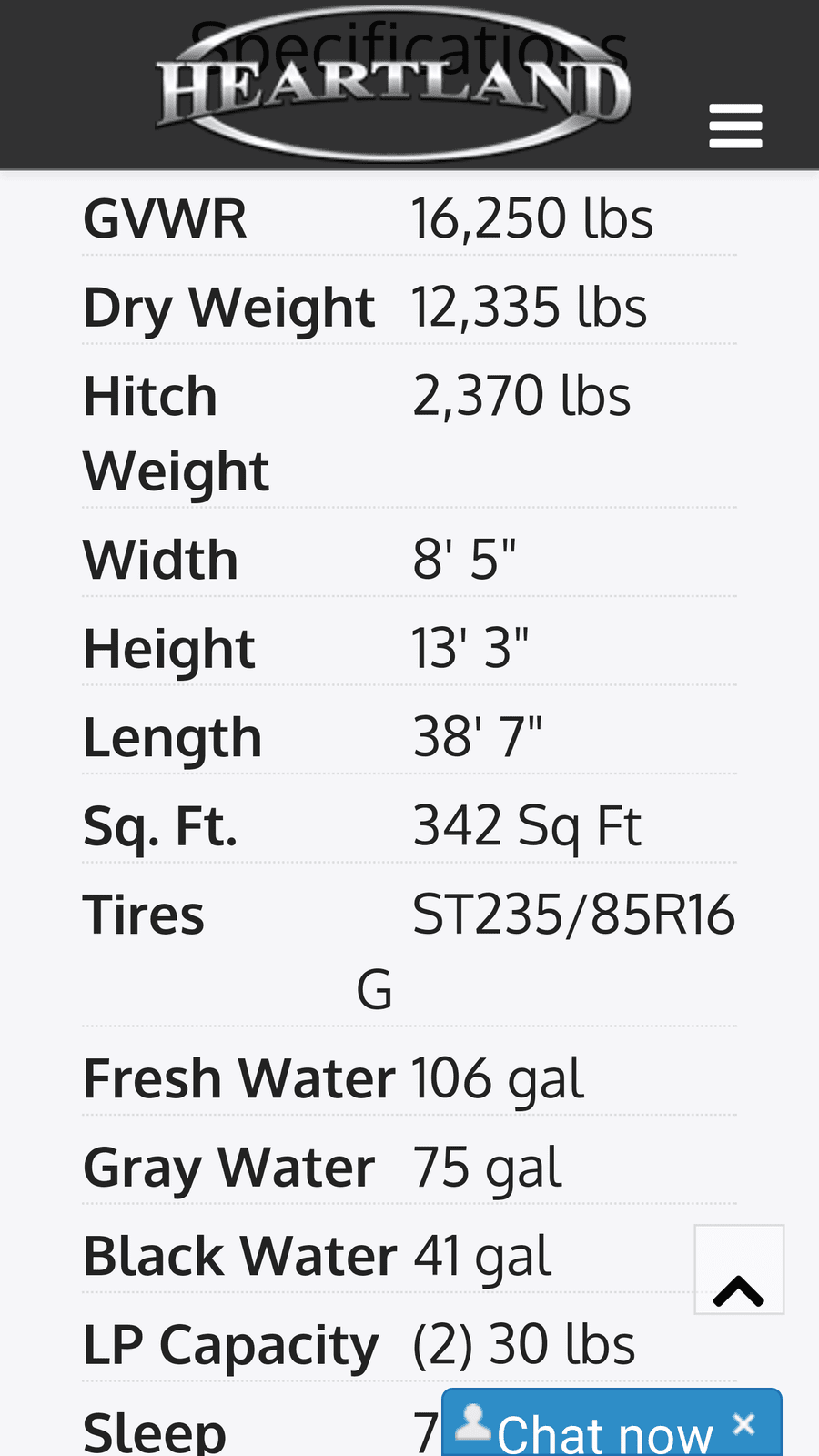

2 years and approximately 8,000 miles. Have not noticed or see any adverse effects on trailer or frame area where it connects to the pin box. I'll post the specs of my toyhauler. The specs are off a bit since my toyhauler has two 45 gallon black tanks and two 45 gallon grey water tanks. I know the pin weight is more than 2300lbs too. How much more, don't know. Two grey and one black tank sit in front of trailer axles and one black tank behind. The fresh water tank also sits in front of axles. I hardly travel with more than 1/2 a tank of fresh water and always if possible drain black and grey tanks before traveling.
