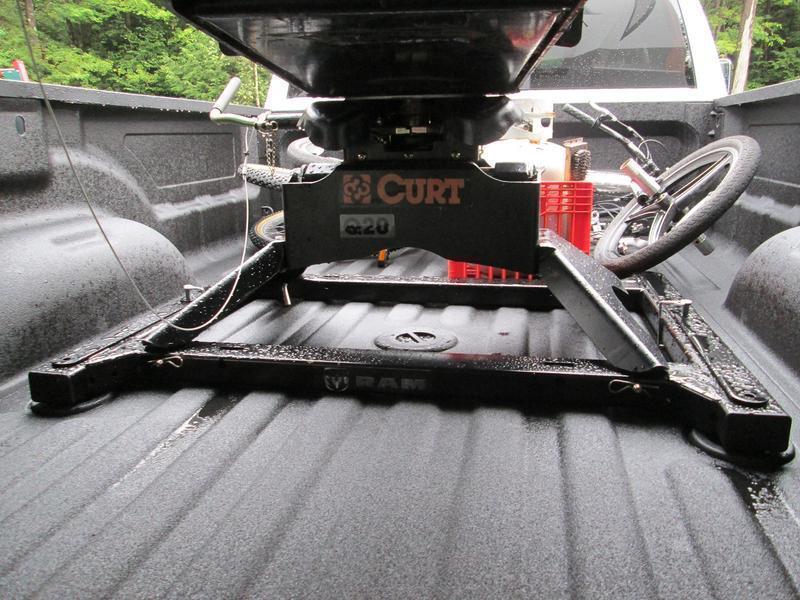

ETurner, I have a 5'er with no pin adjustment and 4x4. The regular rails are all of an inch so I don't think you will see much difference with the picture frame. Here it is in my truck-

UpstateNYoilburner,how does the picture frame bracket mount to the bed?
At each corner of the picture frame there is a pin that extends down into each of the holes in the bed. Once they have gone through, the bars on the sides turn 90 degrees onto the rail and lock the pins to the truck. You then lock those bars into place with a pin (as seen in the photo midway up on the sides of the picture frame) so that the pins underneath don't unlock.
I just spent a half hour adjusting the height of the locking pins as my dealer totally screwed them up, shearing 3 out of 4 cotter pins right off so there was nothing really stopping it from popping right off as the front two pins did the last time i unloaded. If I sound a little ****** off, I am. If I were ordering a truck right now, I would not order this option. I think it is a poorly designed system and an aftermarket B&W would be cheaper and better for a fifth wheel application.
