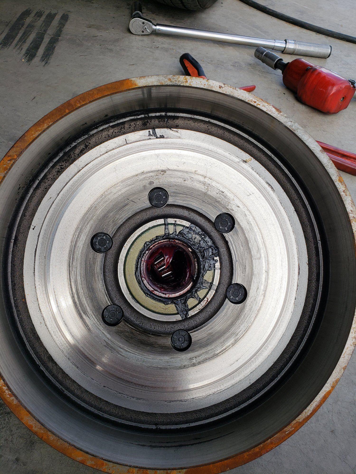

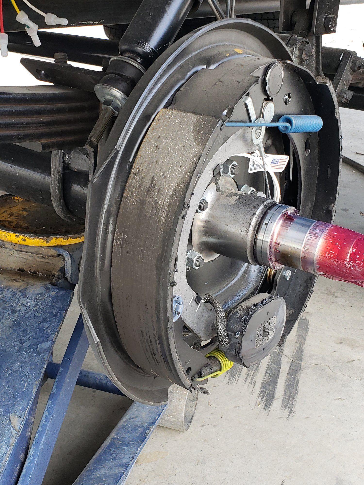

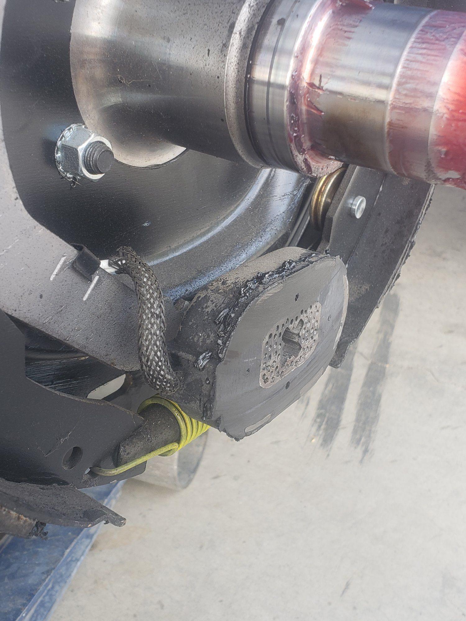

The Never Lube system seems a lot better than the EZ lube-which in fact you may not even have to apply a grease gun yourself to experience a failure! We just bought a brand new 5th wheel trailer, drove about 1100 miles, heavy electric setting with gain at 10 and brakes didn't seem that great compared to my old trailer. I just chalked it up to "break in" period, which was partly true. But when we got to our destination I ran it over to the shop and had the tech remove hubs (Dexter EZ lube) to check. He was skeptical that I needed to continue checking them after the first one on passenger side looked OK, second one passenger side looked OK, but the the first one drivers side HAD GREASE ALL OVER THE PLACE that had extruded past the bearing seal. The seal was not cocked or apparently defective and I discussed with both the dealer we purchased from as well as the trailer factory and they both advised that NO GREASE IS ADDED (and why would they?). So the overgreasing is happening AT THE DEXTER FACTORY. Now if they can't even grease their own hubs correctly how in the world would the average DIY guy be expected to? To Dexters credit, their warranty service was prompt and excellent and they are shipping parts to my local shop and paying the labor to completely change out the two drivers side hub/drum/backing plate/magnet assemblies. Personally I would never use the EZ lube zerks and I might just remove them and plug the holes when it's all fixed. You really have no idea how much grease is going in or where it is going. A friend of mine recently bought a 5th wheel, 2018 model year with the same EZ lube setup and both of his drivers side brakes were all greased up too. In his case it is POSSIBLE that someone added grease at some point but not very likely. It was only driven between factory and dealers, essentially a new trailer, no one had ever taken it camping yet.
If you are buying a trailer with the EZ lube system better safe than sorry-either stick a borescope in there and have a look or pull the hubs off and check for grease. Cheap and easy. I think Dexter makes rock solid axle assemblies and I put Dexter hubs on my old trailer because I like their forward adjusting system. Like I said, their warranty service was excellent. I just think the design/engineering of the EZ lube system is not robust and I plant to check and hand pack yearly and replace seals at that time. Cheap maintenance for peace of mind. Just thinking about these guys who have posted about pumping in a whole tube of grease thru the Zerks makes me shudder.
