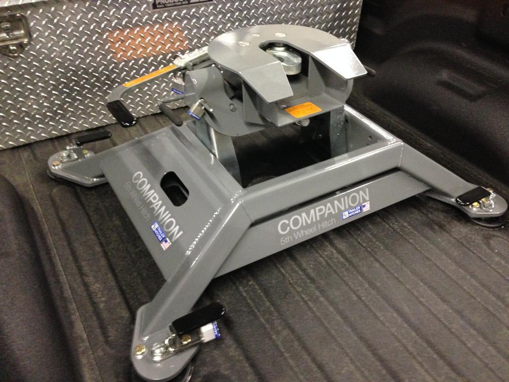

Get the prep or add the pucks later, sell your hitch and add this. You will thank me!
