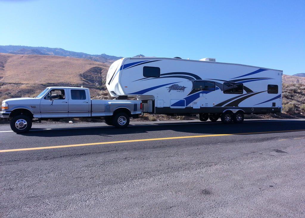

We tow a 5'er toyhauler that is in your ballpark for specs. The pic below was taken with my old truck, we haven't towed with the Dodge yet but will soon.

Here is a pic of the old truck with the new RV on it's maiden voyage.
