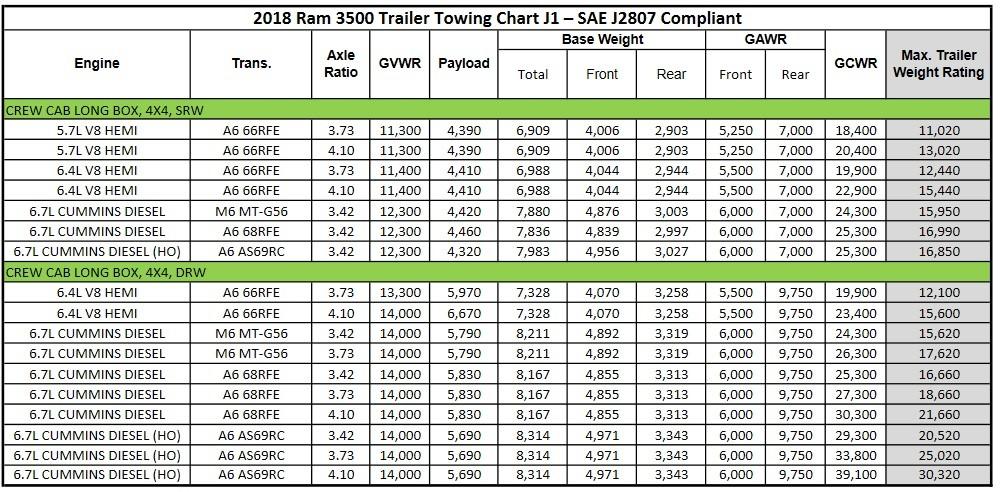

DRW vs. SRW example is 10,000 more trailer and another 5000 lbs with the 4.10. This is reaching over CDL territory.
https://www.ramtrucks.com/content/dam/fca-brands/na/ramtrucks/en_us/towing/2018 Ram 3500.pdf

The Daily Driver use of the truck would make life with a DRW harder: snow/ice traction and parking for example. I recommend the factory air suspension as a DRW with it rides nicer than my SRW without air. YMMV but here is a 2018 model year.
Again the RV he is looking at is only 500 LBS over mine. My 2003 was short 500 lbs for the max GVWR of my 5th wheel. My 2018 can tow 16,850. Both SRW.
