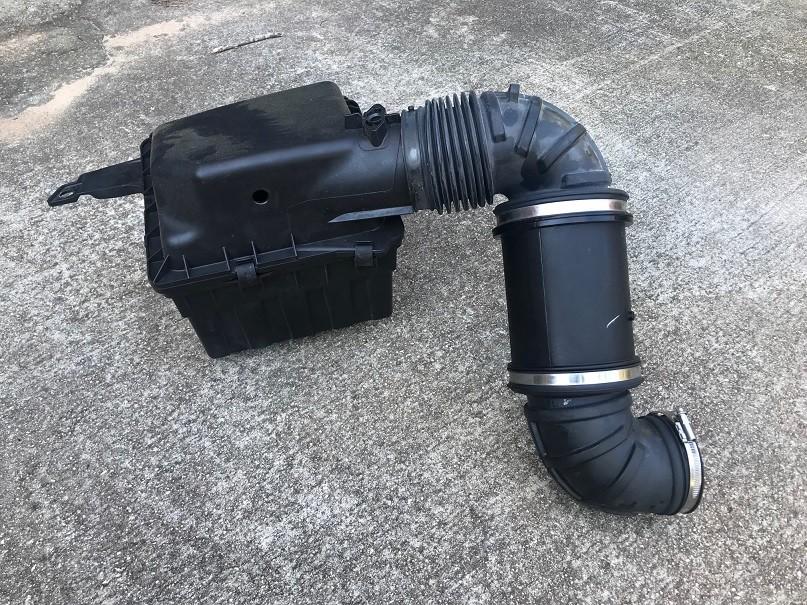

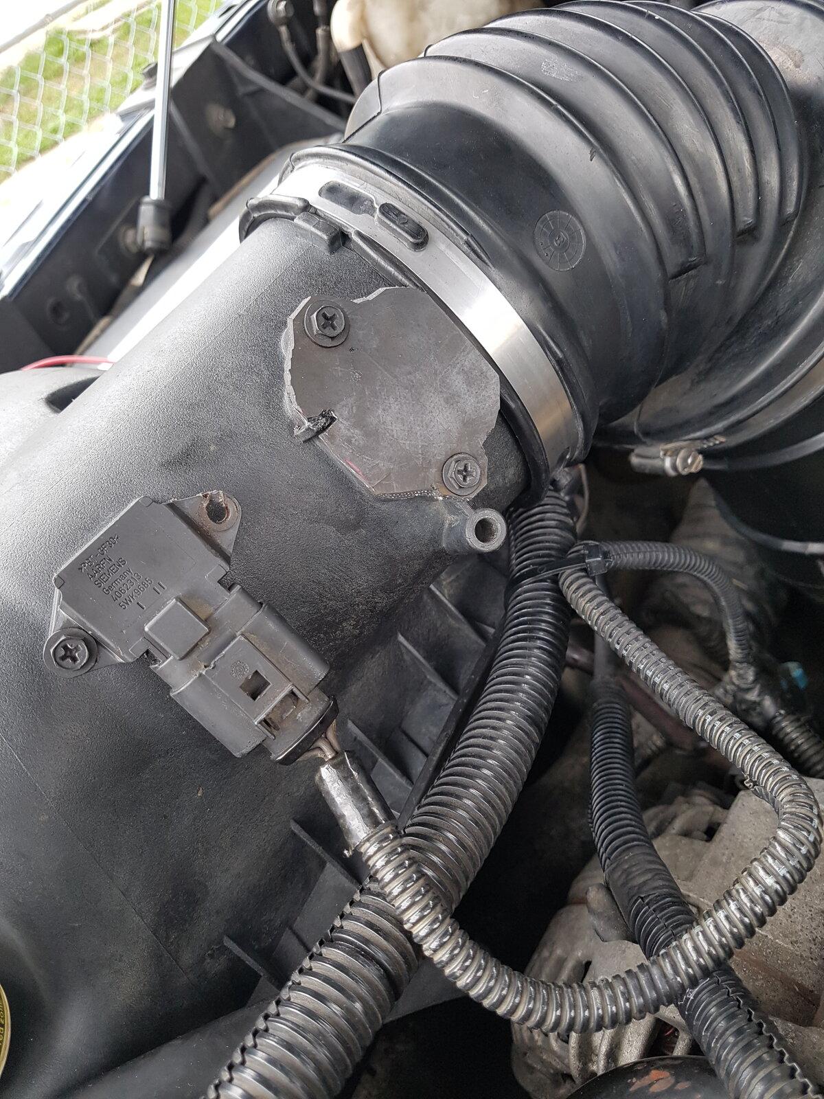

i have an 06 with a crappy aftermarket air filter in it. I want to put in a stock 6.7 style. I know i need the air box and lid as well as the hose from the box to the turbo as it is bigger on the lid end. I plugged of the hose that goes up the the breather as it is not needed on the 5.9. On the 6.7 there are 2 sensors while the 5.9 only has one. I plugged off the small sensor hole but my Mass Air Flow sensor is way too small for the hole in the 6.7 air box lid.
Has anyone done this before? if I go and buy a 6.7 sensor will it work with my 5.9 wiring?
Because I know someone is going to ask WHY did i do this I'll answer it now. There is a deep 5.9 filter but it is not common and as easy to get as the 6.7 one is. Besides I had a 6.7 set up and didn't have a stock 5.9 one.

There isn’t a mass airflow sensor at all on the 5.9, only the AAT (IAT) sensor. I would be very surprised if the 6.7 AAT sensor works.

Ambient Air Temp, it tells the ECM the pre-turbo temp and pressure.

I solved my problem by putting my sensor in the small hole and capping off the big hole in the air filter lid. I did this on my 03 years ago and had just forgotten how I did it. Problem solved.

From a 2007 5.9L. Is this what you're looking for? Looks like its missing a clamp and the restriction gauge. It was removed very early in its life and I just happen to have it.
More pics and info possible just starting here.
