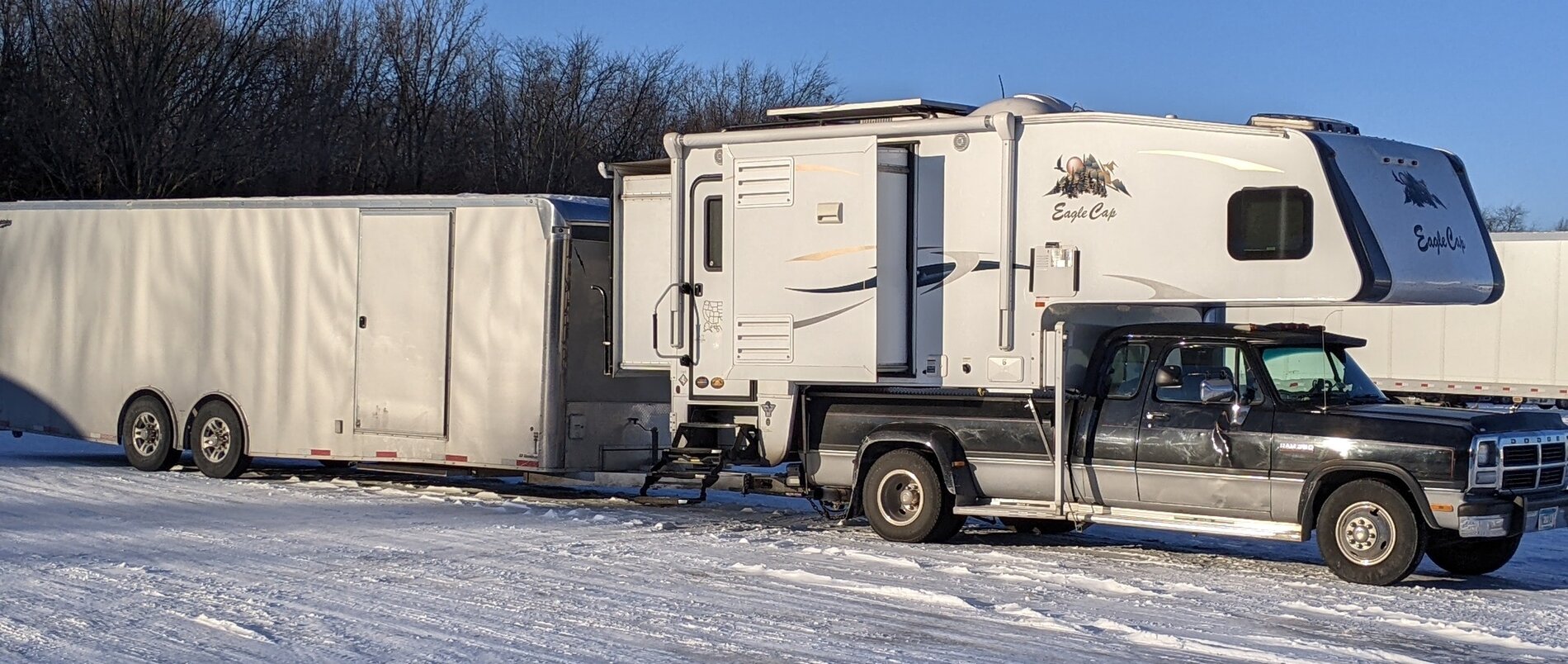

This is my current rig. The 68 Crew cab will be replacing it. So you can see how it is loaded with the 6,000 lb camper, plus the race trailer.

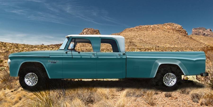

I want to switch from a club cab to a full crew cab. And I like the styling of the 68 crew cab better than the 80s / 90s. Once the new truck is ready, the old truck will be for sale.

Now that's a B pillar!!!!!!!
