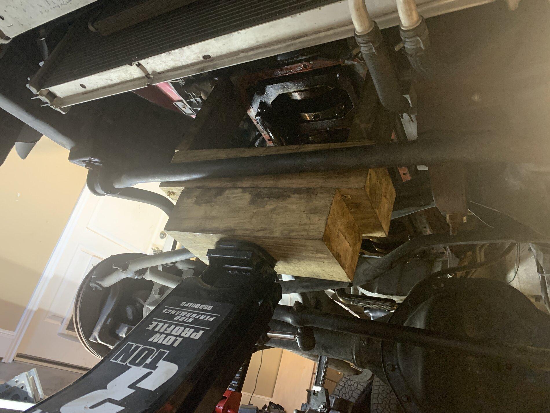

Yes loosen the transmission mounts but don't take them off. Put a heavy duty jack on the harmonic balancer and I would suggest you use some 2x4s first and jack the motor up a little bit. Then take the motor mount bolts off and jack the motor up 6 inches. You will have to move all the wiring harness by the firewall up out of the way by taking all the clips off. The big wiring harness plug on the drivers side by the firewall must be moved also or the engine will not go up enough. The air intake must come off also and batteries disconnected for safety. After you drain all the oil loosen all the bolts and drop the pan as much as possible and reach in and there are 4 bolts that need to come off to drop the oil pickup tube then you can wiggle the pan out. It's a pain but I did it. It takes about 4-6 hours because I took my time and had a friend help me. Also I recommend good jack stands to hold the front end up. Just take your time and jack the motor up as much as possible it will go up 6 inches even if it doesn't look like it can. Oh also the 4 bolts holding the fan shroud have to come off so the fan can go up with the motor. I suggest painting the oil pan with about 3-4 coats of krylon rust pain so that it doesnt rust. Mine was rusted thats why I changed mine on my 08 Dually .
I had a piece of would with a half circle cut in it. It didn't hurt the harmonic balancer.

I really didn't think you would ever damage the harmonic balancer, but concentrating that much weight on the crankshaft doesn't seem like the best approach. My luck, I'd discover an oil leak from the front seal a month later.

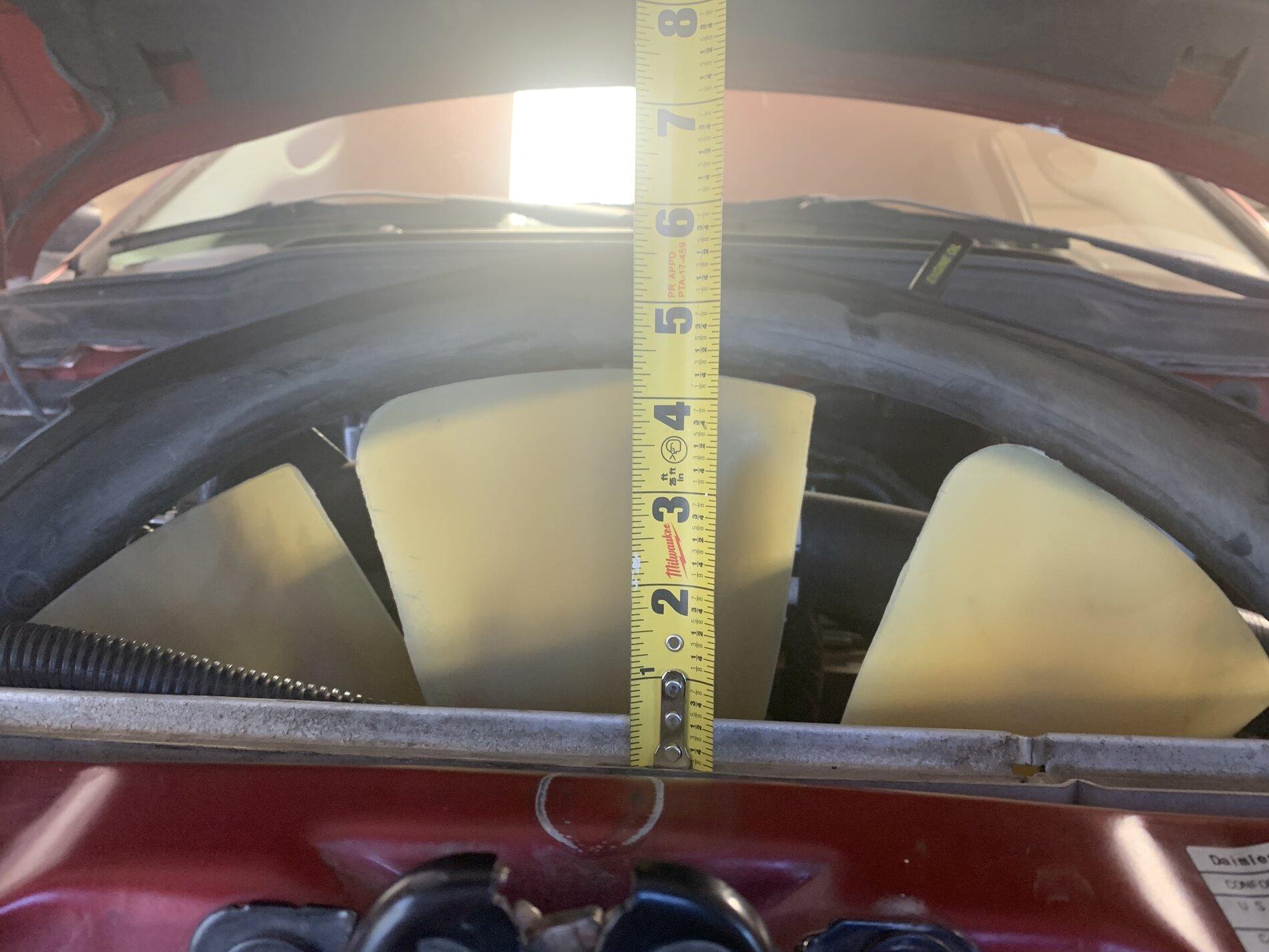

my 08 was a PITA. I had the trans off for other reasons and tried to do the pan but it would clear the pickup. Since I didn't have a engine hoist, I couldn't really jack it up without the trans hooked up for stability. I found it easier to put the trans back on (3rd leg), then loosen the mounts and lift it form the front. I would not do this again, pretty risky, next time I will secure an engine house and do it the right way.

Thats how high it needed to be to clear the trans and oil pickup tube.
