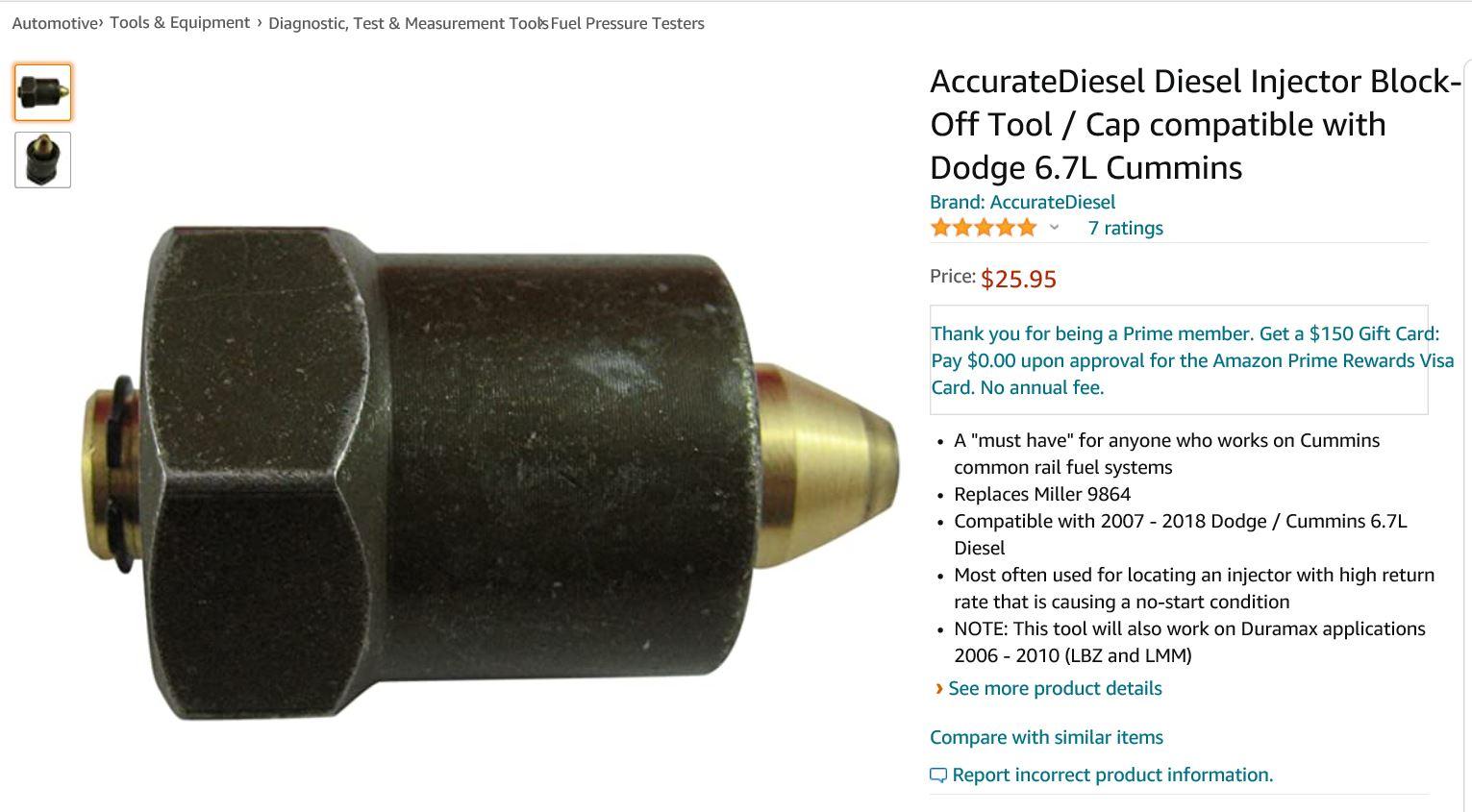

My experience is limited with common rail engines, but this part of your symptoms sounds like it could be an injector leaking fuel into a cylinder continuously - especially the "dieseling" sound with heavy black smoke. An inexpensive way to isolate each injector would be to use a block-off tool that allows you to run the engine while blocking off fuel to one cylinder at a time.
Have you checked engine oil for fuel dilution?

Yes, oil is fine and its not a stuck injector, check that yesterday.
