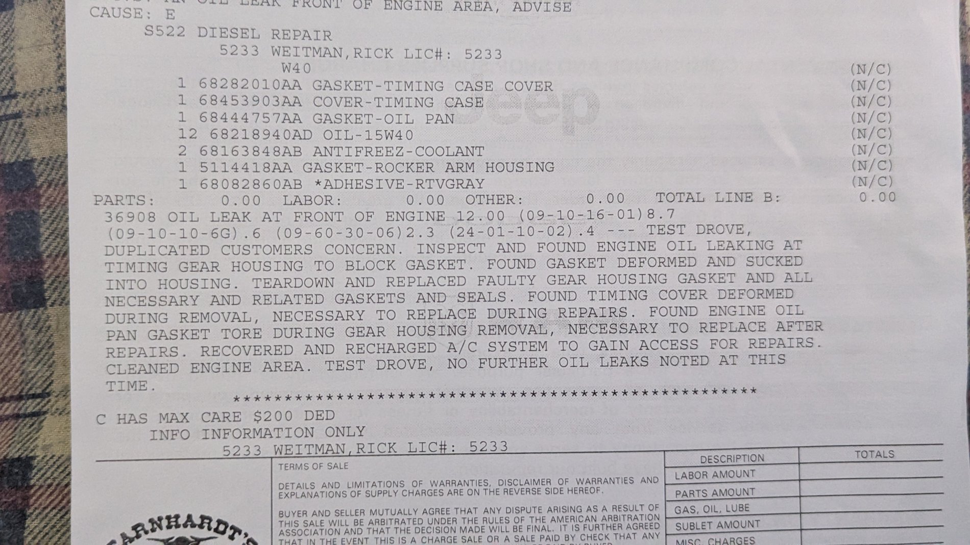

Be prepared for the fact you might need a new cover or other work. I had a leak on mine around 17K miles and the dealer wound up putting and new inner cover under warranty.
