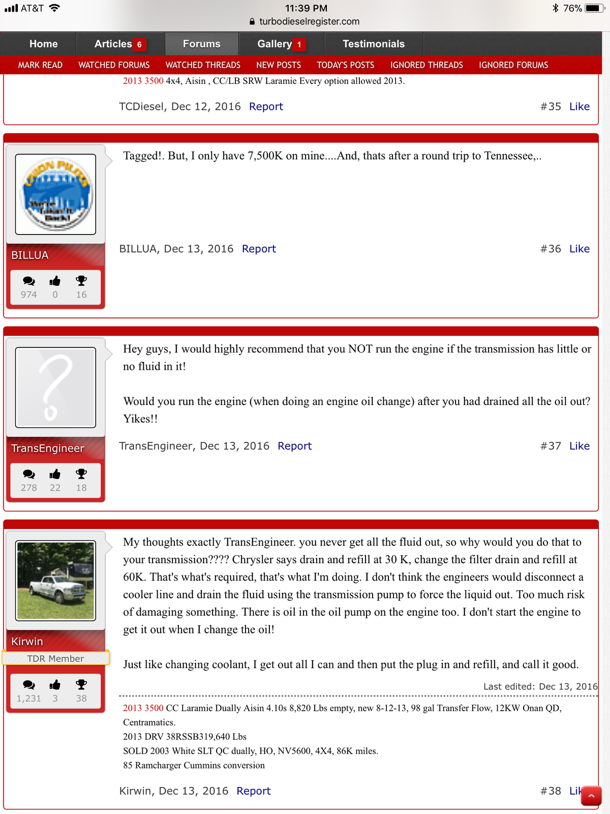

Didn't Transengineer recommend against draining it like that?
You mean here?
