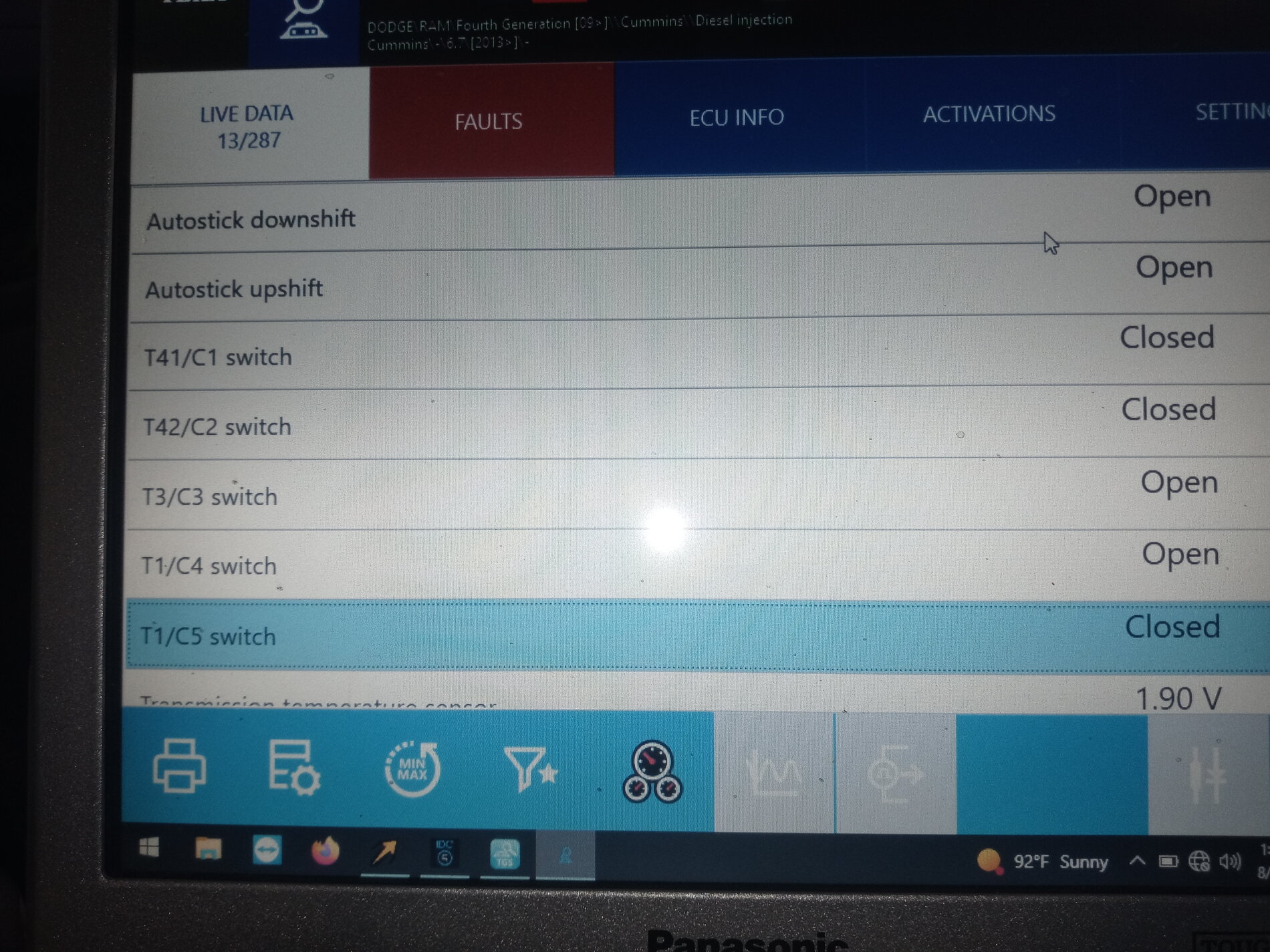

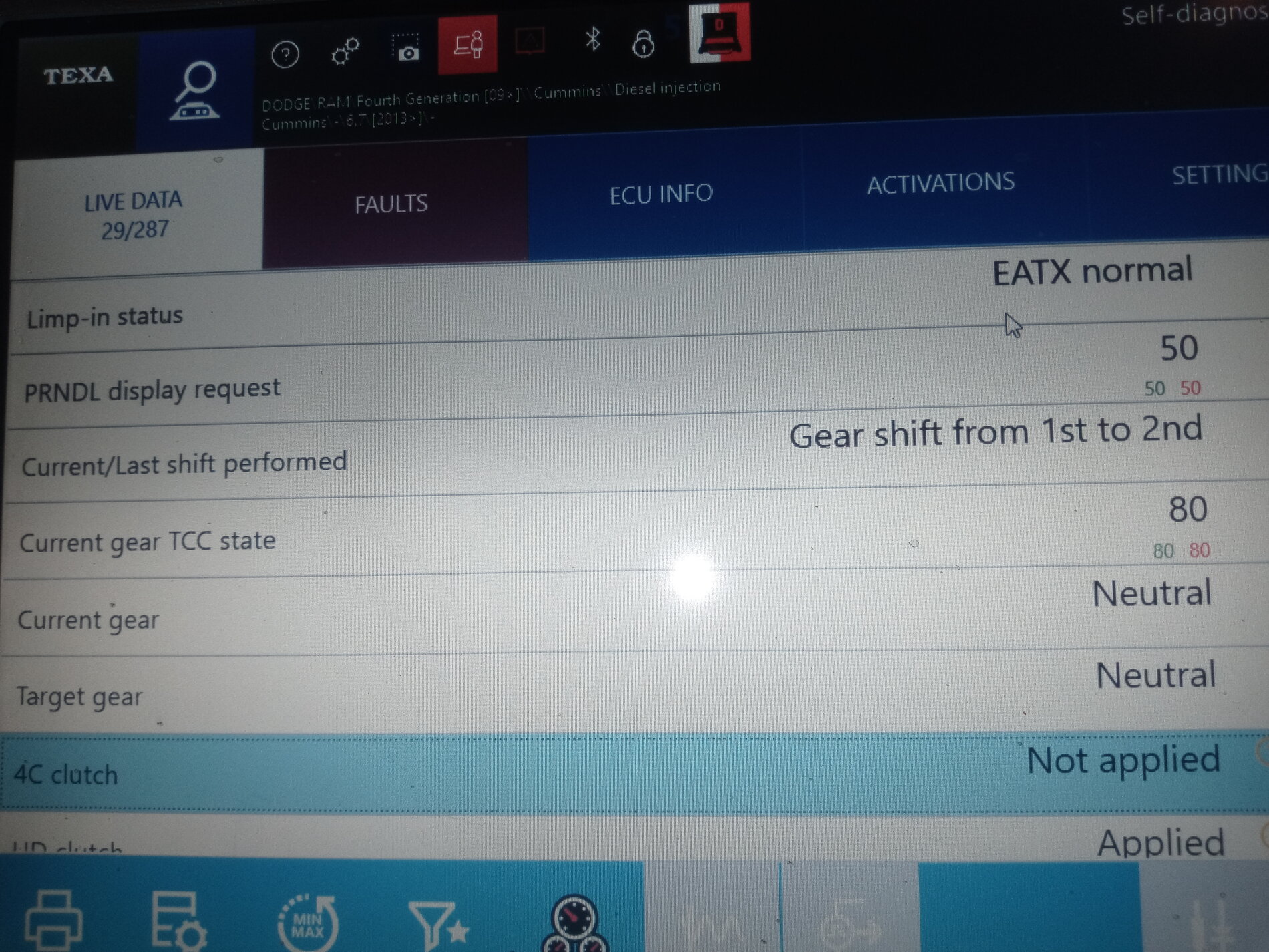

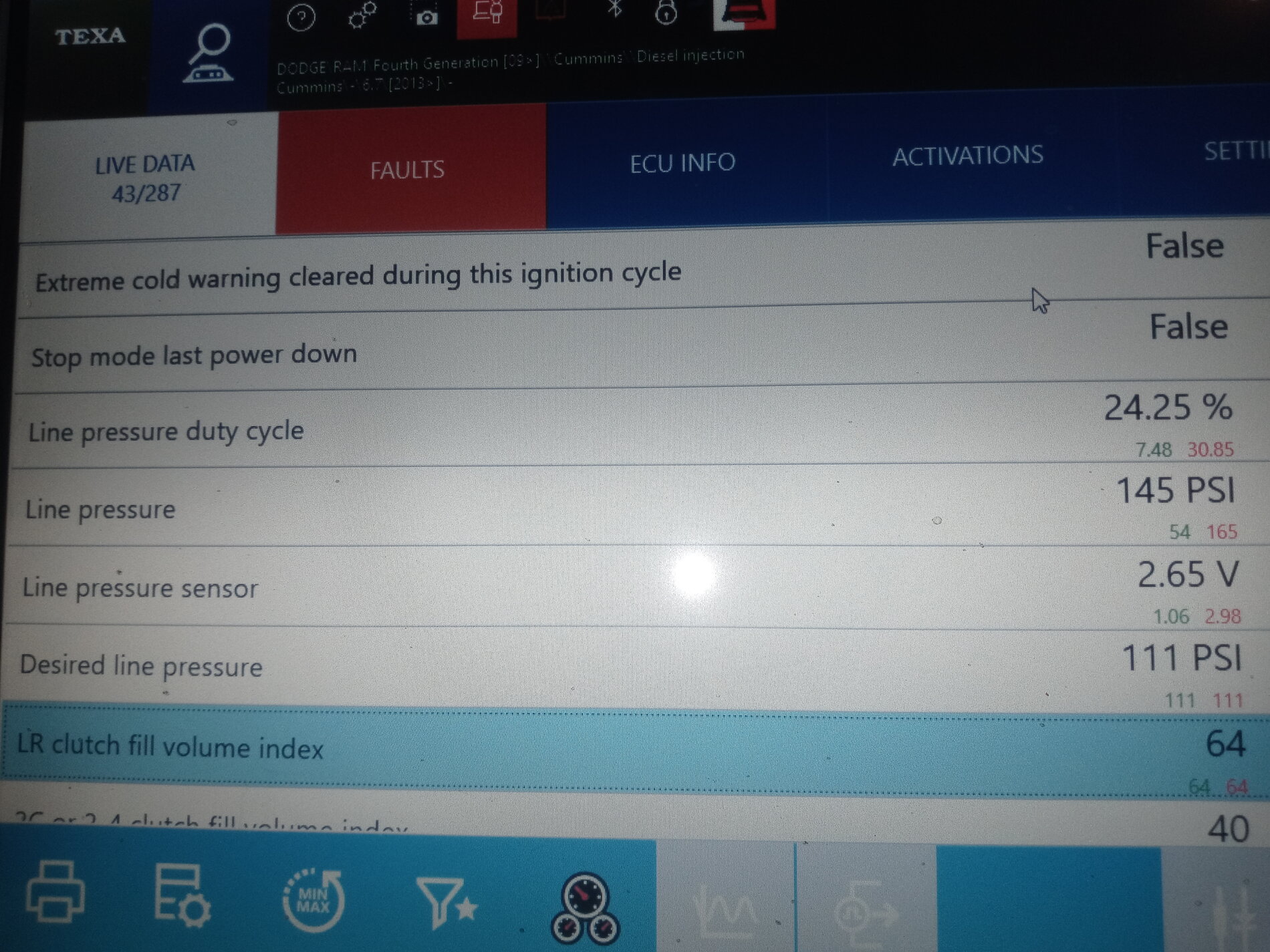

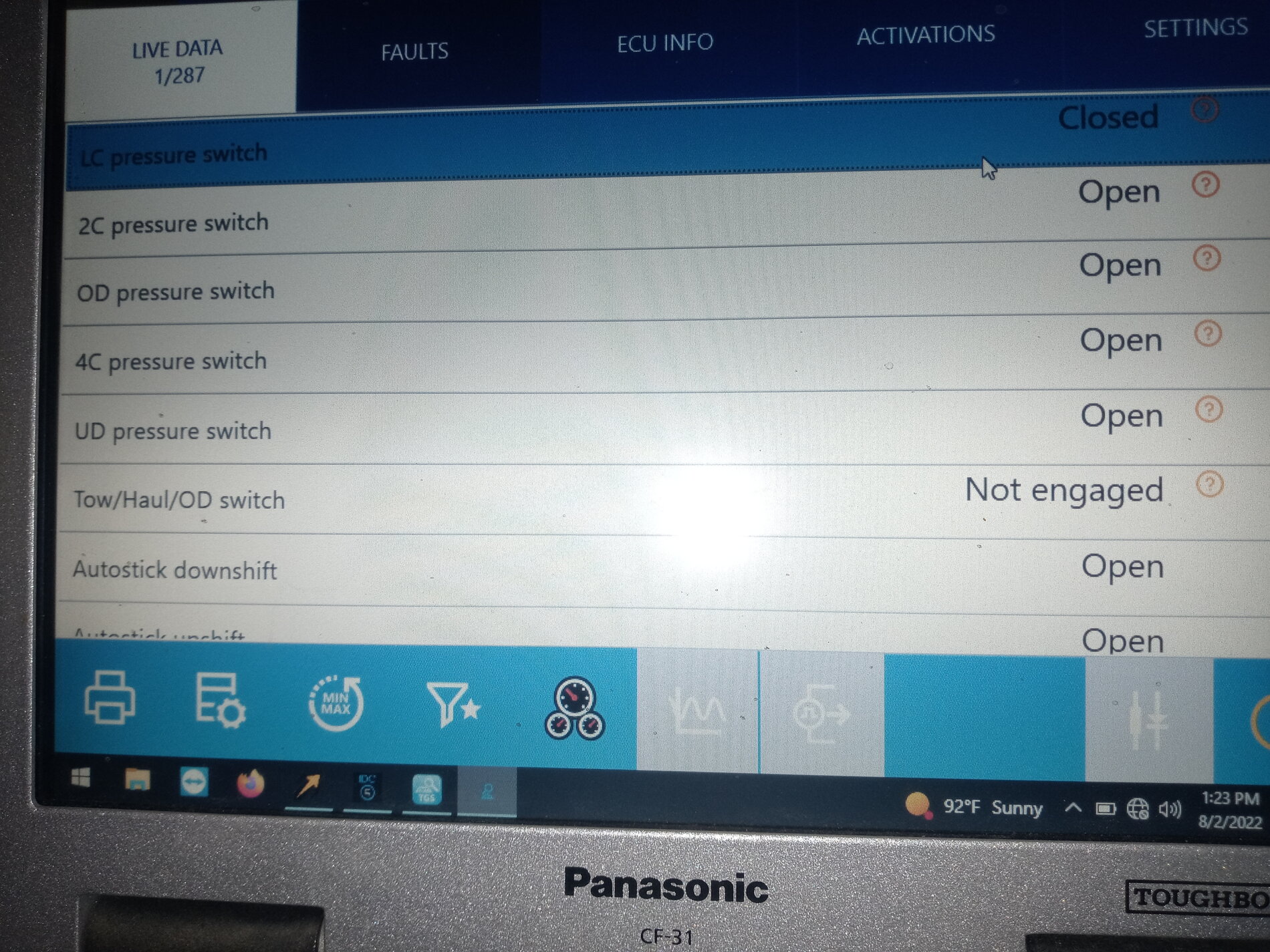

Has anyone used Texa software for diagnostics on the 68rfe ?? I have a 2016 4x4 that is throwing line pressure out of range low, line pressure out of range high. My valve body was changed out 10k ago with a revmax and also did the valve block on the lines as well as the metal spin on filter nipple. Truck was good up until Saturday when i had to hammer down to hit the free way on ramp quickly. I did some thread searching and did the normal recommend things. Dropped the pan. Checked filters. Went ahead and replaced with mopar filters per countless thread suggestions. Replaced the line pressure sensor and pig tail. Cleared the codes and all seemed ok. Yesterday day when I came to a stop sign the check engine light came on. Same two codes. High and low line pressure range. I have Texa software that also will do obd2 and allows me access to the transmission data for this truck. I can see pressure sensor voltage. Its jumping all over from 1.3 volts to 3.6 volts in park. Line pressure is doing the same. It drops to 50 then 112 then back all in the range of that. Desired line pressure says 111. I don't know if the texa is somewhat different ?? The threads I have been looking over have a lot of varied numbers on line pressure. Its changing so fast on the screen its all over. Suspect maybe wiring ?? Kinda odd ID just happened all the sudden. Truck has 170k on it with a mm3 tuner with tune for delete. 35 inch tires wich I hear is to big on stock gears. I just don't know how to interpret the texa data compared to other postings. Terminology is kinda different other than line pressure. Anyone else have texa experience that might now ??
