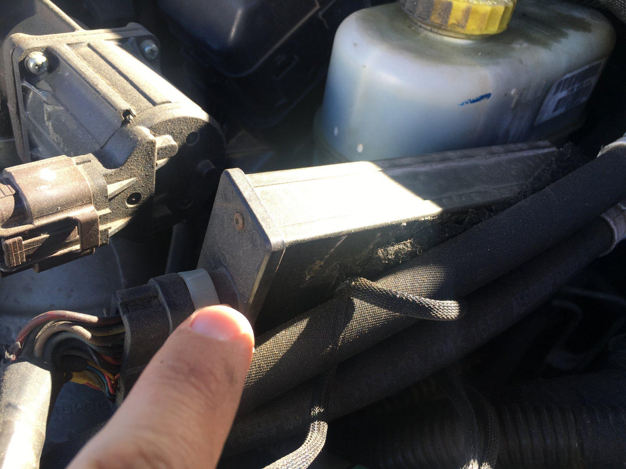

Need advice on EGR reinstallation to pass inspection

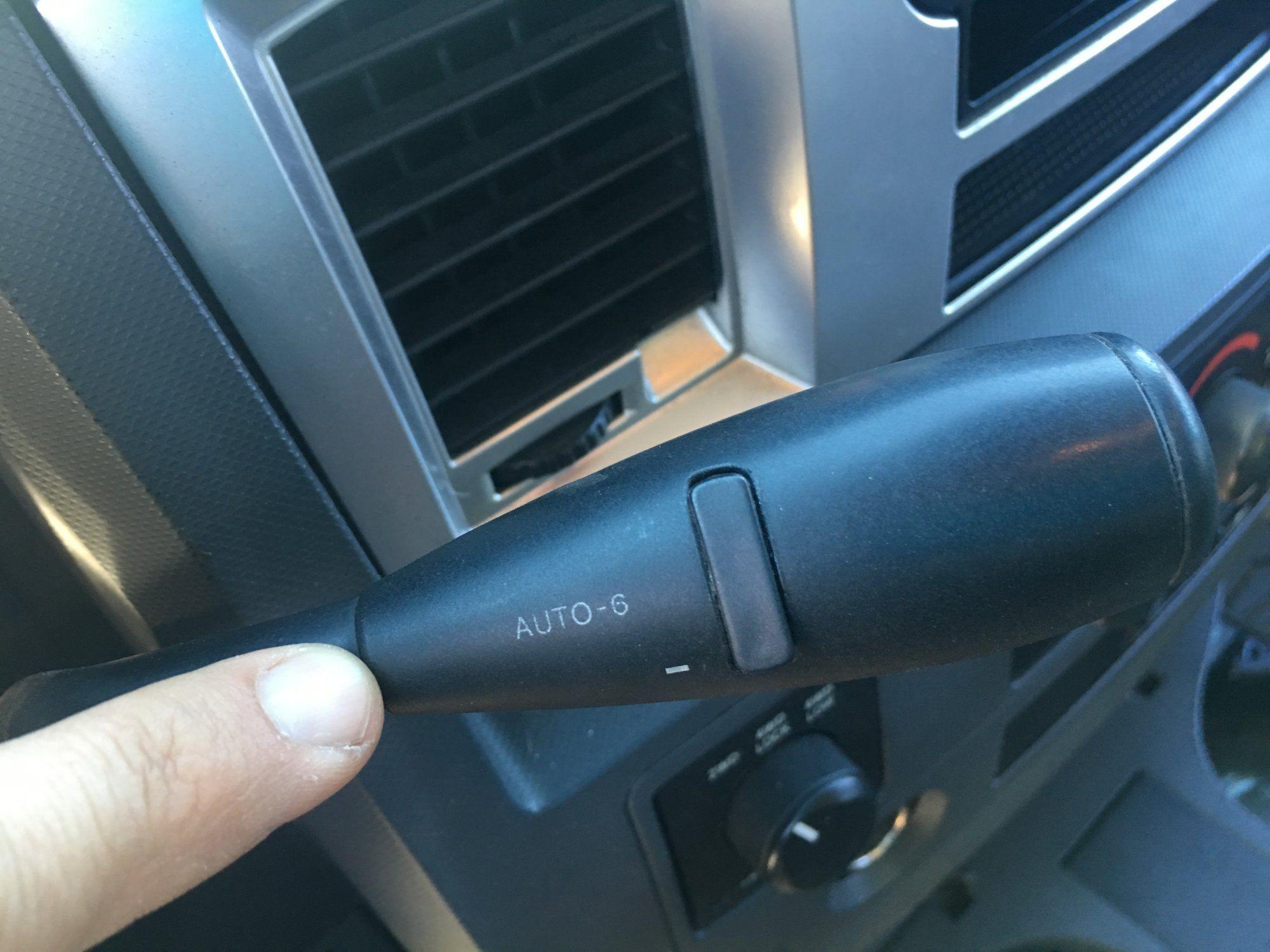

Third noticeable thing is the manual shift +/- buttons on the gear shifter do not work at all.

Fifth is a strange mixed bag also, I fiddled with the +/- button on the gear shifter and it suddenly went into 4th and would not come back out. This was especially scary when I was at a intersection with a loaded trailer. Talk about disrupting those around you with that! Some concerned motorists shared some very nice words and finger gestures with me, needless to say neither I or Big Red felt good after those incidents.

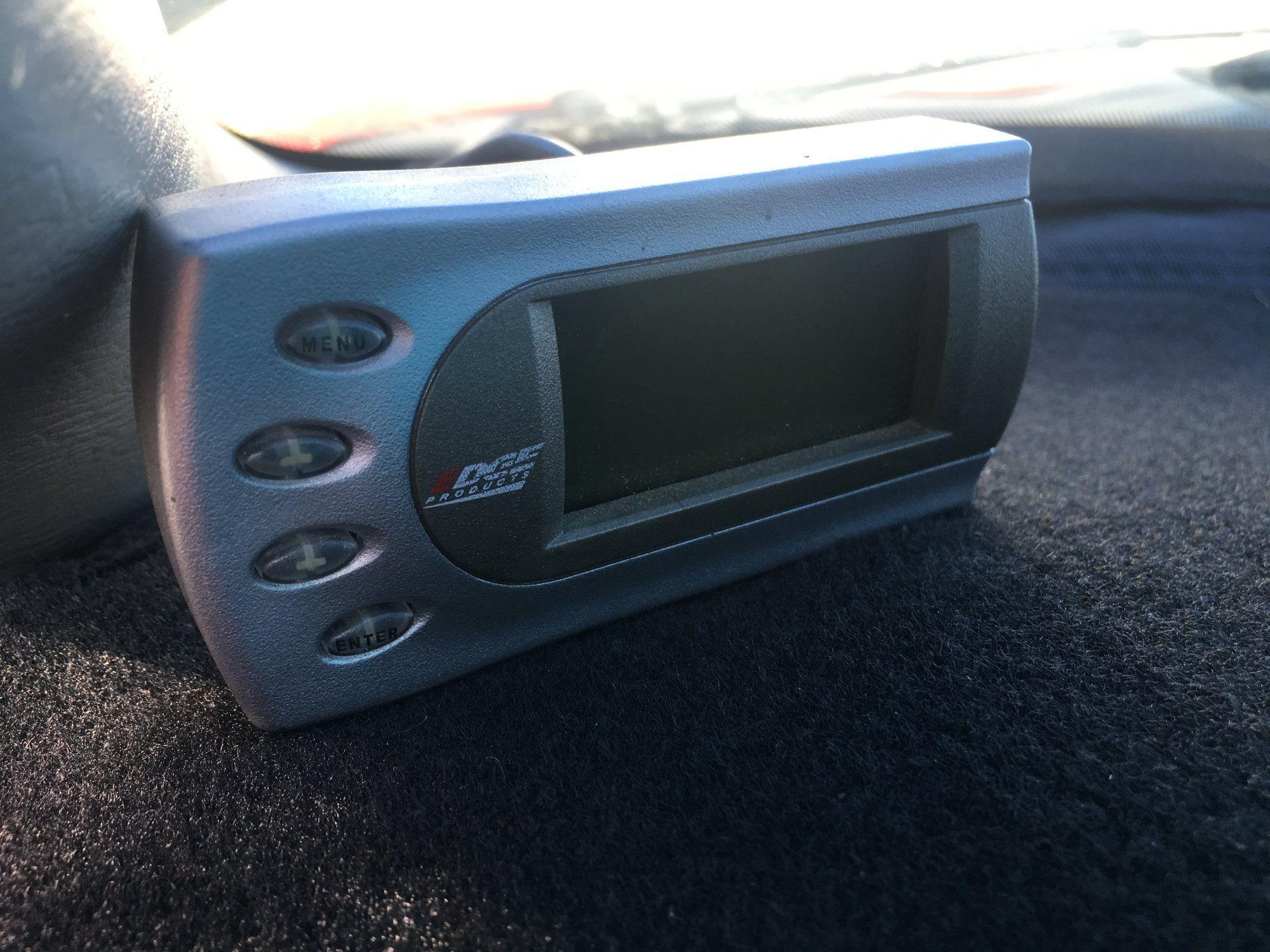

Additional Info: In her previous relationship in addition to some cosmetic surgery, her previous man got her high
on a Edge Attitude Juice Programmer, which she still has to this day. I found that the OBDII plug was not plugged in. So I plugged that in and things actually got WORSE. My trans temps started spiking. No wonder it was not plugged in, so I followed suit and let the dead dog lay. Not plugged in = normal temps. Ok strange. Also, her previous relationship liberated her of her Catalytic. Not sure if any of this is playing into the drama.
