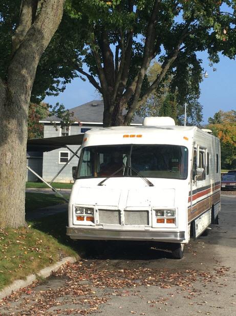

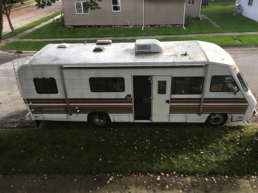

Hello gang,
I just joined the group tonight. Looking forward to chatting with all of you. I just acquired a 1985 Honey RV based on the Chevy P30 chassis for FREE. It has a 454 in it right now. It is very tired, has a dead cylinder (low compression) and runs like crap obviously. A sane person would probably send the RV to the scrap yard. Other people might rebuild the engine. Then there's me. I plan on buying a 1993 Blue Bird TC2000 in spring when the bus company decommissions it after this school year. The whole damn bus!!! It has a 6BT in it mated to an Allison AT545. 133K miles on it, so the rings are first getting seated in on the engine. Oddly enough, it does have a P Pump in it, which kinda throws me at the moment being it's a 1993 model. At the moment, I am game-planning and getting the tools I need to do this. I'm going to have questions as they pop up and hopefully tap into the knowledge contained within this group. The biggest question I have right now is whether I should use the AT545 or step up and use an MT643 instead. AT545 doesn't have a lockup converter where the MT643 does, plus it has more torque handling capability. I do plan on cranking up the HP, nothing outrageous, but I'm worried the AT545 might give up the ghost. Just wondering if there is anybody out there that might know first hand if the 545 can handle more torque than what they list it at. The only reason I'd need to keep the 545 is because there is a drive line parking brake assembly available, as where a similar option for the 643 is rarer than hen's teeth. I will need a parking brake because neither of these transmission have parking pawls. Anywho, more to come. I attached a few picks of the behemoth and the 5" side exit exhaust rendering I have planned for it....and the bus. It's going to be fairly "road kill", but probably more reliable.

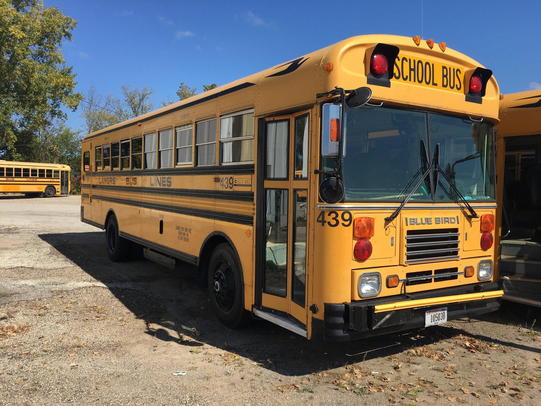

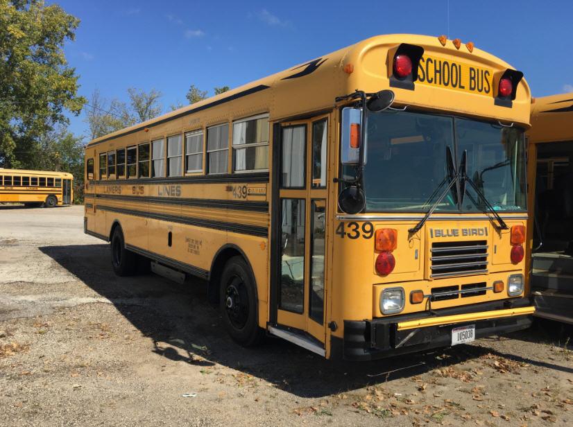

I don't know but I would be more inclined to gut the bus and tiny home that thing.
That is a really sweet bus, it's fairly impressive and unlike our buses here locally the cab over deal provides so much more room.

I've been told that a lot about converting the bus. I have my heart set on converting the RV for the following reasons: 1) lighter and shorter, 2) better fuel economy and 3) the cool factor. The bus will always be a bus and it's been done a million times. You don't see a Cummins swapped, old-ass RV very often. I'm pretty unconventional.

Like TimD32, my first thought was you are going to wrong direction. Gut the RV stuff from the MH and reuse what in reusable in the bus. Bus looks so much better that the POS MH, and the bus body will take a cool paint job much better than the MH.

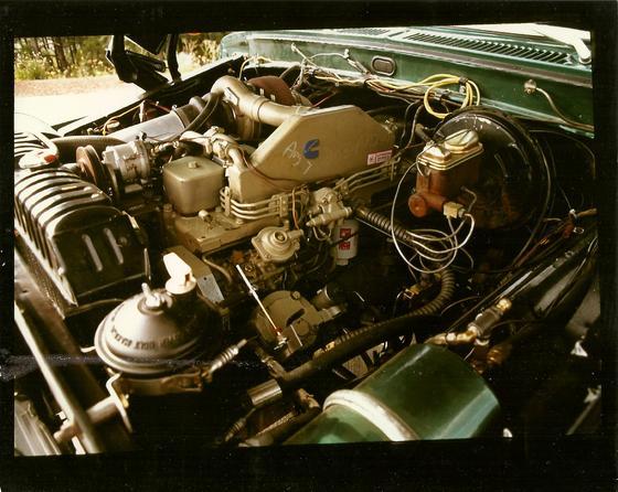

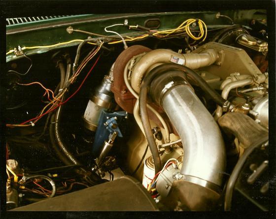

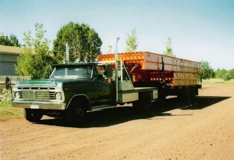

I installed a 1990 6BTA in a 1974 F-350 4x2 in 1990 that turned out nice. Then a few years later a logger friend of mine installed one in an older Dodge Motor Home, I think it had a 413. He used the early Dodge 4 spd auto, (727) maybe? He had trouble with the flexplate. He also installed a 3spd aux, 5531 I think.
